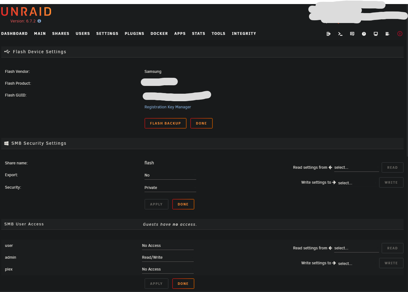

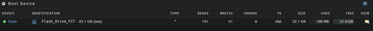

It might be worth posting a screenshot of what is shown when you click on the boot device on the Main tab as that is what the 'flash' share is mapped to.
Edited by itimpi

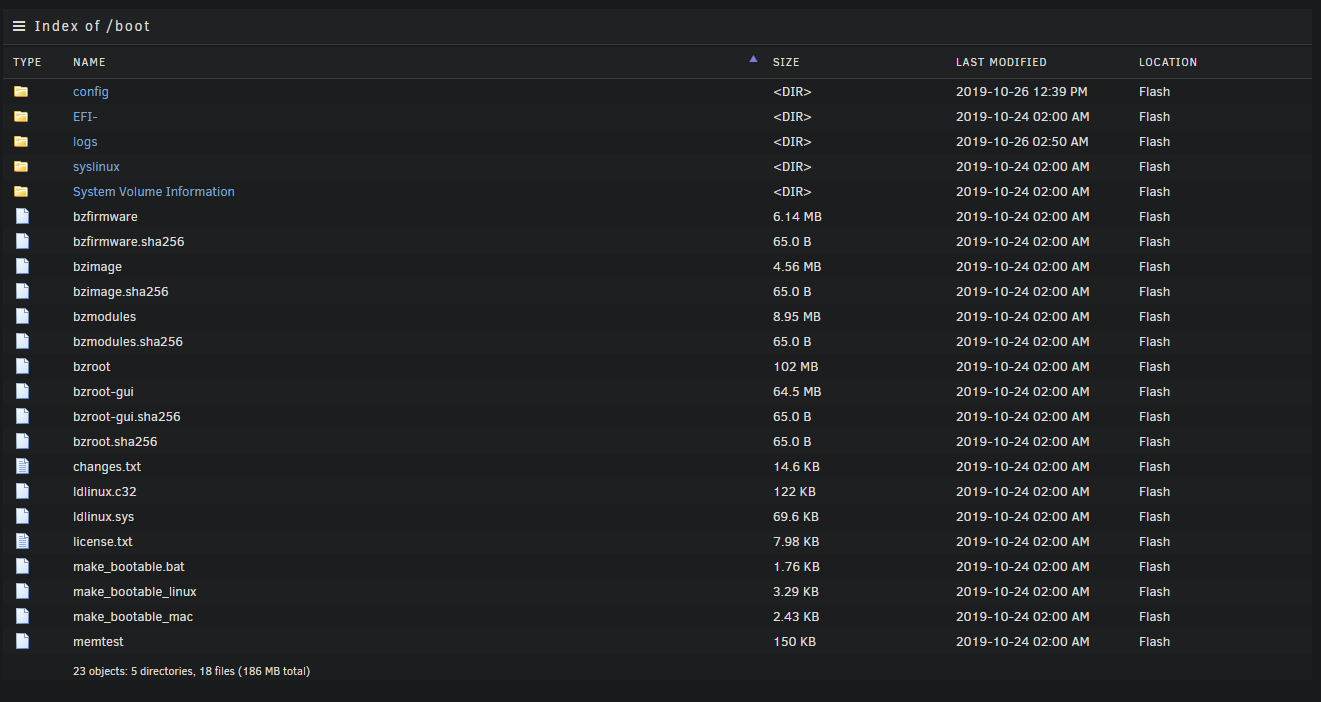

Attached screenshots of /boot as seen in Main Tab, after clicking it, and its contents visible in GUI.
So the "How?" is a little blurry because it was 3am. I thought the way i deleted the share was to tick the "delete" checkbox after clicking it in Shares.  But, it would have to be empty to see that checkbox. And I don't delete data willy-nilly, so I didn't do that. Plus the files are [obviously?] still there so... IDK,

EDIT: I see that boot is set to: export =no, I just changed it to =yes and even made it public, and it does not appear in shares.

your screenshot shows that you have set the SMB export setting to ‘no’ which means it is not shared as ‘flash’ and thus accessible over the network.     To be able to access it over the network it needs to be set to one of the Yes variants.   You may also want to make sure you have set up the security options to suit your planned needs.
I did notice that and I did enable it right after posting - still no flash share visible in Shares.

No.  It is only by clicking on the Boot device that you can currently change its visibility and security.
