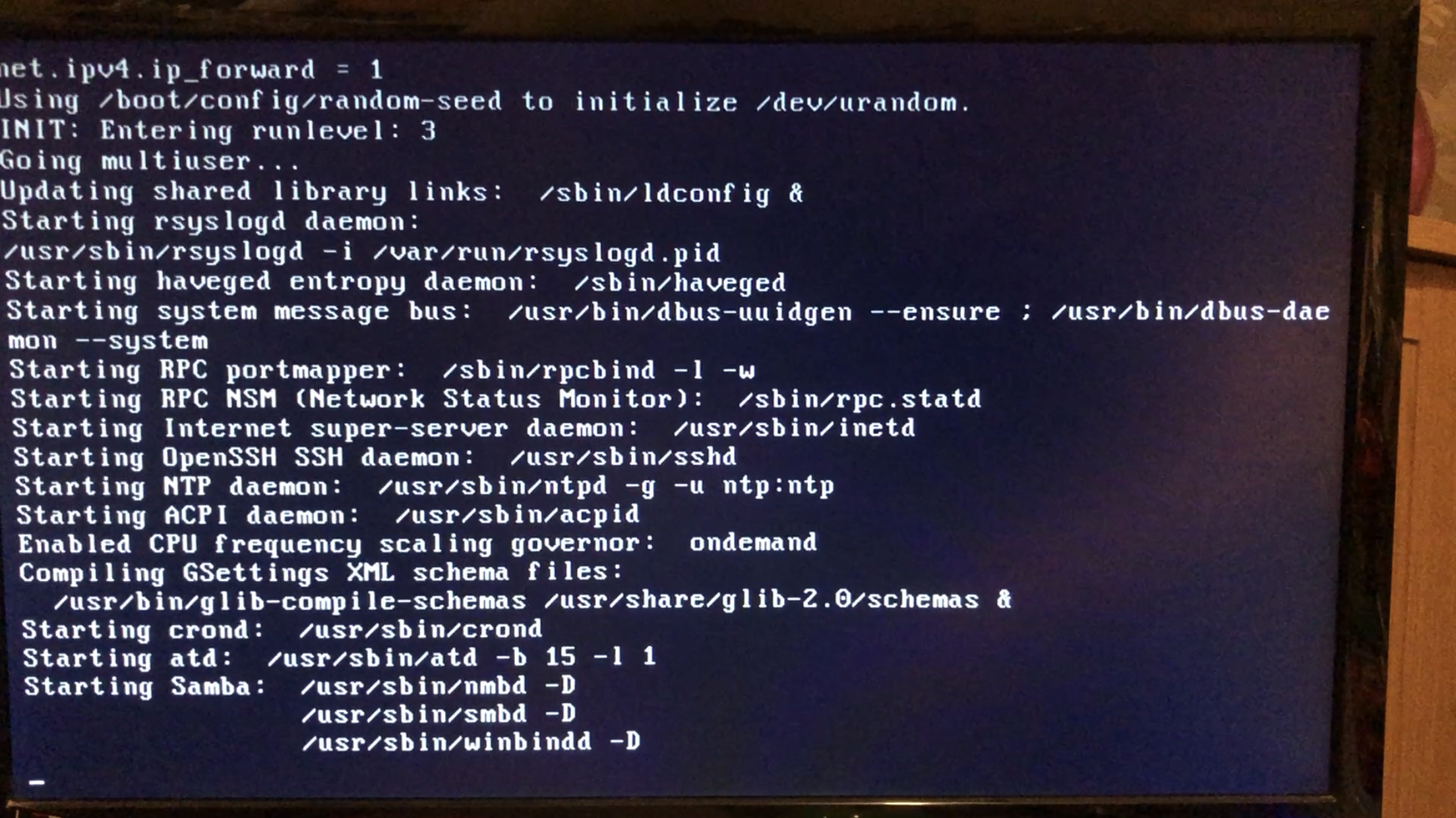

system was running fine for 3 weeks, last night it mysteriously rebooted,  and I’m not able to boot into headless Unraid. Attached is the footage of the boot up before screen goes blank and system reboots again.
very grateful for and recommendations.  Booting into safe mode with no plugins makes no difference and also no memory errors reported after running the mem test from the menu

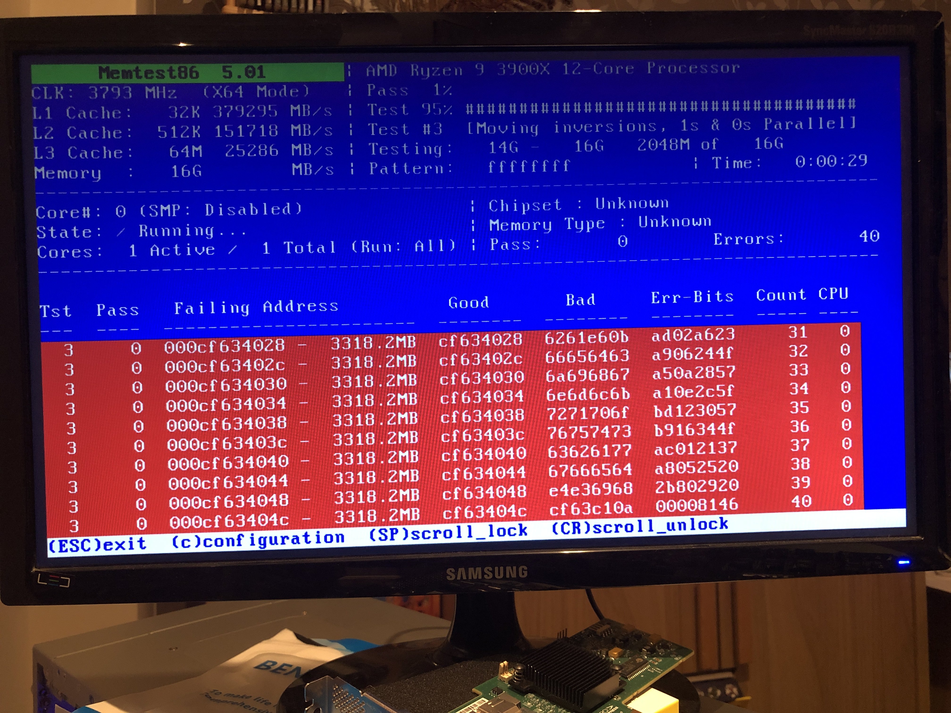

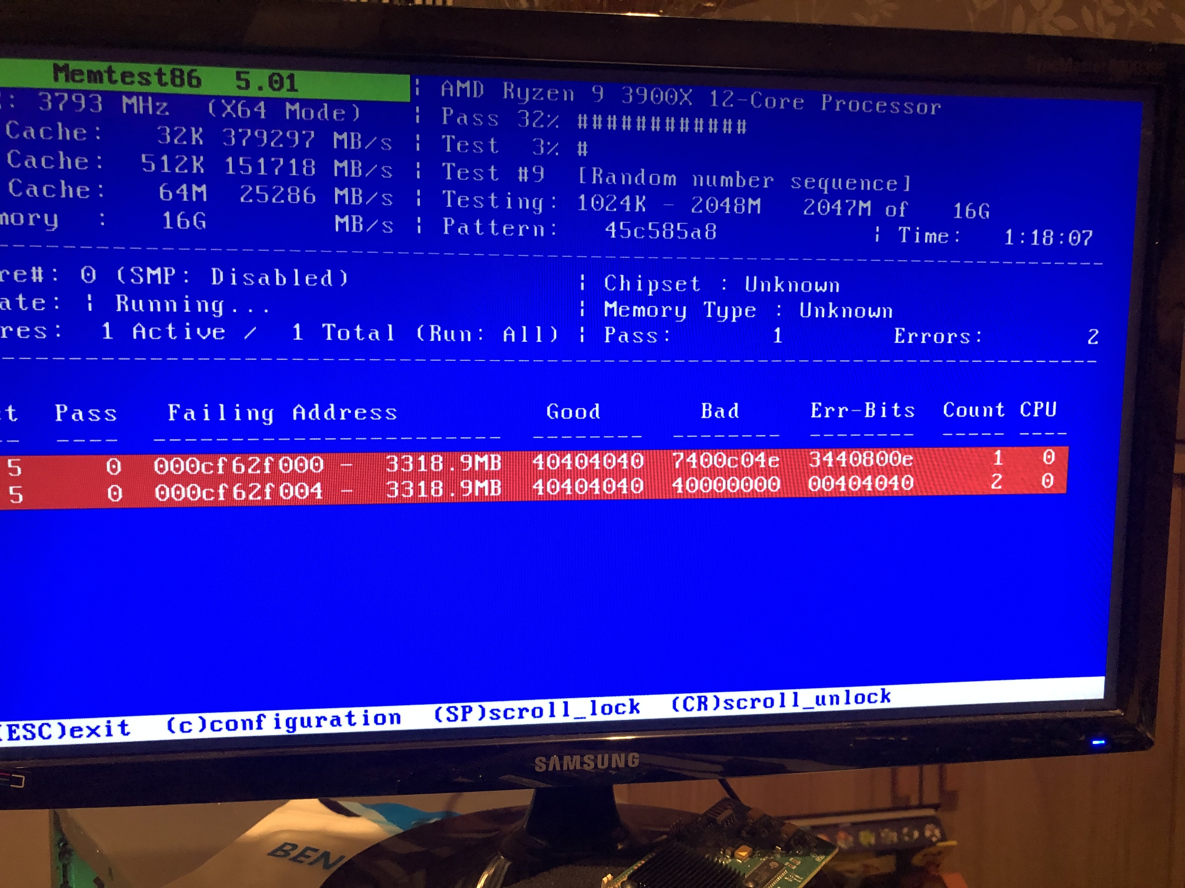

Spent a fun day playing with Bios settings and different USB sticks / versions.  Nothing is working,  but I’ve just ran the memtest83 from a clean install of the latest 6.8 RC and it’s found errors.
I’m running with ECC memory, (Crucial 2x16GB PC4-2666V-EE1 CT16G4WFD8266).  I can’t find any ECC memory reported on ASUS’s QVL list,  so I’ve ordered 2 sticks of Corsair non ECC memory arriving tomorrow from Amazon to try.
I’ll report back!

Replacing the memory fixed the problem!  Back up and running. 😁 Replaced my USB stick also as the Sandisk Cruzer plastic was slipping of the metal body after all the inserting and pulling out trying to test different config options.
New;
Corsair 163301 Vengeance LPX 32 GB (2 x 16 GB) DDR4 3200
Faulty;
