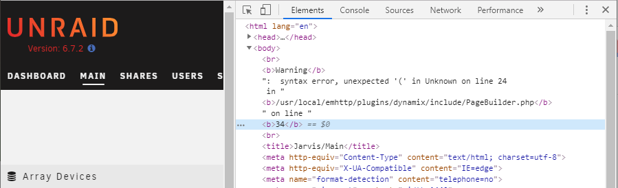

This looks like a potential issue:
Restart in safe mode.  If that continues, then it's a problem with the GUI.  If it doesn't then it's a problem with a plugin.
As @Squid already suggested, start in safe mode. This looks like a plugin messing up things.
Edited by bonienl
@Squid & @bonienl - thanks for pointing me in the right direction.
It appears rclone by @Waseh was the culprit.  I've removed it for now.  I've moved on trying to figure out why I had it installed in the first place and what I've broken by removing it.
