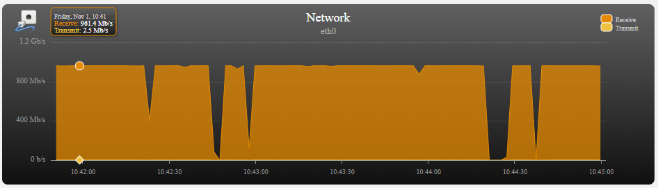

Strange, I never foud an overshoot > 113 MB/s when doing SMB transfer on 1Gbps ethernet.
Below are some practical transfer in Unraid view, most time in saturate but some deeps not avoidable.
It will if the source and destination are on the server.  In that case, the data never actually traverses the network with SMB3
Yes, if it is the case. From previous video, I notice a rather long slow/pause period during network transfer, so I assume actual file in transfer there.
