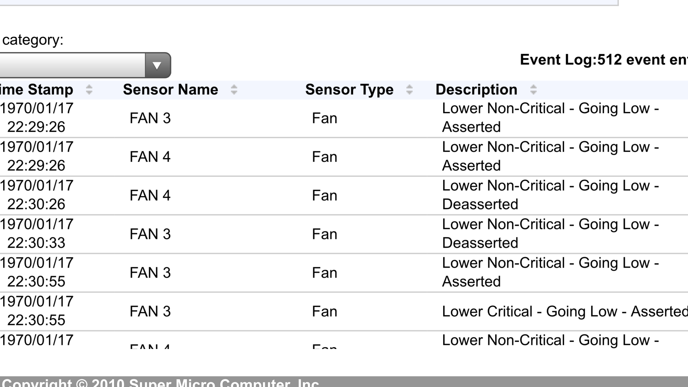

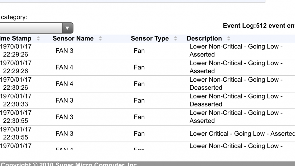

You have ECC RAM, according to your sig. It corrects single errors and the system halts if it detects multiple errors. Have you checked the BIOS event log?
I only see fan sensor events. Are these relevant?  I just figured this was akin to benign messaging to display fan speed changes based on temperature.
