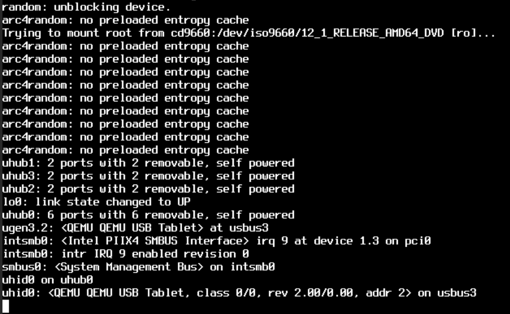

For some reason the installer freezes on "USB tablet" and never shows the install menu.
FreeBSD 12.1-RELEASE 64 bit
Opnsense is based on FreeBSD but could well be an older version that "runs" at the moment. Unfortunately, I need 12.1 :)
Same.
I've tried just about everything I can think of. I also suspect Opensense is a little behind.

Freezes here:

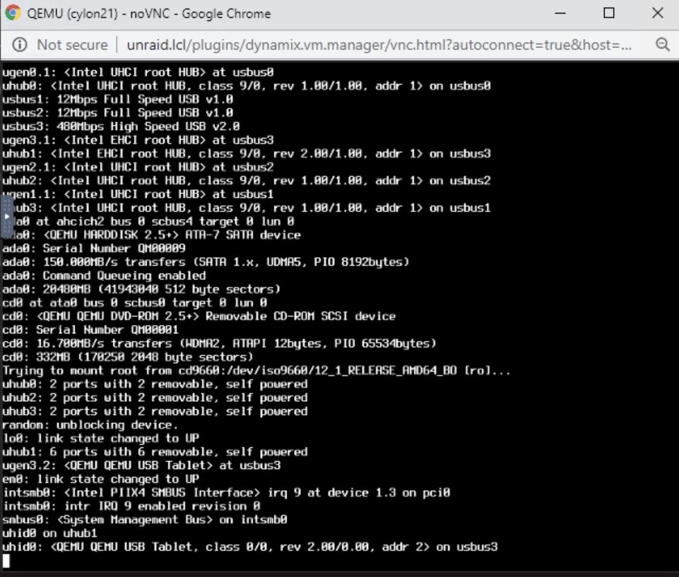

I 'm just saying that both OSes didn't present any network interfaces, in my case, when using Q35 machines while they did present them with the i440fx.
HTH
@jonp just tested Version: 6.8.1-rc1 - it's same - no network (including passed-through pcie nics), no disk.
Tested on: Q35-4.2 & i440fx-4.2, FreeBSD 12.1-release

As posted earlier, i440fx does not work, it hangs when booting to the installer iso. From all the other reading I've done, I'm under the impression that it should work. I suspect that issue is unrelated, and may be specific to unRAID.
