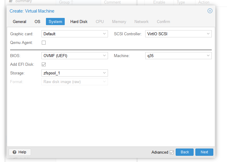

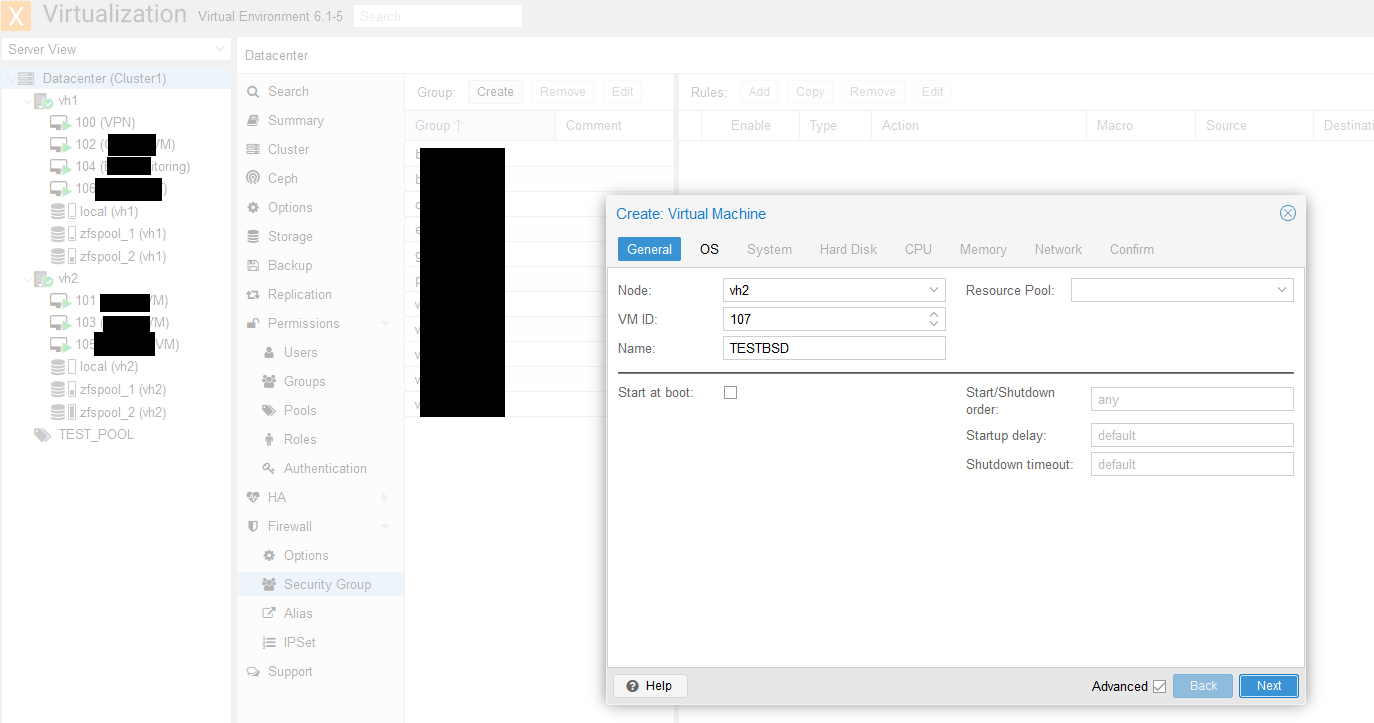

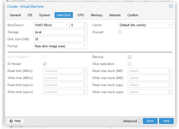

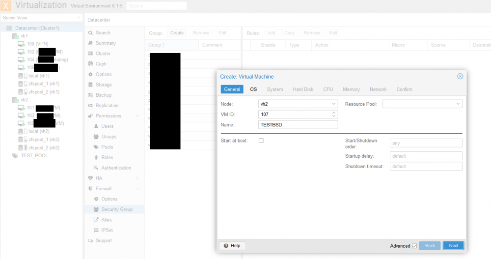

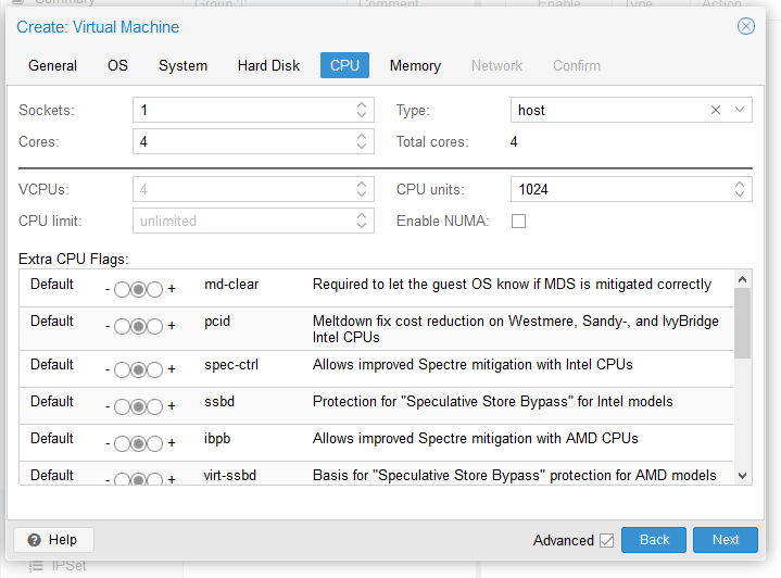

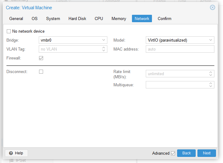

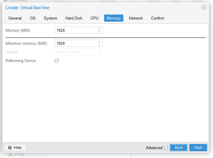

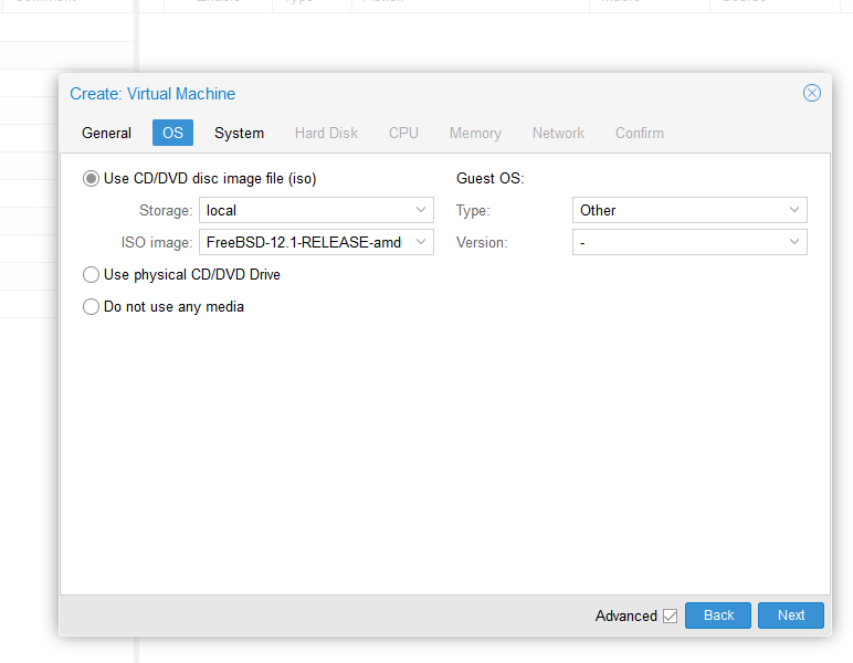

Here's how I install FreeBSD on PVE:
step1.thumb.png.36c98c7c3d02e106e702cf853f9f95c2.pngstep2.png.05c0721dbf5a7383a1ac67b0e8e3f9ab.pngstep3.png.1df327541ec072fa5f33e95afa204cab.pngstep4.png.fb6f0af2120630dff8bae303034833d0.pngstep5.png.922652285ae75dd8ff32cf3f76809dd5.pngstep6.png.dfd3814b5758c23cdf6965f539c7195c.pngstep7.png.cc4ab67278a0407739d496ce19838548.png
@jonp It finds the VirtIO disk, finds the VirtIO network.
Not much else I can say about this... It just works.
And here's the config of the VM I just installed:

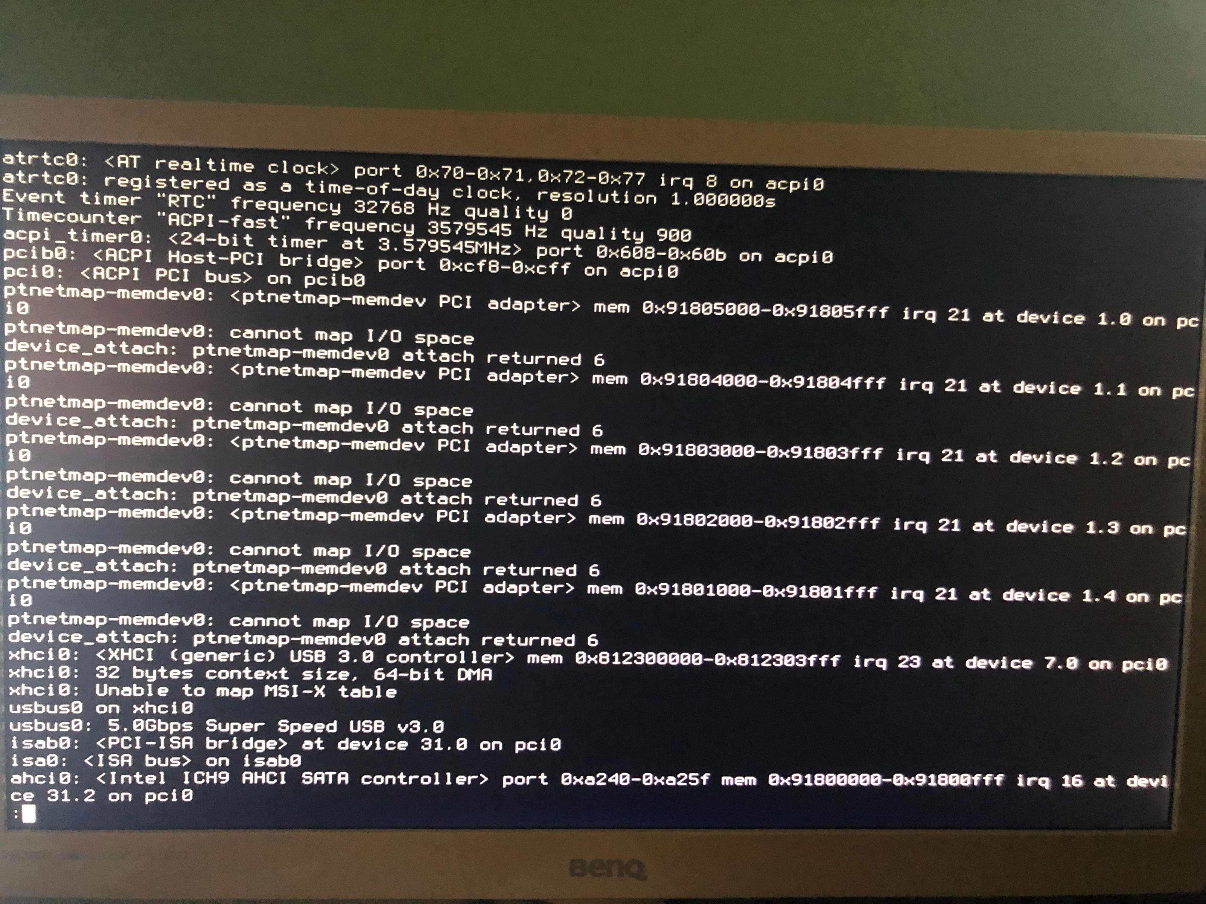

Q35 4.2 OVMF - managed to install with a GPU attached.
Patched & compiled the kernel with device netmap disabled, rebooted - still no network through br0 or virbr0 - no network device detected at all.
Compiling with the 2nd patch added (netmap still disabled) - no network.
Compiling with netmap enabled + both patches -> compiled fine, still no vmbr0 / br0 networking devices detected.
Edited by ChewbaccaBG

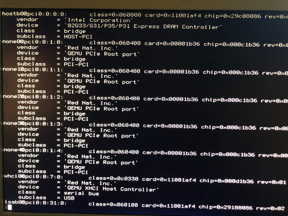

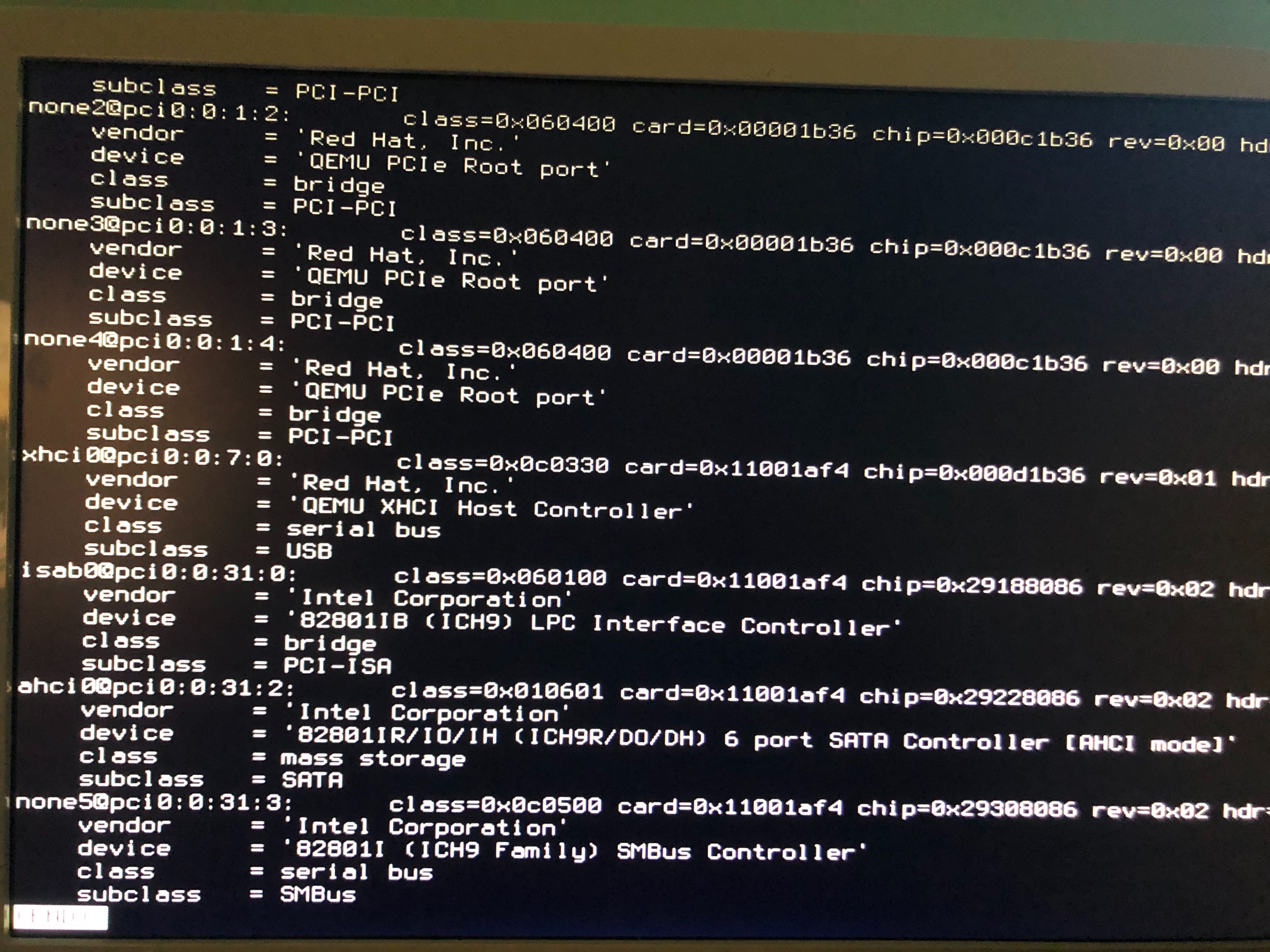

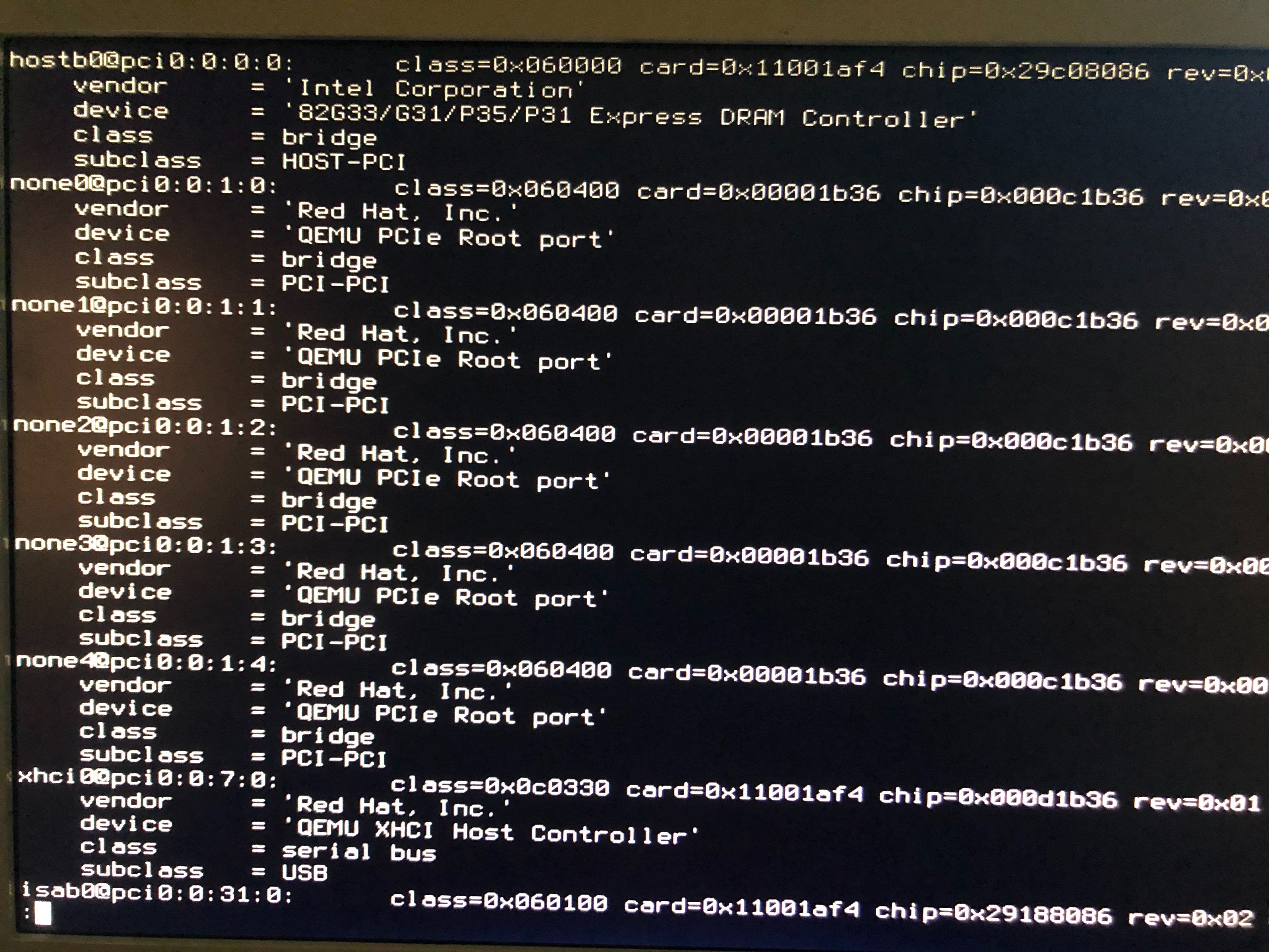

Did you configure DHCP, or set up IP address? What's output of ifconfig and pciconf -lv ?
During the install - it doesn't detect the network interface, so I continue the install without it.
Compiled kernel with 2 patches - rebooted - no network (I'm not passing PCIe NICs, I'm trying to get the br0/vmbr0 working).
Here's the output of pciconf -lv:
617311303_ImagefromiOS(1).thumb.jpg.d1235d97017459a3612f834ce74c4c4c.jpg1280745607_ImagefromiOS(2).thumb.jpg.7573cd3299efa7831175edcb8a0879a0.jpg
