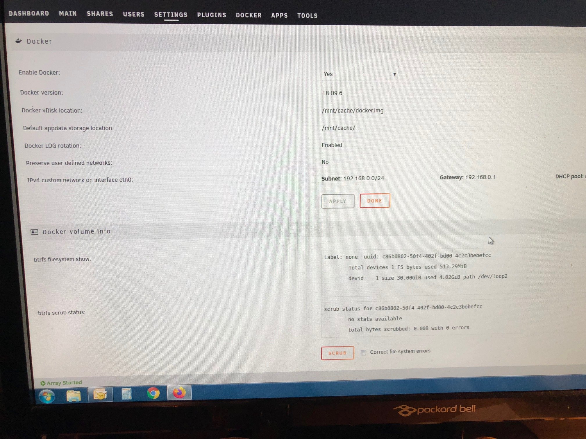

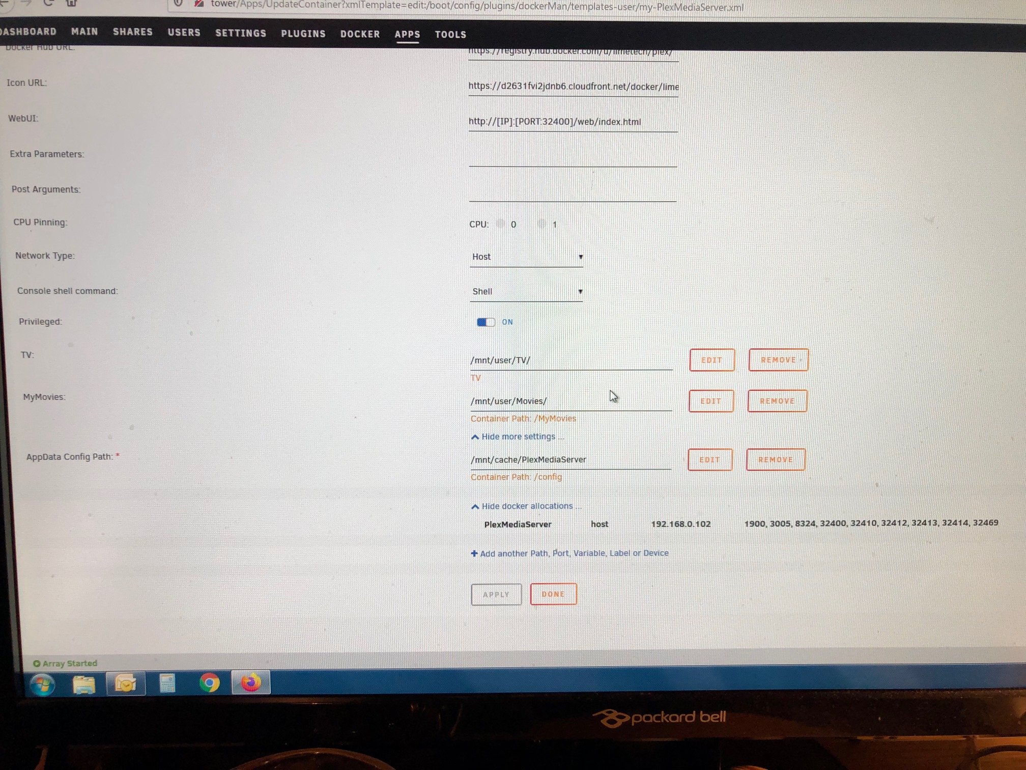

If it is related to plex then maybe you should post a screenshot of the docker settings for that (assuming you are using a docker version).  Maybe something is configured such that plex is writing to RAM.
Thx itimpi

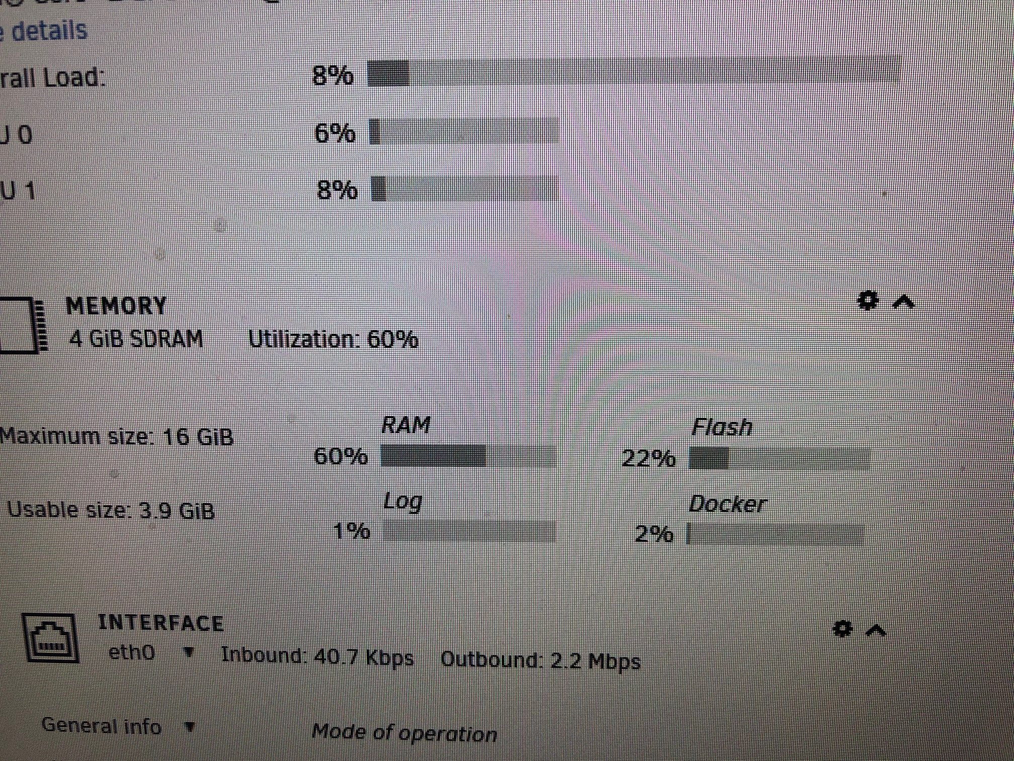

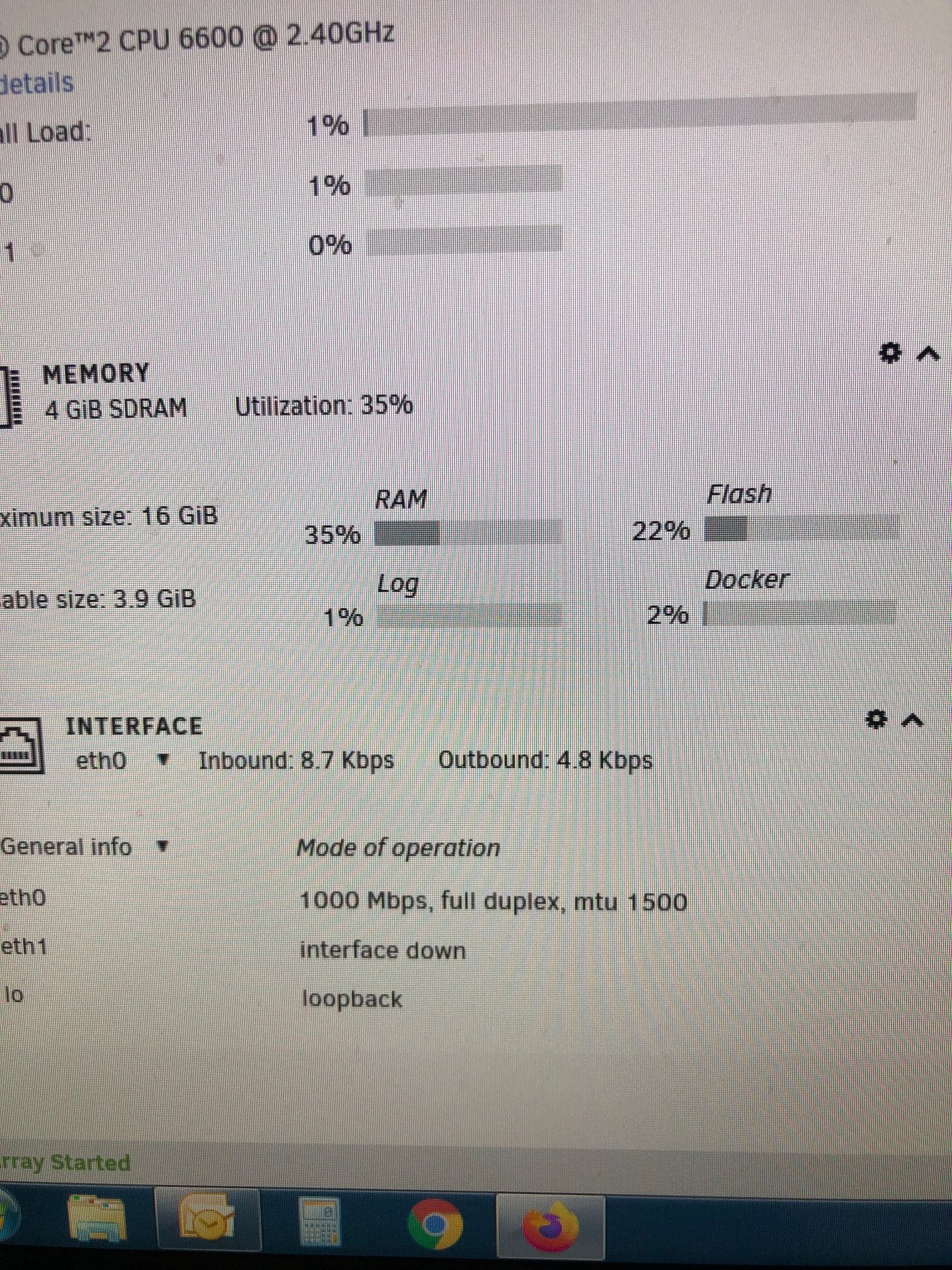

Are these images any use? This is my status with plex running but not streaming
After 5minutes streaming to tv ram is at 50% After 10 minutes it's 61% (image at bottom)
