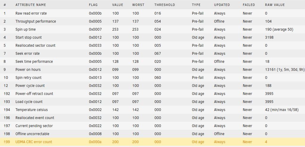

Having similar issue .

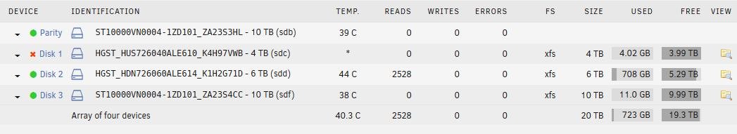

Disk 1 "Device is disabled, contents emulated"
Error:  UDMA CRC error count2019-11-01_023014-BIGNAS_Device.jpg
So have done :
0. Replaced PSU  with 650W unit  that has SATA power connectors,  3 drives/power cable ,
1. Formatted Disk 1
2.
xfs_repair status now reports no faults.
3. Smart Check:  Completed without error
4. Reboot, start array.
However,  the Disk1 is still showing as Disabled. How to enable it?
Since you formatted the disk if you rebuild all data will be gone, i.e., disk will be empty, is that what you want?
Also there are read errors on disk2, so a rebuild might result in corruption, but without diags no way to see how the disk is.

52 minutes ago, lemoncurry said:
I assumed that "contents emulated" meant the data had been shifted to other drives , before unraid disabled the drive, is that not the case? If not what does "contents emulated" mean then
No.    What UnRAID is telling you is that it is acting as if the disk is present by reconstructing on-the-fly the contents using the combination of the other drives plus the parity drive.    Unraid never moves data between array drives on its own - it always takes manual action to achieve that.
54 minutes ago, lemoncurry said:
I assumed formatting Disk1 should not lose data from the array,  am I wrong?
That was an incorrect assumption.    When you told UnRaid to format the disk it was an instruction to write an empty file system to the disk and update parity appropriately.     If the disk was was disabled then the format took place against the emulated drive and not the physical drive so you may still have retrievable data on the physical drive that was disabled.

See itimpi's reply to the other questions, basically to recover the data from disk1 you'd need to do a new config and re-sync parity (assuming disk1 is indeed healthy).

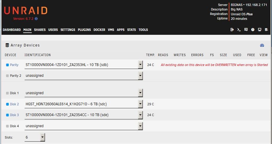

Damit this is confusing.!  Ive follows the Doc'c procedure for "Remove a disk",
 Removed Faulty Disk 1,
 Preserved the Parity and Cache assignments.
 Reassigned Disk 2,  3 as per previous assignment. Leaving out Disk 1
I'm now presented with a warning for Parity Disk:
"All existing data on this device will be OVERWRITTEN when array is Started"
Which means the Parity will Be recreated for Disk2 & 3 data, the exact opposite of what I need!

3 hours ago, lemoncurry said:
What the!  This process is supposed to preserve Content,  not overwrite it!
By removing disk1 parity needs to be re-synced, hence the warning, data on remaining data disks will remain untouched.
