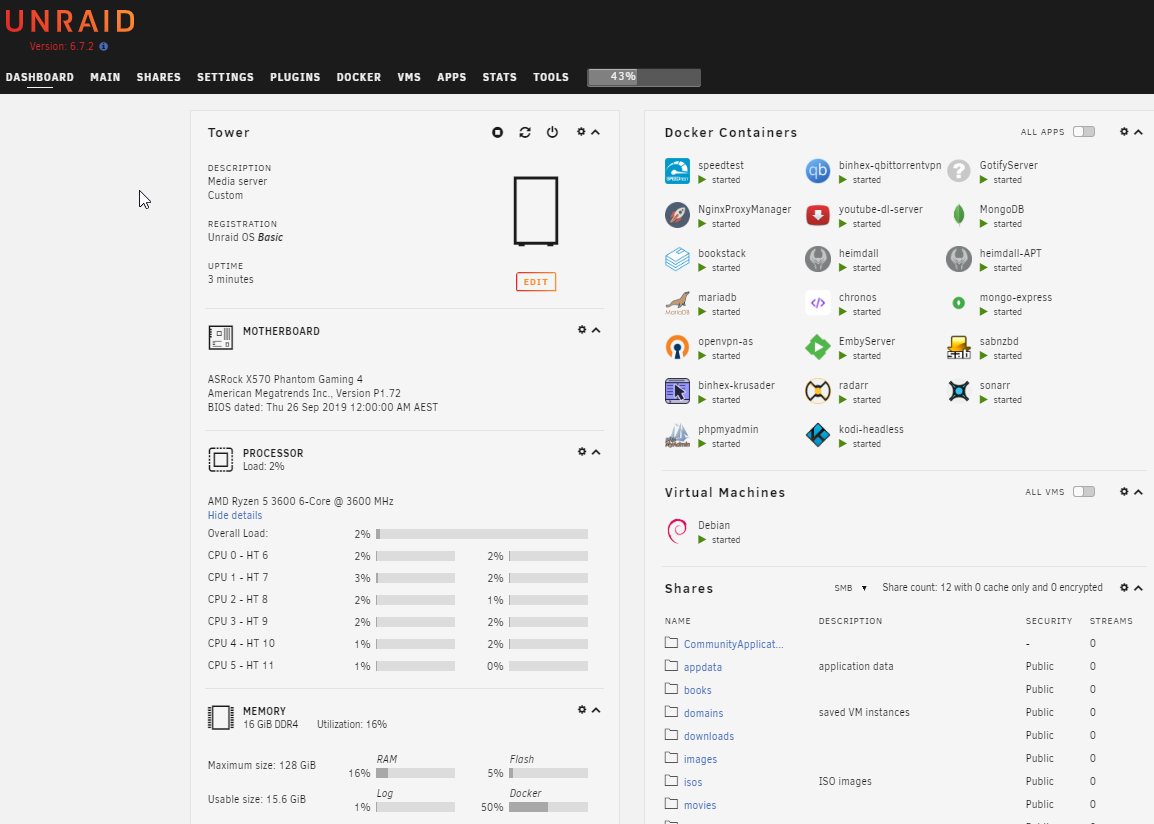

There is plenty of free CPU power and RAM as shown in the screenshot below.

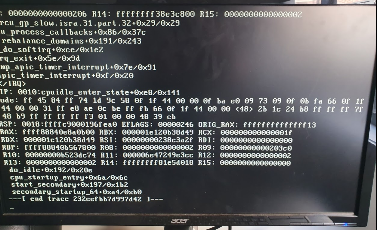

That didn't seem to help though, so I connected a monitor to the GPU and it displays the following screen when it crashes:
Is this the C-State issue I have seen mentioned? I thought that was meant to be resolved with these newer Motherboards/CPU?
try to change the Power Supply Idle Control in bios to typical current idle, I'm fine with that using x470+3700x
Will give it a look! Hadn't noticed that setting. Thank you!
You shouldn't need it for anything later than 1000-series processors, but it won't hurt. In case you struggle to find it it's usually at Advanced -> AMD CBS -> Power Supply Idle Control in the BIOS. Give it a try and report back to let us know if it makes a difference.
So despite the Motherboard stating it doesn't need updating to support Ryzen 3, and the C-State issue apparently not existing in Ryzen 3 I believe that is exactly what it was. I have updated the Motherboard now and haven't faced any issues, surprising that was required considering the board came out mid this year I believe?
Regardless - glad it is now sorted. Has been stable for ~5 days now and enjoying the significant power increase over the old HP Microserver N54L!
