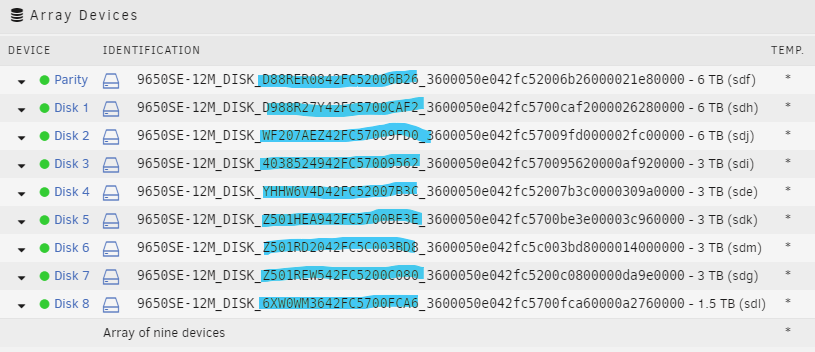

However, I'm a little worried that it will work correctly with my setup.  My SuperMicro is using a 9650SE-12ML RAID card which does not support IT mode.  The drives are setup in "single" mode in the card config, but the controller still sits in front of the disks and prevents "direct" access (e.g. blocks SMART, etc.) and changes the drive identifier string.
Here's one of my disks on the RAID controller with the id string:
Oct 29 20:56:25 Hyperion kernel: md: import disk0: (sdf) 9650SE-12M_DISK_D88RER0842FC52006B26_3600050e042fc52006b26000021e80000 size: 5859363788
I am putting an IT-mode RAID card in the new box (Dell H310, LSI 2008) to get SMART support.  I am pretty sure that after I swap the drives to the new system/controller and boot Unraid, the disk identifier for each disk is going to be different on the new controller.
Do I simply need to make a note of each drive's actual identifier and then manually match them up with the appropriate slots in Array Devices when I boot the new hardware with the old drives (see attachment)?  Am I making this too complicated?  Am I missing something else important.

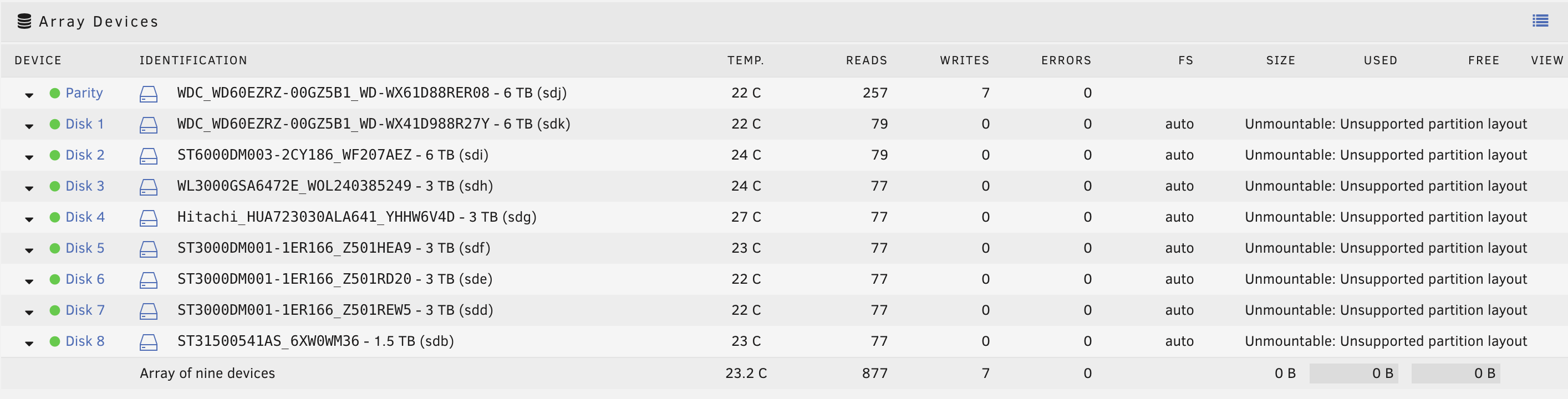

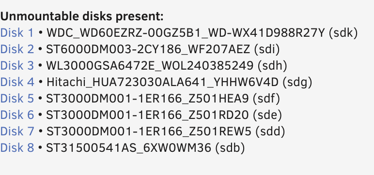

Thank you both for your replies.  I attempted the disk move tonight, and as predicted, Unraid said the disks were missing when I booted and "Wrong" when I selected the appropriate disk.
I created a new config as recommended by @trurl, checked "Parity already valid", and started the array, then got the "Unmountable: Unsupported partition layout" on each of the disks (except parity) that had been connected to the previous RAID controller (now on the Dell H310).
When the system was booting, I believe I saw something flash by about the GPT layout sector something not being at the end of disk or something.
I did some Googling and couldn't find many useful hints at what to try.
Any thoughts?

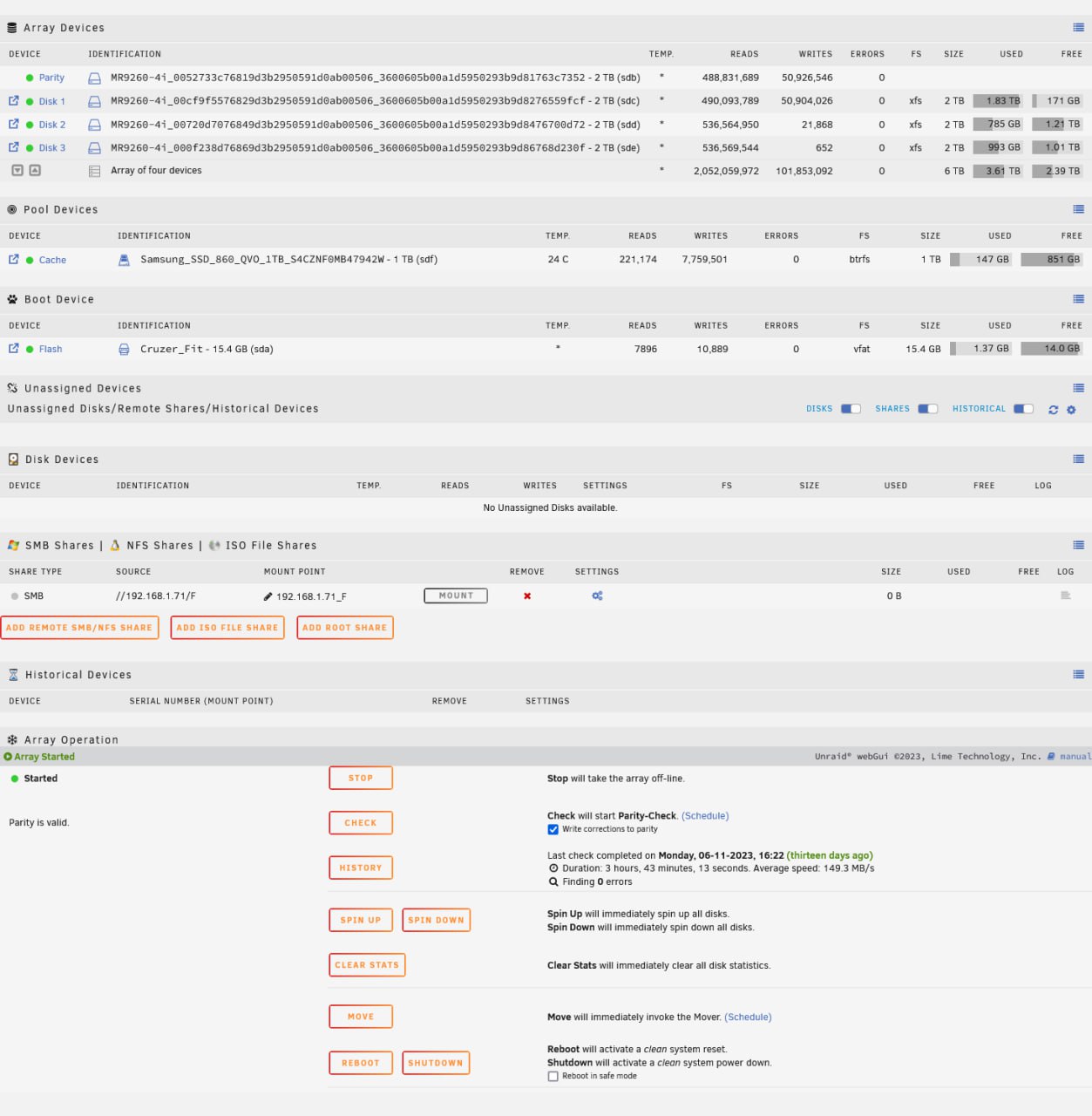

First of all, sorry for digging up this old thread, but this is exactly what happens with me too.
I moved from a Supermicro blade (with a separate hotswap bay/raid controller, I guess) to a new custom build, with sata on the micro-ATX motherboard.
I am 100% sure which drive belongs in which "slot" of the "Disk 1-3" (I used to have only 3 disks and an SSD cache).
I am sure about this, because I used Unassigned devices to check the amount that's used of the disk.
Old server:
telegram-cloud-photo-size-4-5969839237194956451-y.thumb.jpg.e43c3cfe0fc67cc19571c107d51bfc93.jpg

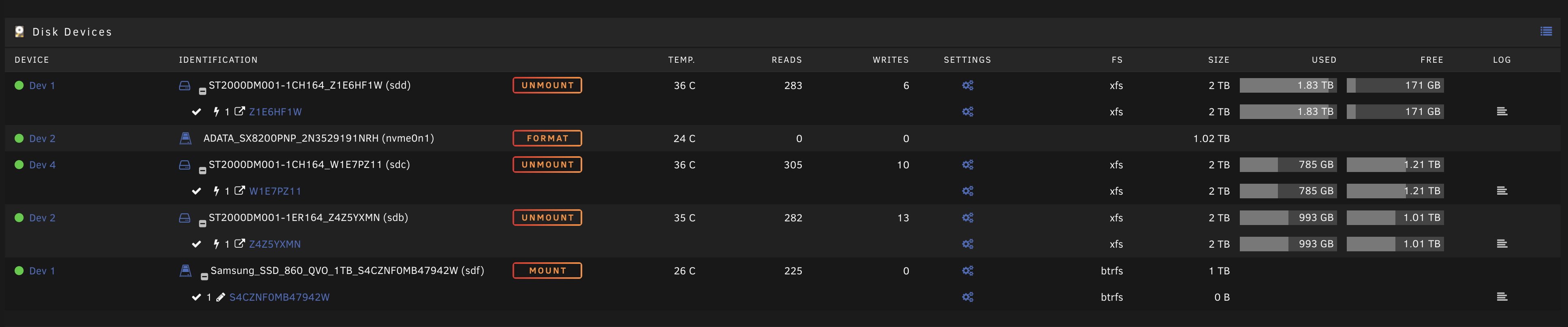

Unassigned Devices, mounted disks, with disk usages:

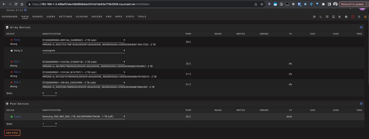

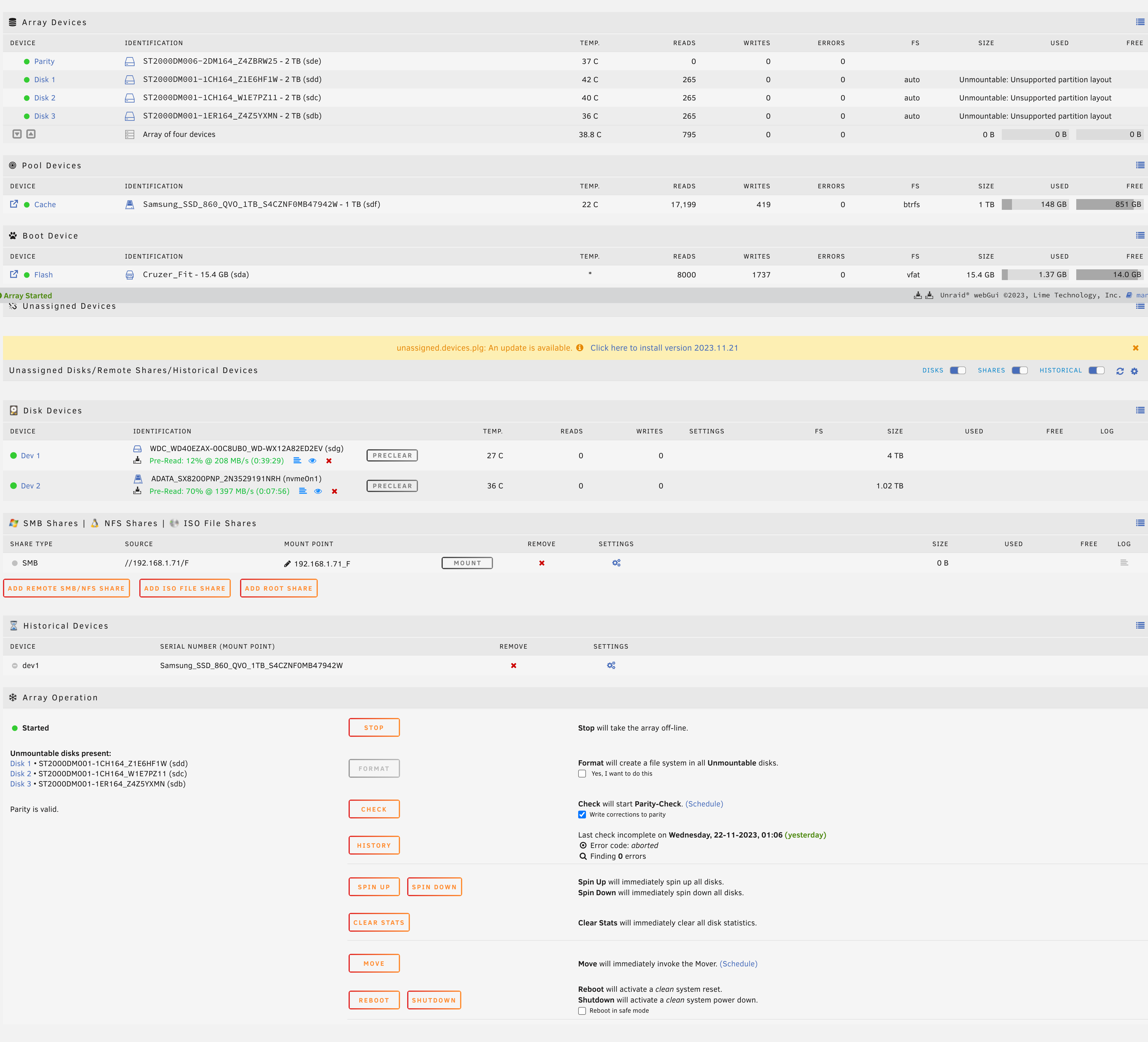

New server after assigning disks to the correct Disk #
telegram-cloud-photo-size-4-5974271841012924510-y.thumb.jpg.647e7ff9b23feed9c34a9a58b10d4f36.jpg
I ran the "New Config" on the "Array" disks after I set them up as shown in the screenshot above, which lead to this config (btw, the cache disk was detected before successfully (as seen on the screenshot above this line), nothing changed there. Maybe because I only created "New Config" for "Array" devices?)
However, when I start the array, I get an error on each disk. "Unmountable: Unsupported partition layout"
What do I do next? I don't understand what needs to be done from the comments above saying "rebuilding one by one". What do I need to do to get it up again.
IMO it should be fine now, why is it Unmountable?
This can happen when moving from RAID controllers, they sometimes don't pass the complete partition.
Rebuilding one by one is an option,  but it would have been better if you checked parity was valid.
Other option is to use UD to copy the data.

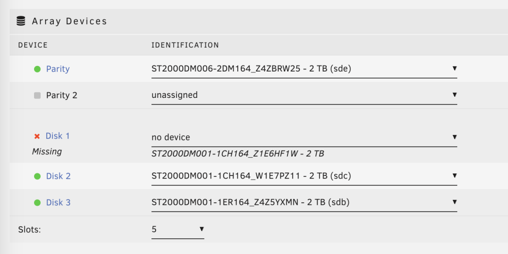

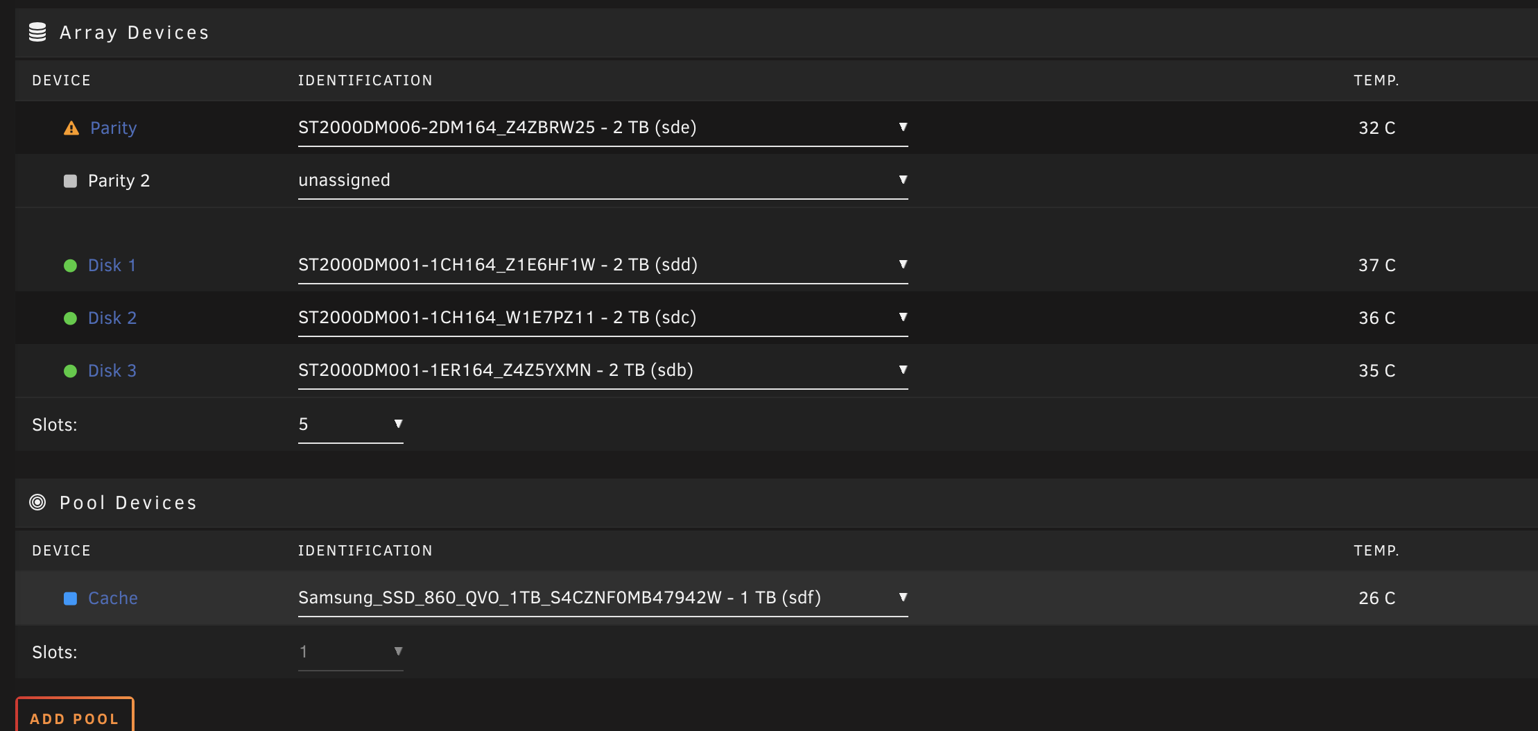

This is my current situation:
Step-by-step (is this correct?):
  1. stop array
  2. set parity 1 to disk `(sde)`
  3. set disk 1 to disk `(sdd)`
  4. set disk 2 to disk `no device`
  5. set disk 3 to disk `no device`
  6. start array
  7. do parity check
  8. set disk 1 to disk `no device`
  9. set disk 2 to disk `(sdc)`
  10. start array
  11. do parity check
  12. set disk 2 to disk `no device`
  13. set disk 3 to disk `(sbd)`
  14. start array
  15. do parity check
  16. set disks 1,2,3 to resp sdd, sdc, sdb
  17. start array
  18. everything works?
Does this change when I would like to move from the 2TB disk to the 4TB disk (as I'm planning to replace all disks with 5 4TB disks)
Nope, just stop the array, unassign one of the data disks, disk1 for example, start the array, post new diagnostics.
Wouldn't I want to get parity working first? When I do this I get this message:
> Start will disable the missing disk and then bring the array on-line. Install a replacement disk as soon as possible.
> [ ] Yes, I want to do this
This sounds to me like it'll try to rebuild from 2 disks + parity, does that make sense?

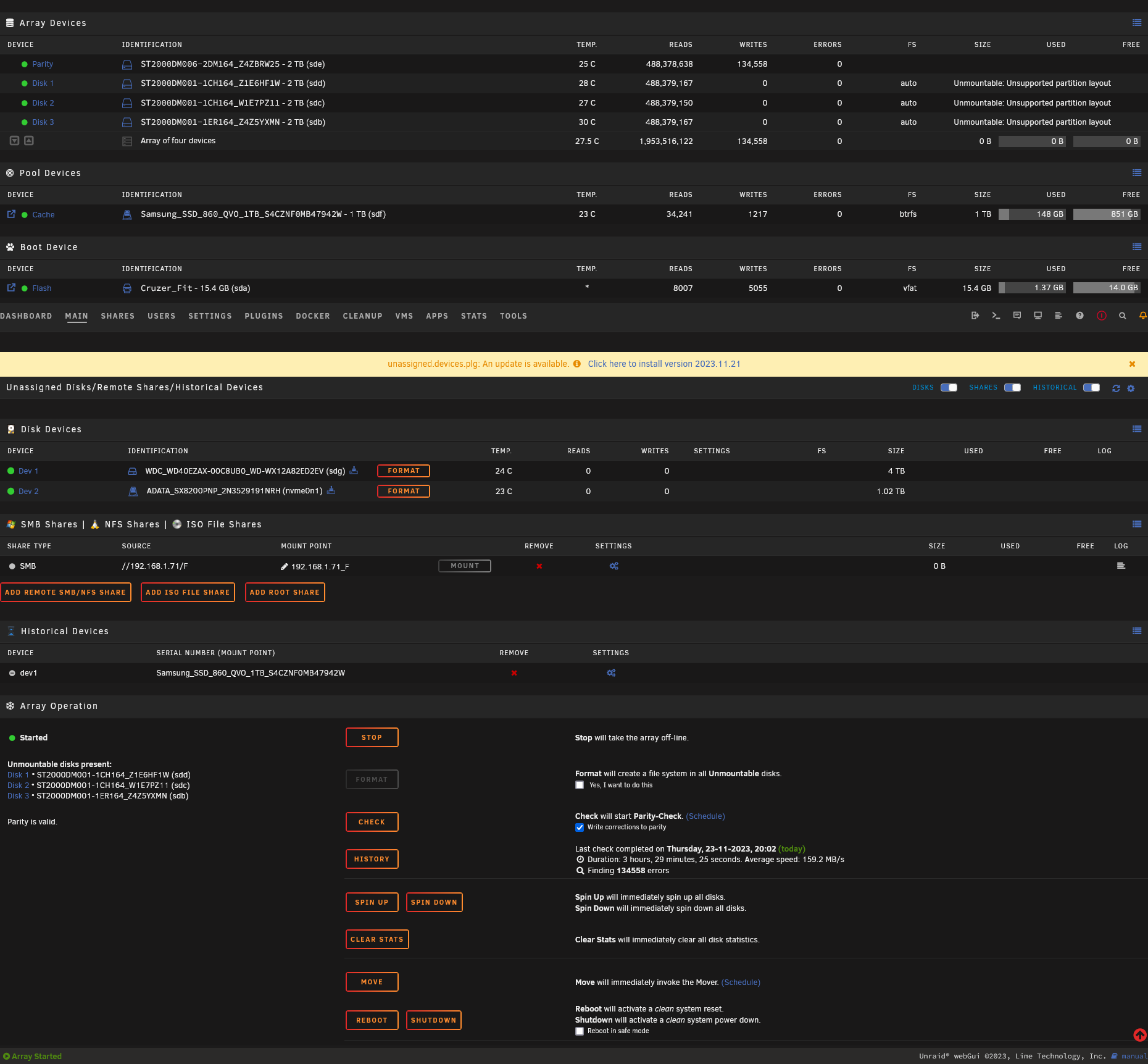

According to the screenshots parity is already valid, I assume you let the sync finish?
Parity check is completed.

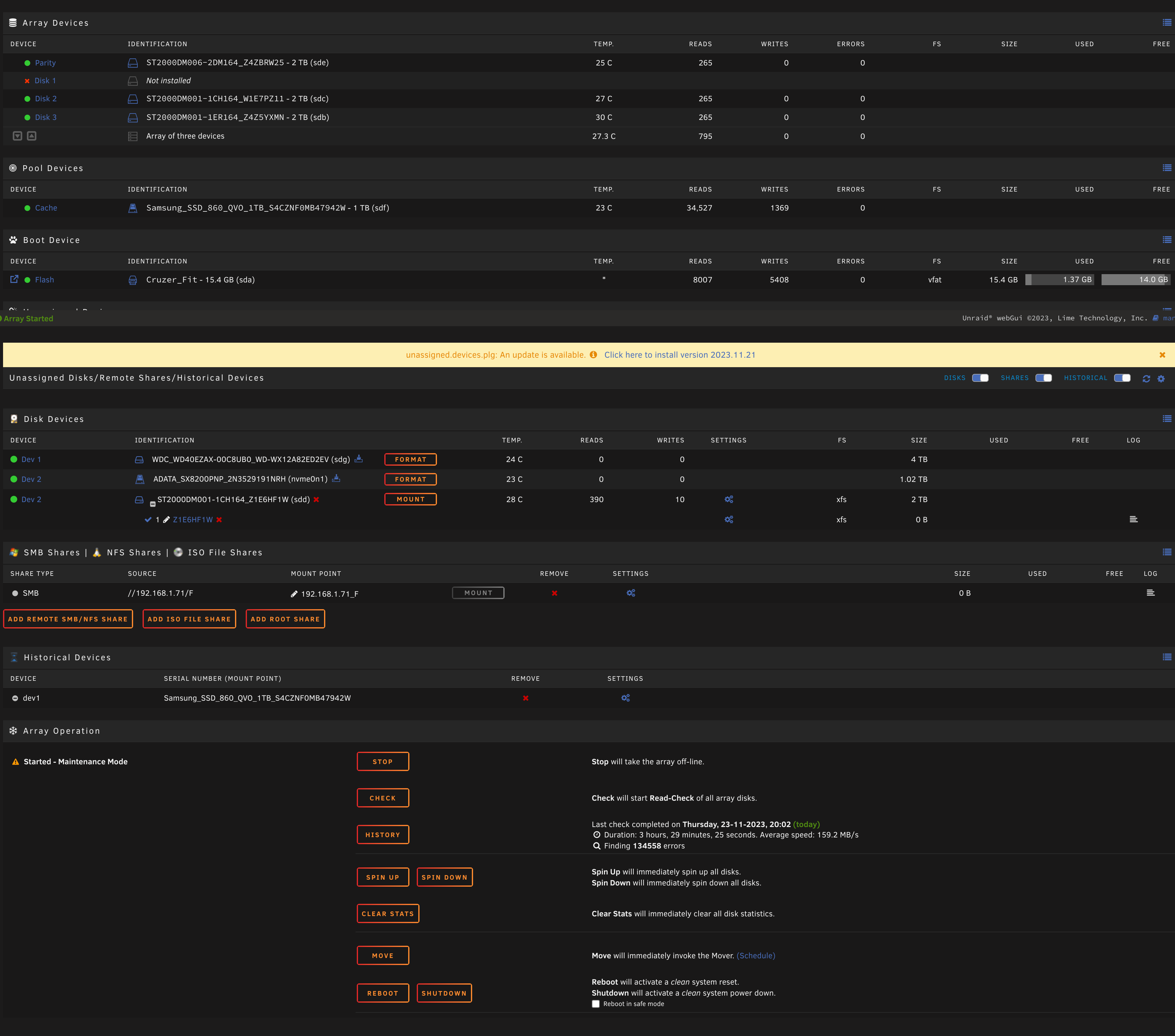

So now I would take one disk out, as in, set the disk to "no device", and run diagnostics again?
Results:
Last check completed on Thursday, 23-11-2023, 20:02 (today)
Duration: 3 hours, 29 minutes, 25 seconds. Average speed: 159.2 MB/s
Finding 134558 errors
Added diagnostics as well (for the record, it says "supermicro" that's my NAS name as my previous machine was a Supermicro)
supermicro-diagnostics-20231123-2038.zip
Edited by eXorQue
Start it normal mode, not maintenance mode, and post new diags.
Yes, the emulated disk mounted, if contents look correct you can rebuild following that procedure, once it's done repeat for the other data disks.
Everything works now. Thank you so much @JorgeB!
