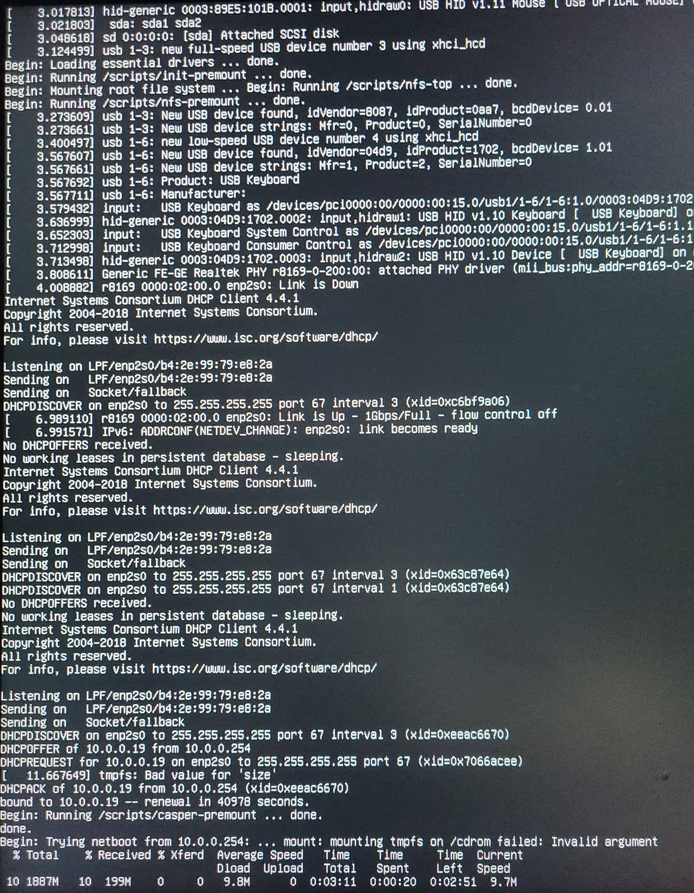

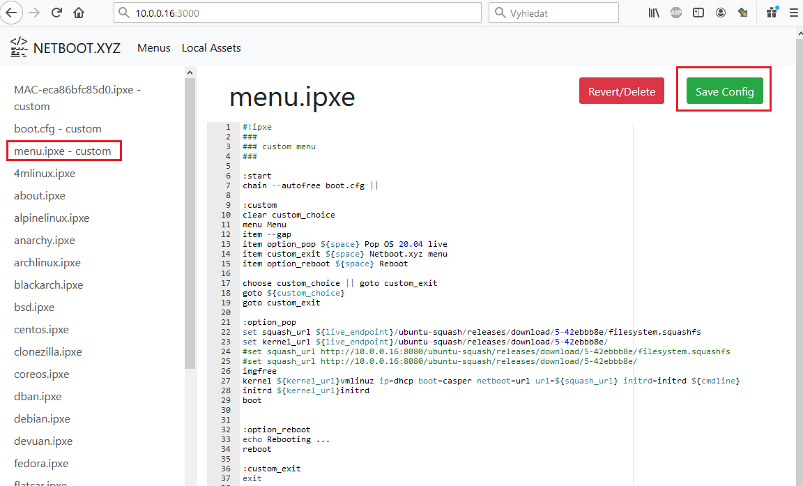

@badsmoke I'm editing the files via web interface, after every change i just "save config". Modified file then change its name to "*.ipxe - custom".
See below simple example of custom menu, system then should boot to that custom menu and from that menu you can still exit to netboot default menu (by pressing ESC or by selecting respective menu option) if you need. You can also update default netboot menu with a new menu options of your needs.
In boot.cfg file I just update "live_endpoint" and "win_base_url" variables, but this is optional. If variable(s) not updated, you will need to hardcode full path to your boot files (see snapshot below with commented lines 24, 25) otherwise netboot will take the files from "https://github.com/netbootxyz" by default.

- configured NETBOOT.XYZ via webinterface (http://unraid_IP:3000/) - in the file "boot.cfg" located under "Menus" updated variables "live_endpoint" and "win_base_url" as follow:
    set live_endpoint http://unraid_IP:8080
    set win_base_url ${live_endpoint}/WinPE/
