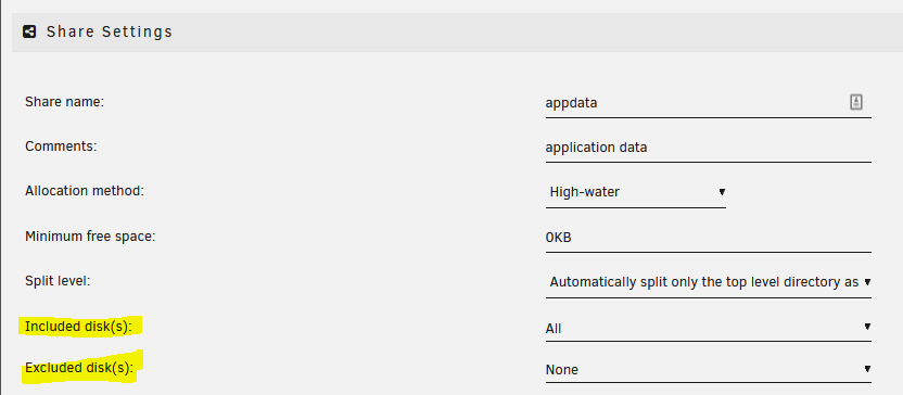

I have not messed with this, so take it with a grain of salt, but one option would be to split up your shares so that the normal file-shares only use spinning disks and your SSD's only encompass the VM shares.
It's a bit more manual, but should allow you to make sure where the VM data is located. Again I say should because I don't think this would be considered best practice.

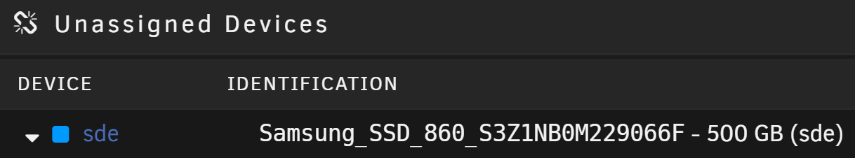

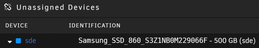

I'm getting the disk ID from "Unassigned Devices":

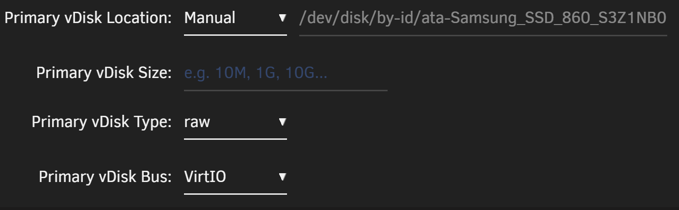

...and pasting it into the vdisk location as (largely) pictured:
I tried it with putting in various vDisk sizes (as this isn't in SpaceInvader's video) as well as chaing Bus type.  Nothin doin.

1 hour ago, rmp5s said:
I did.
I dd'd my Adobe render VM's vdisk onto the SSD and put the disk location in the VM using the "by-id" method and, when I click "update" to save the configuration, it just says "updating..." indefinitely.
Something isn't right...
Anyone see anything I'm doing wrong?  This is the PERFECT solution for what I'm trying to do!!...if I can just get it to work...lol
Thanks, everyone!
Primary vDisk Bus: Sata
Edited by jpowell8672
3 minutes ago, jpowell8672 said:
Primary vDisk Type: Sata
No matter what I do, the only options available are raw and qcow2...whatever that is...
