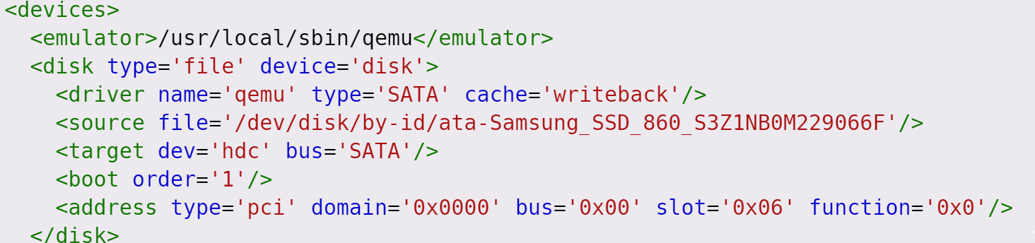

36 minutes ago, John_M said:
You can edit the xml to change it - switch from form view to xml view with the toggle at the top of the page.
Like this?
10 minutes ago, rmp5s said:
Like this?
 <disk type='block' device='disk'>
      <source dev='/dev/disk/by-id/ata-Samsung_SSD_860_S3Z1NB0M229066F' index='1'/>
      <backingStore/>
      <target dev='hdd' bus='sata'/>
      <boot order='1'/>
      <alias name='sata0-0-2'/>
      <address type='drive' controller='0' bus='0' target='0' unit='2'/>
    </disk>

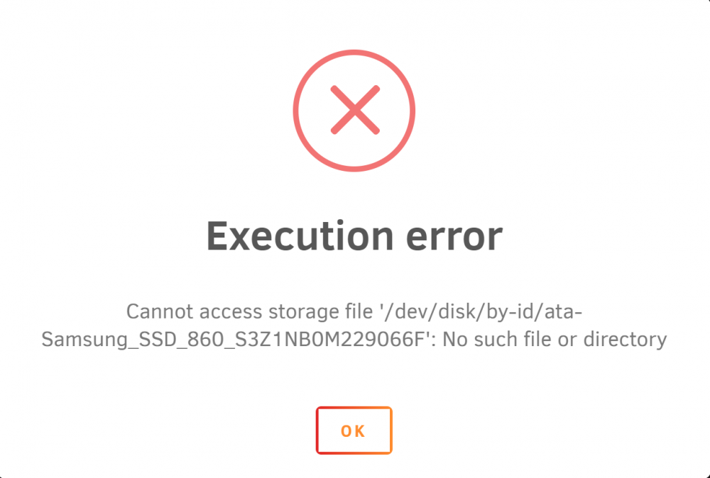

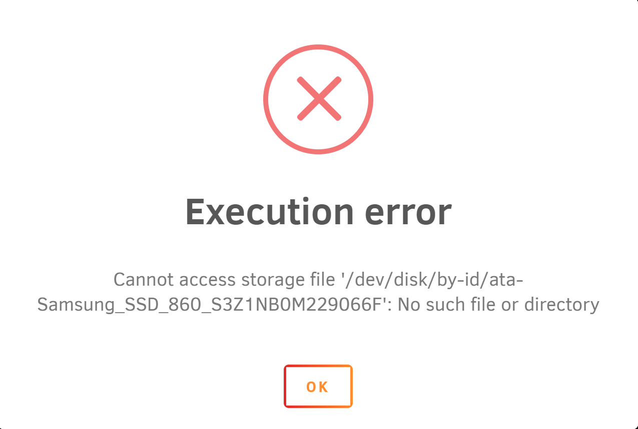

Getting this error now.  IThinking I don't have the disk ID correct.  I copied it from the main page...is there another place to see the disk ID?

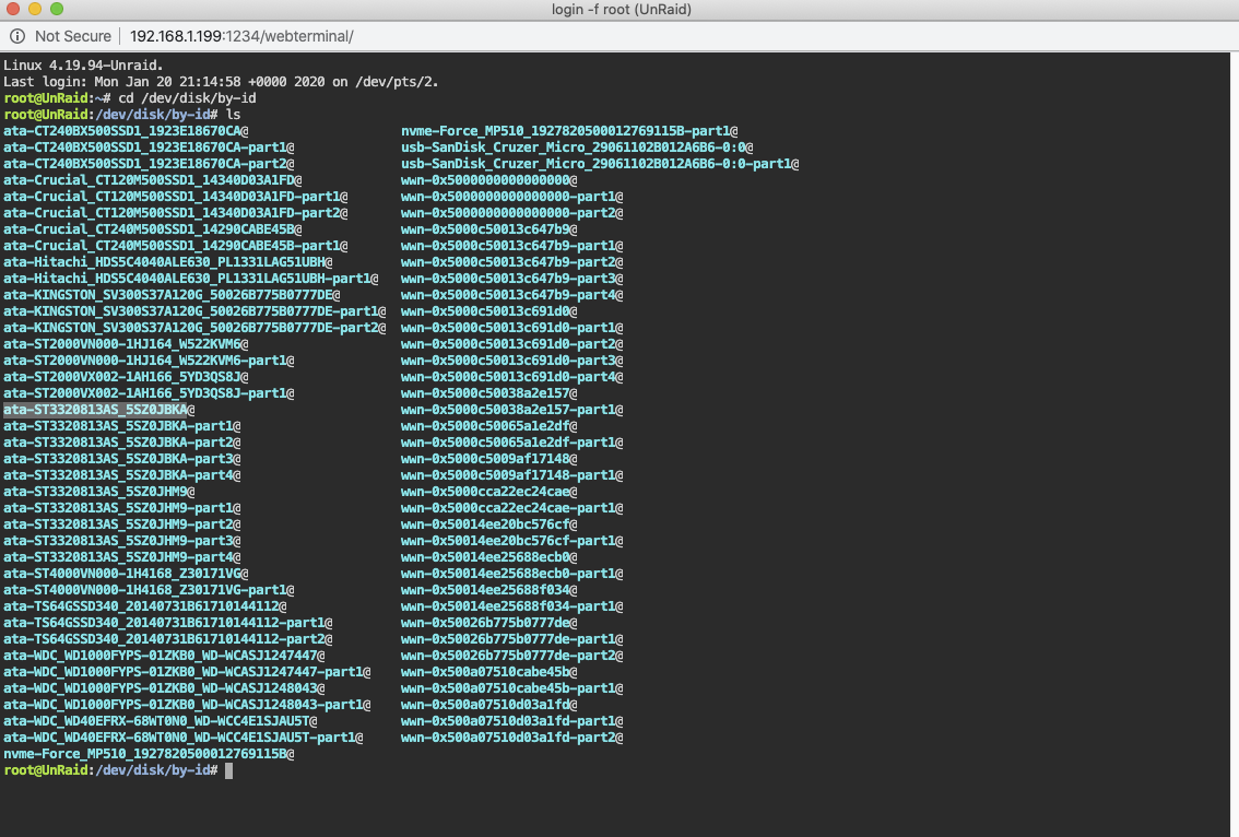

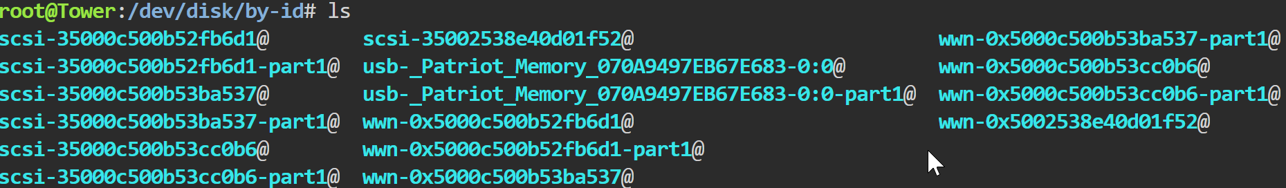

Yes. SSH into your server (or open Command Line from Tools)
to navigate to the directory, type
cd /dev/disk/by-id
The, to list all your disks, type
ls
You'll see something like this;
1703148549_Screenshot2020-01-20at21_18_24.thumb.png.9ec310a8b810109d4a96a1b96a7a4934.png
Find your disk, and select the first instance of it (none of the 'part' bits). Select up to, but not including, the '@''. That's your ID. (I've highlighted one in the first column, above).
I set up many of my VMs like this with dedicated SSDs. Here's an example of one of my passthroughs, for reference;
      <source dev='/dev/disk/by-id/ata-CT240BX500SSD1_1923E18670CA'/>
      <boot order='1'/>
      <address type='drive' controller='0' bus='0' target='0' unit='3'/>
    </disk>
Good luck
PS: check you have the type set to 'block', not 'file' when using /disk/by-id. Your latest error indicates you might have it set to file?
Good luck
Simple enough!!
Up until...any tips on telling which disk is which?  lol  I have no clue which is the SSD.  And, yup, it was set to block, not file already.

Tried that already.  It gives the error above.  I believe I have the device ID wrong.  I tried looking it up using the method above but I have no idea how to tell which device is which.
Main Tab> Unassigned Devices Identification is ID
That's what I thought.  That's what I've been using and it's giving me an error.
Then, when I do the "dev/disk/by-id/" thing, I don't see that disk ID anywhere...at all...
Very confusing...

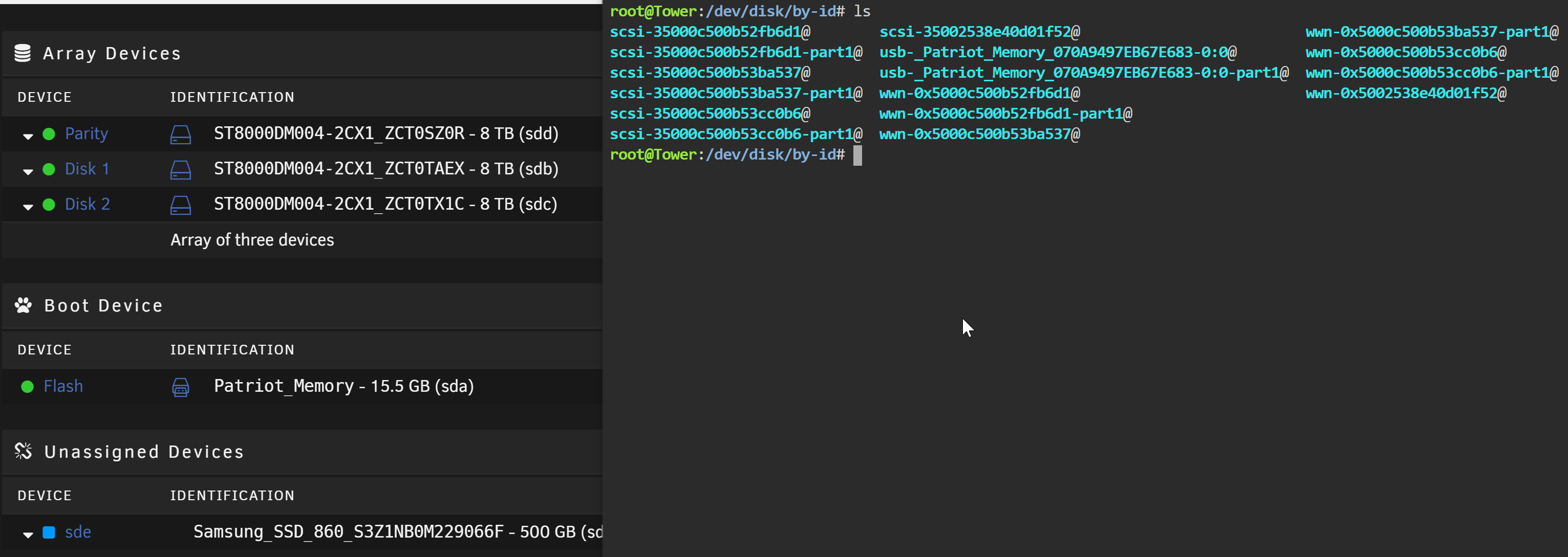

22 minutes ago, rmp5s said:
Simple enough!!

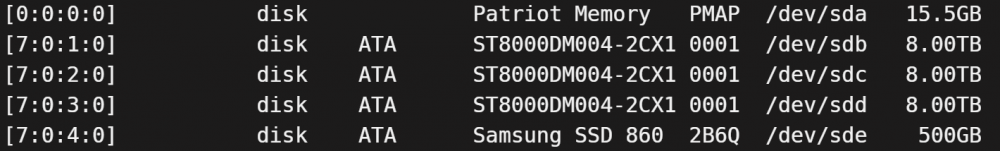

You are close. You’re just passing in a disk Id that doesn’t exist. It needs to be one of those in the by-I’d/ directory, but which one?
have a look in tools -> system devices. At the bottom it lists scsi devices, which might have some mapping, or offer a clue.
or go to unassigned devices and click the i on to the left of each drive to expand the volume structure. Any clues there?
if I had to guess, I’d guess the 4th scsi device, at the top of the second column. The other 3 have a similar structure (part) that would suggest they match your 3x array devices.

2 minutes ago, meep said:
You are close. You’re just passing in a dusk I’d that doesn’t exist. It needs to be one of those in the by-I’d/ directory, but which one?
EXACTLY what I'm thinking, too.
Looking at "system devices" doesn't scream anything to me...I don't see anything in common between the "/by-id" list and the "system devices" list.  You all see anything?
Nope. I added a few more suggestions to my previous post.
You could also also search the unraid boot log file for some of those strings. Might offer further clues.
