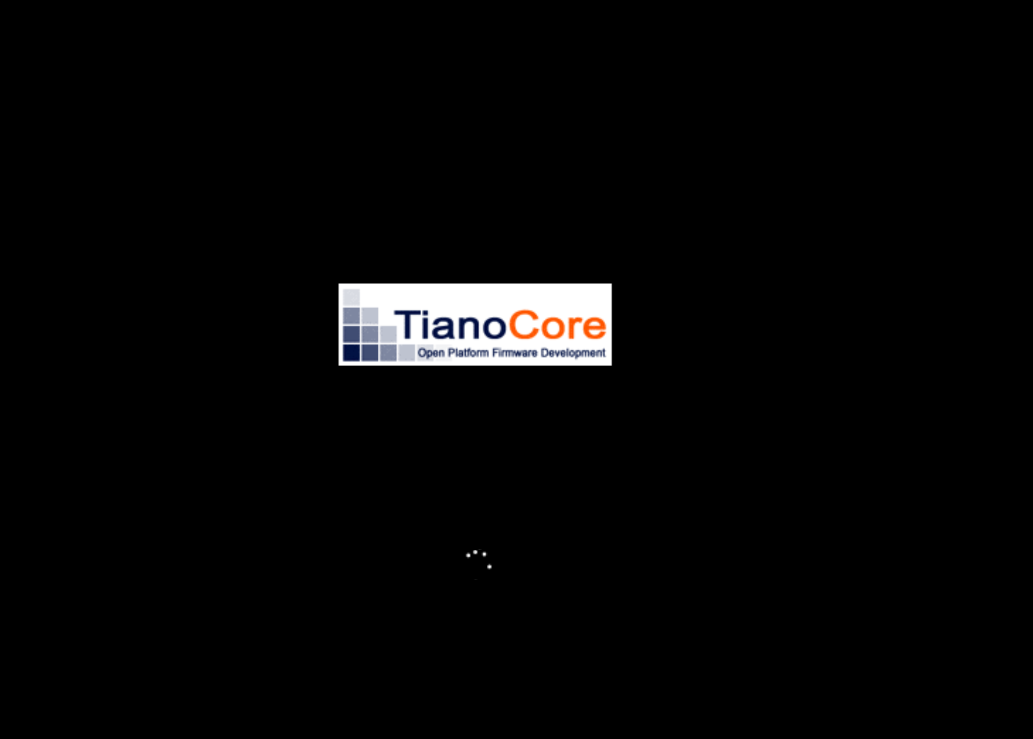

Now, let's see if it actually boots...

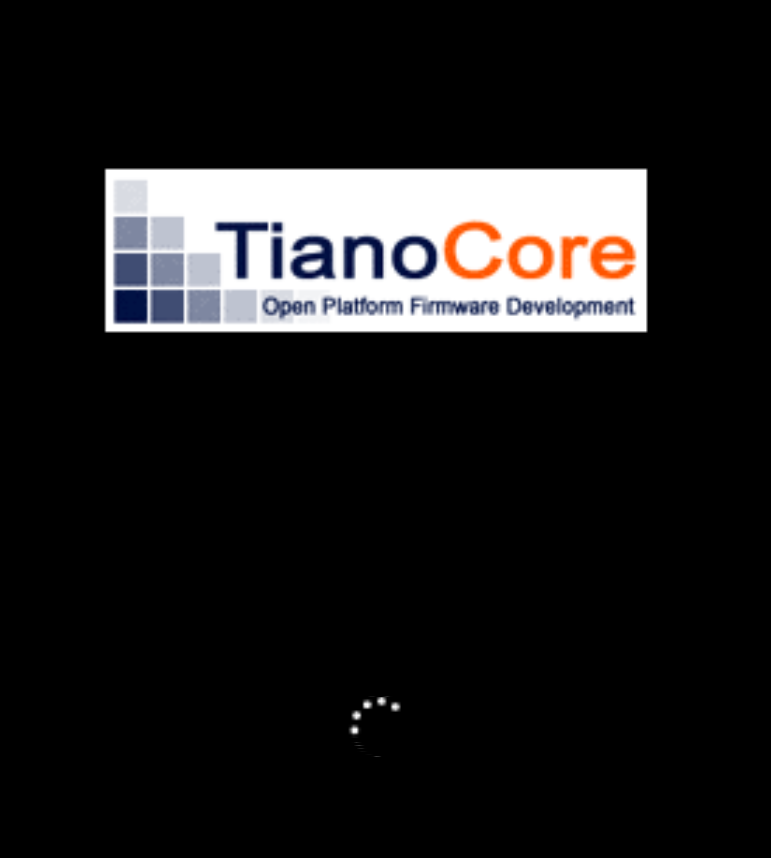

Not looking promising...lol

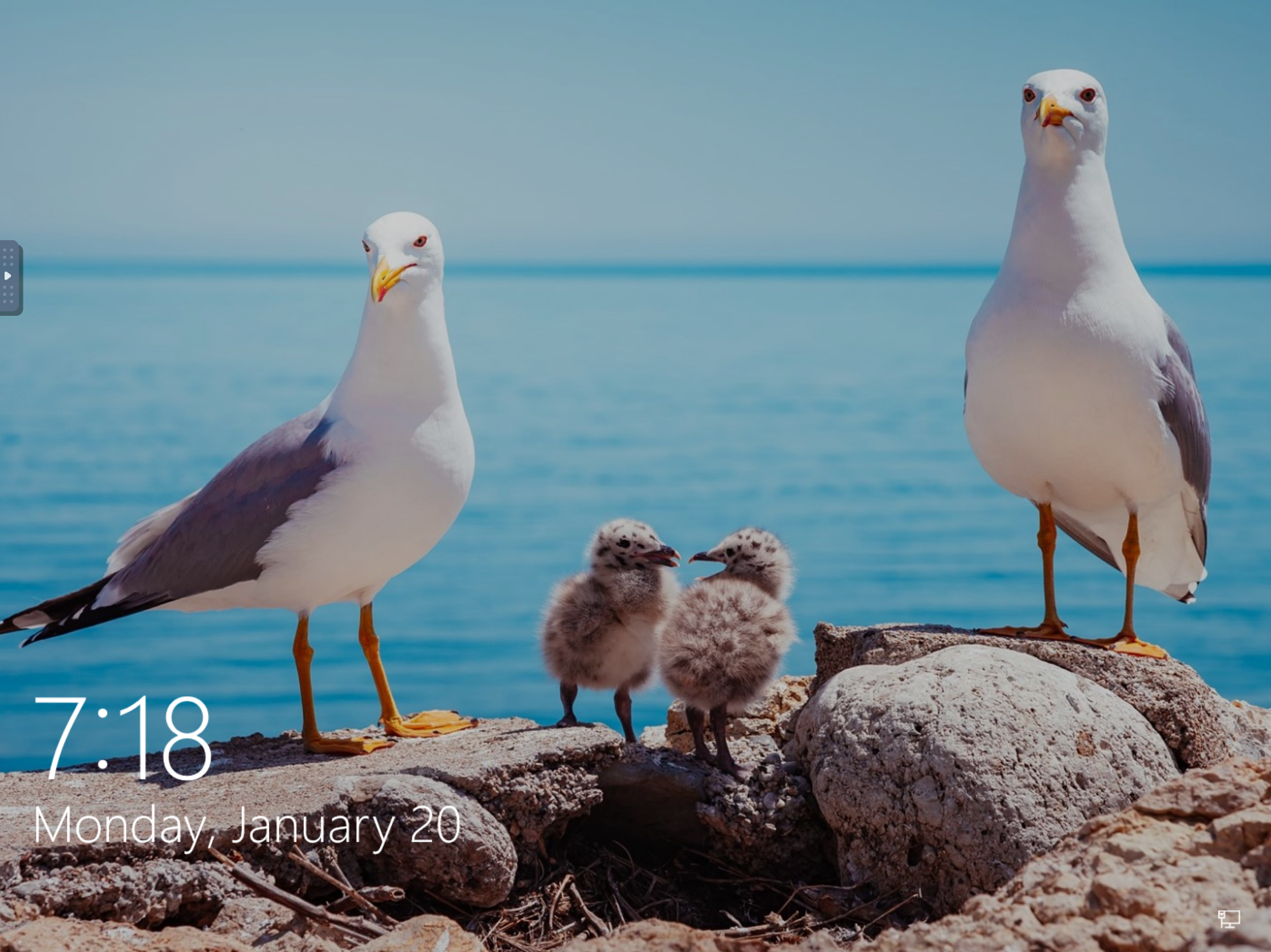

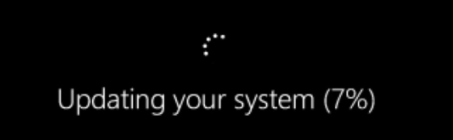

HA!!  I spoke too soon!!!
WE HAVE BOOTAGE, EVERYONE!!!  Thank you ALL for the TREMENDOUS amount of assistance everyone provided.  Next post will be the last post of the thread with a final recap of what worked.  Thank you all...you're the best.  😄

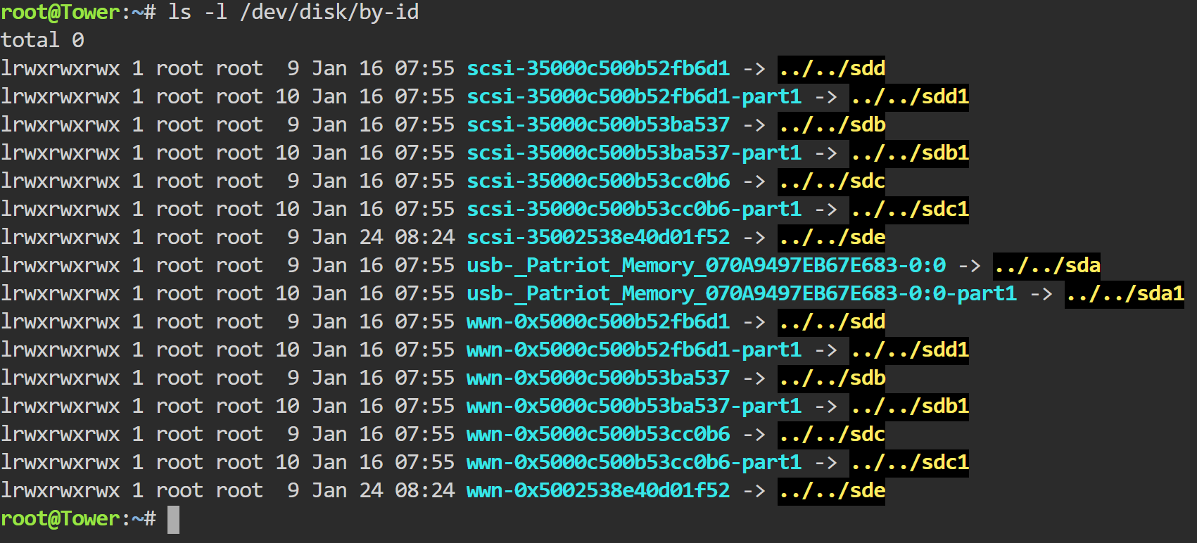

When that's done, open up the terminal (top right corner under your server stats) and run...
ls -l /dev/disk/by-id
...to get all your disk associations.  This is what I was trying to do earlier but, without the "-l" flag, it just comes out as a bunch of random nonsense.  With the flag, it shows which ID is tied to which device.
So, you run that command and you get something like this:

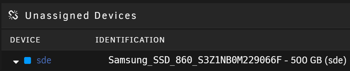

We know that the drive that we want is SDE from the "Main" tab:

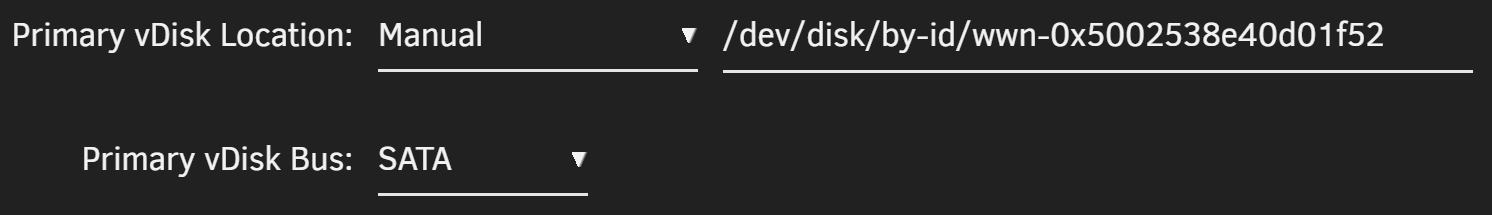

That means we can use either scsi-35002538e40d01f52 or wwn-0x5002538e40d01f52 to tell the VM which disk to use.  So, go edit the VM and hand jam either \dev\disk\by-id\scsi-35002538e40d01f52 or \dev\disk\by-id\wwn-0x5002538e40d01f52 into the disk location:
...and boom...Bob's your auntie.

If you type
you will see what the symlinks actually point to. Instead of using /dev/sdX in your configuration, use /dev/disk/by-id/Y where Y is the symlink (shown in light blue/cyan) that points to your /dev/sdX. If what I wrote doesn't make sense then post a screenshot of the ls -l command, above and confirm which sdX you are currently using (from your screenshot above it looks like you're using /dev/sde).

On 1/21/2020 at 9:28 AM, John_M said:
If you type
That -l makes all the difference.  That's how to correlate everything.  Beautiful.  I'll update my post.  Thanks.
