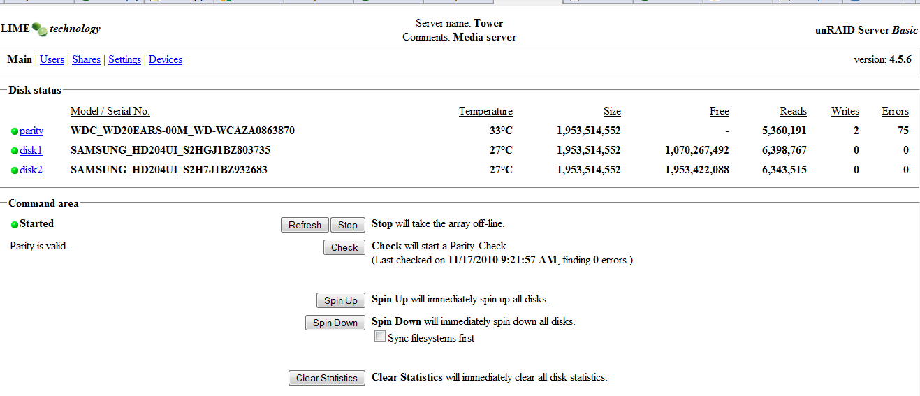

I had 1 parity and 1 data disk - everything seemed to run fine. I added another data disk and I got 1 error on the parity disk. I ran a parity check and I got 5.081 errors.
The WD 2TB parity drive is only a week or 2 old and precleared without any errors.
I could use some help figuring out the problem.

Thanks! I'll start another parity check and see what happens.
Ok, I ran another parity check. Still have some errors. I attached a new syslog and short smart report. Still having errors.
It seems strange that I did not have these problems with the parity drive until I added the second data disk.
I think I still have a week to send the WD EARS drive back to Amazon to be under the 30 day return policy. Should I be returning this Hard Drive?
