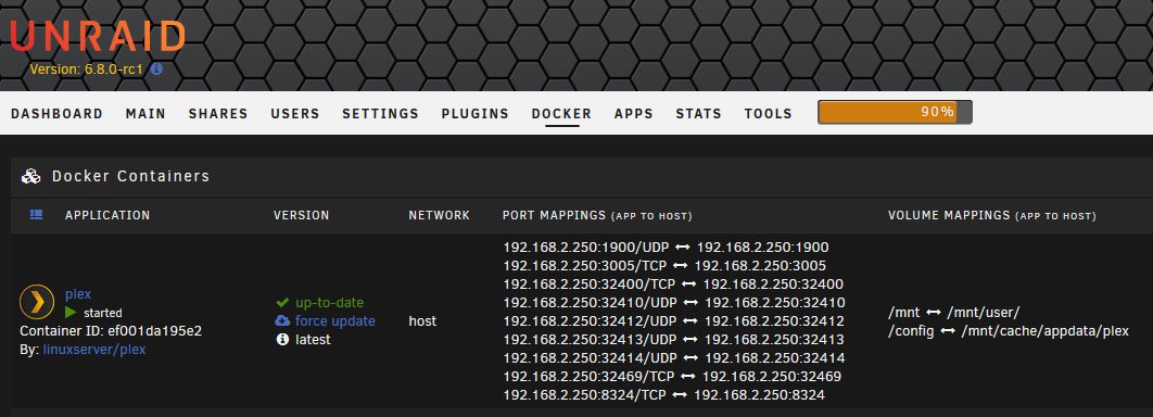

Hi folks,
i like to know if it is possible to tell Plex to use only "one" dedicated NIC to stream files?
unRAID has two networks - 192.168.2.250 and 10.10.10.250
Plex is configured to use the 192.x-IP but is using the 10.x randomly too.
All recommendations are welcome

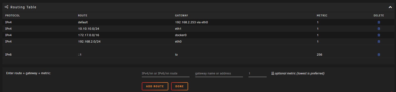

33 minutes ago, bonienl said:
Post a screenshot of your routing table (see network settings)
Here it is
I didn't change anything - all default.
Edited by Zonediver
That looks alright.
In this case Plex will only use 10.x if anything is sourced from this subnet, e.g. a client with address 10.10.10.x talking to Plex.
In all other cases it will follow the default gateway 192.168.2.253
1 minute ago, bonienl said:
That looks alright.
Yep - thats right - only my PC uses the 10.x network - but not always... thats the strange thing - but never mind...
