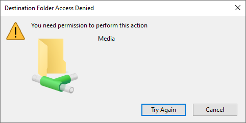

I have to leave my shares set to Public. If I set them to Secure then I can not write to them. When I try I get this pop-up.
This used to work. It used to ask me for a username and password but no longer does.

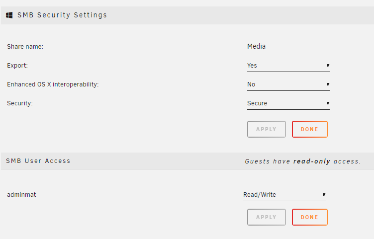

Here is how I have my media share set up:

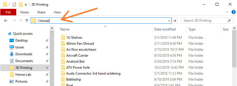

5. opened the network drive share (\\tower\Media in my case) in Windows Explorer by clicking on the location field at the top and typing in "\\tower" (what I named my unRAID box)
Then the Media folder will show up. When opened the contents will show up but when you try to make an edit (add a New Folder) it then prompts me for username and password.

Yes I set the SMB permissions to
Export: Yes
Security: Secure
(SMB User Access)
"my user name" : Read/Write

As for now it's working even as I have the Security set to 'Secure'.  I just have to set it to 'Private' in order to be prompted for my username and password.

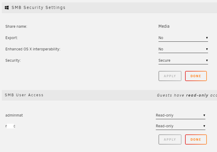

Ok something is way broken here. After I finished moving some files I changed my 'Media' share to 'Export: No' and changed the user permission to 'Read-only', applied the changes and I can still access it from my Windwos 10 PC on the network and can even write to the Media share. With the settings below I can still add files!
This is scary. I have no idea now what has access to my shares if I can't even block it in the unRAID WebUI.
Edited by adminmat
Ok i figured out the issue. If you change the share to 'Export: No' and hit Apply FIRST, and then you change the permission field to 'Read-Only', the change does not take effect and it leaves the share open and unsecured.  So you have to FIRST change the User Access value THEN change the SMB setting. Wow.

Curious if you guys try this what result you get? Try changing the Export setting to No first, click apply. then change the User access to read-only, click apply and test to write to the share.
@Frank1940 can confirm that I closed windows explorer, reopened it and can reproduce results.
Another strange thing: I added another share to test this on my laptop. I realized to reproduce the results above you have to grant Read/Write permissions to both my desktop and laptop. Then change the Export to 'No'. Then both clients to 'Read-only'
If I just grant access to one client then change the Export to 'No' it wont reproduce.
