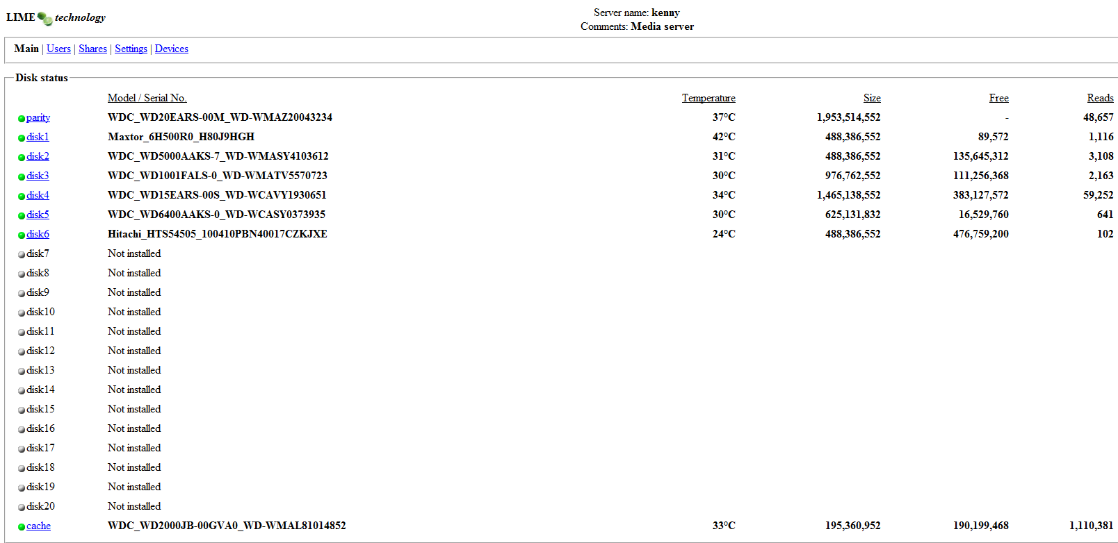

On another note, the interface now shows all 20 hard drives even if they're not installed:
index.php?action=dlattach;topic=9029.0;attach=4719;image

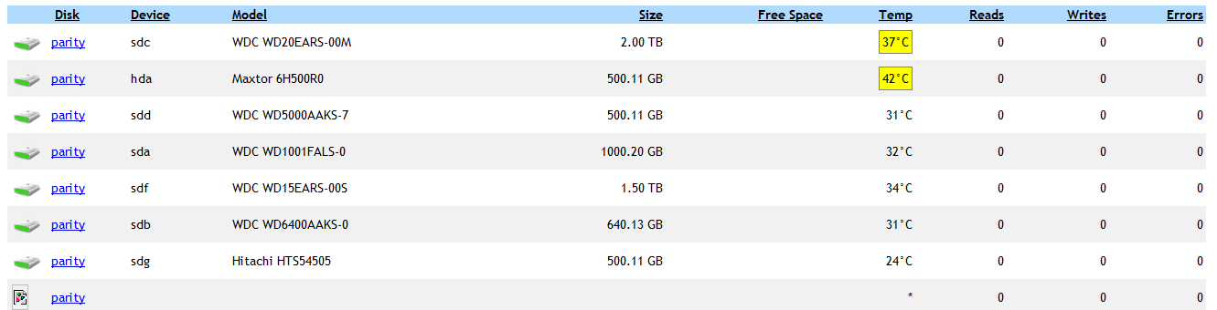

Something else might have changed also because now BubbaQ custom interface shows all disks a "parity":
index.php?action=dlattach;topic=9029.0;attach=4717;image

updated to 4.6rc1.  status messages are now gone.  the .custom folder in my cache drive also appeared again in my disk 2 drive.
I set up a test case where I created /mnt/cache/.custom and put a file in there.  Then clicked on 'Move Now' button on the Shares page.  The mover did not move anything.
Please do something similar, let me know if files got moved, and post the system log.
I deleted the .custom folder from Disk 2, clicked on the button in Unmenu to start the mover.  Nothing was moved since nothing was on the cache drive.
I rebooted the server, the syslog I posted along with the pics above are from the second time it happened.  I started up the server around 4:59pm according to the syslog and at 5:00pm the .custom folder was created on Disk2. At least that is the time shown as it being modified in the screenshot.
Need  me to try it again?
The syslog you posted has no entries in there for 'mover' running.  Could be you have 'mover logging' set to 'No'?  So yes, please put a dummy file in your .custom folder on the cache drive and then invoke the mover & then post the system log.
I don't see how this issue can be related to 4.5.7/4.5.8/4.6-rc1 since the mover script and share file system did not change at all.
If after doing the test above, and the dummy file still gets moved and .custom still gets created on disk2, then I would like you to restore unRaid to pure stock form - ie, no 3rd party add-ons & then repeat the test.
Where is this button in unMenu.  I am not home right now, but you should be using the mover button in the defualt unRAID gui.
There is no button in unMENU.  (unless he added one)  I think he intended to write unRAID.
I'm sorry, I meant unRaid in the Shares tab.
It just did it again.  It seems to be a Sickbeard issue as the only files that get moved are the cache and the logs folder.  Nothing is in the syslog.  I deleted the .custom in Disk 2.  I stopped SickBeard and then restarted it. Once it was up and running the .custom folder was created in Disk 2 with the cache and logs folders inside.
Sorry Tom. It was a user error.  It was sickbeard.  I took a look in the config.ini file and the SickBeard Cache was set to be stored in  /mnt/user/.custom/SickBeard/cache  when it should have been /mnt/cache/.custom/SickBeard/cache.
