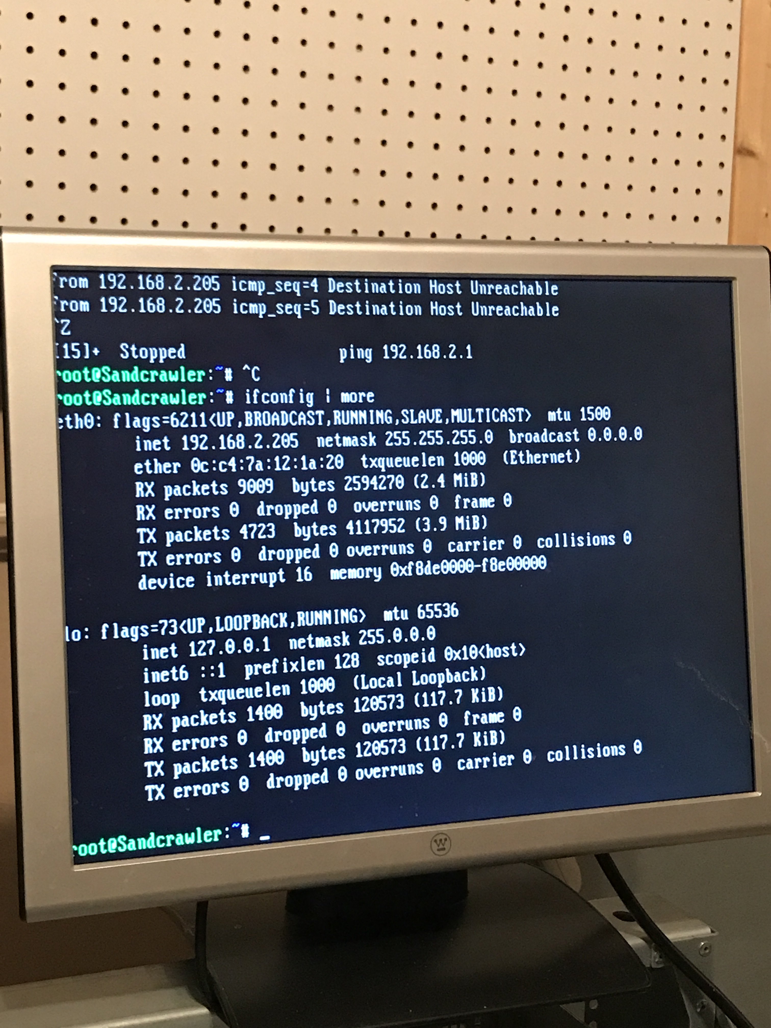

So while you were posting that I decided to get bare bones and disabled my other Ethernet ports, disabled bonding, and disabled bridging and now my GUI is unreachable and my server can’t reach the router. Any thoughts 🤦‍♀️
So after messing up the settings for my network royally I gave up and deleted the network.cfg file from the USB and rebooted the server for default settings. This allowed me to connect via my PC again and get into the GUI where I used a much lighter hand to edit the configuration settings and found this config to be the best for optimum throughput:
