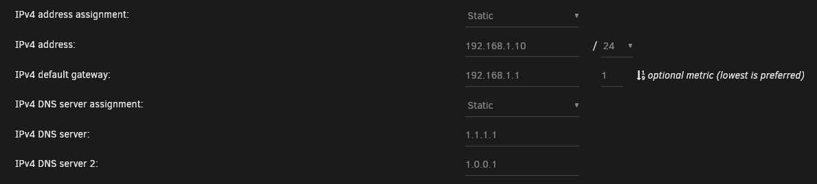

1 hour ago, Physicsking said:
IPv4 Address assignment: Automatic -> Static
IPv4 address: (grey) -> XXX.XXX.X.machine / 24 (where XXX.XXX.X refers to the LAN static address I set on my router)
IPv4 default gateway: (grey) -> xxx.xxx.x.x (router IP I set, non-common)
IPv4 DNS server (grey) -> ????? I don't know what to put here
Here's mine as an example:
Gateway is the router IP address.
You should enter the IP address of the DNS server(s) you want unRAID to use.  Popular third-party DNS are Google (8.8.8.8 and 8.8.4.4) and Cloudflare (1.1.1.1 and 1.0.0.1) as well as others.  Some just set the DNS server to the router IP address which uses whatever the DNS server(s) are as designated by your ISP.
FYI - if you end up setting up Pi-hole in the future, do not enter the Pi-hole IP address as the DNS for unRAID.  It could cause problems.  In your router, you will want to designate the Pi-hole IP address as the primary DNS, but, leave the unRAID DNS set as a third-party or router/ISP IP address.
