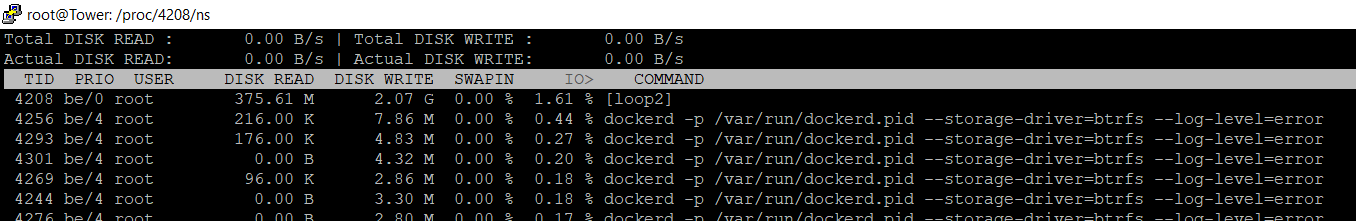

The process loop2 seems to be the one responsible for the writes, the advances docker settings point out this maps to the docker image.
The screenshot below shows 2GB written in just a couple of minutes:

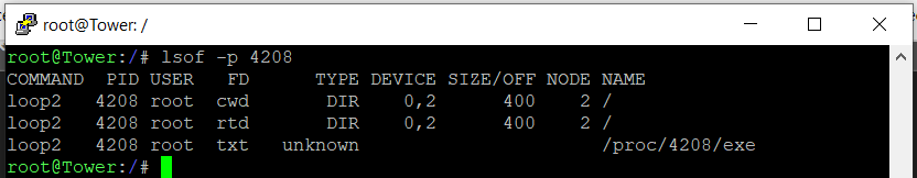

Now lsof on the pid doesn't really give a lot of open files on that PID.

One thing I did notice from the iotop -ao output is that everytime the loop2 process climbes fast in writes, a line as the one below is shown:
-> dockerd -p /var/run/dockerd.pid --log-opt max-size=50m --log-opt max-file=1 --storage-driver=btrfs --log-level=error

8 hours ago, Moz80 said:
So now with 24 hours of iotop data, i have 120GB on loop2 (much better than the TB's i would have had on the official plex container)
Interestingly I can see a few Plex Media Server entries (that seem consistent with some watch activity that occured overnight)
44GB of transmission activity seems a bit up there, there was a single 8GB torrent overnight.
But if all this activity is seperate to the loop2 entry, what exactly is going on with loop2?
Actual DISK READ:       0.00 B/s | Actual DISK WRITE:     350.07 K/s
  TID  PRIO  USER     DISK READ  DISK WRITE  SWAPIN     IO>    COMMAND
 5041 be/0 root       1936.26 M    119.93 G  0.00 %  0.31 % [loop2]
 5062 be/4 root       1968.00 K      3.21 G  0.00 %  0.08 % [btrfs-transacti]
 5110 be/4 root          0.00 B     65.55 M  0.00 %  0.04 % dockerd -p /var/run/dockerd.pid --storage-driver=btrfs --log-level=error
 5090 be/4 root          4.00 K     75.10 M  0.00 %  0.03 % dockerd -p /var/run/dockerd.pid --storage-driver=btrfs --log-level=error
 5112 be/4 root          4.00 K     72.13 M  0.00 %  0.03 % dockerd -p /var/run/dockerd.pid --storage-driver=btrfs --log-level=error
 5115 be/4 root         16.00 K     79.57 M  0.00 %  0.03 % dockerd -p /var/run/dockerd.pid --storage-driver=btrfs --log-level=error
 5114 be/4 root         24.00 K     67.71 M  0.00 %  0.03 % dockerd -p /var/run/dockerd.pid --storage-driver=btrfs --log-level=error
 5109 be/4 root        212.00 K     80.83 M  0.00 %  0.03 % dockerd -p /var/run/dockerd.pid --storage-driver=btrfs --log-level=error
 5086 be/4 root          0.00 B     67.98 M  0.00 %  0.03 % dockerd -p /var/run/dockerd.pid --storage-driver=btrfs --log-level=error
 9424 be/4 root        484.43 M     54.46 M  0.00 %  0.03 % python Tautulli.py --datadir /config
 4706 be/4 root          0.00 B      0.00 B  0.00 %  0.03 % [unraidd4]
 5075 be/4 root         48.00 K     58.54 M  0.00 %  0.03 % dockerd -p /var/run/dockerd.pid --storage-driver=btrfs --log-level=error
 5120 be/4 root         20.00 K     81.87 M  0.00 %  0.03 % dockerd -p /var/run/dockerd.pid --storage-driver=btrfs --log-level=error
 5123 be/4 root         52.00 K     64.18 M  0.00 %  0.02 % dockerd -p /var/run/dockerd.pid --storage-driver=btrfs --log-level=error
 5119 be/4 root        224.00 K     51.89 M  0.00 %  0.02 % dockerd -p /var/run/dockerd.pid --storage-driver=btrfs --log-level=error
 5107 be/4 root         12.00 K     60.95 M  0.00 %  0.02 % dockerd -p /var/run/dockerd.pid --storage-driver=btrfs --log-level=error
 5087 be/4 root         48.00 K     55.74 M  0.00 %  0.02 % dockerd -p /var/run/dockerd.pid --storage-driver=btrfs --log-level=error
 7538 be/4 nobody       44.87 G   1104.00 K  0.00 %  0.02 % transmission-daemon -g /config -c /watch -f
 8870 be/4 nobody      488.26 M      2.27 M  0.00 %  0.02 % mono --debug /usr/lib/sonarr/NzbDrone.exe -nobrowser -data=/config
 5113 be/4 root          0.00 B     26.85 M  0.00 %  0.01 % dockerd -p /var/run/dockerd.pid --storage-driver=btrfs --log-level=error
 8267 be/4 nobody        3.07 G     20.00 K  0.00 %  0.00 % Plex Media Server
 8268 be/4 nobody        3.02 G     12.00 K  0.00 %  0.00 % Plex Media Server
 8869 be/4 nobody        3.51 G     27.51 M  0.00 %  0.00 % mono --debug /usr/lib/sonarr/NzbDrone.exe -nobrowser -data=/config
 5108 be/4 root          0.00 B      4.16 M  0.00 %  0.00 % dockerd -p /var/run/dockerd.pid --storage-driver=btrfs --log-level=error
 4865 be/4 root        252.00 K     67.11 M  0.00 %  0.00 % [btrfs-transacti]
 8952 be/4 nobody       86.22 M      7.18 M  0.00 %  0.00 % mono --debug /usr/lib/radarr/Radarr.exe -nobrowser -data=/config
28612 be/4 root         90.55 M      0.00 B  0.00 %  0.00 % homebridge
31972 be/4 root         15.64 M   1756.00 K  0.00 %  0.06 % shfs /mnt/user -disks 63 2048000000 -o noatime,allow_other -o remember=0
32221 be/4 root         11.69 M   1528.00 K  0.00 %  0.06 % shfs /mnt/user -disks 63 2048000000 -o noatime,allow_other -o remember=0
 8868 be/4 nobody       78.38 M   2040.00 K  0.00 %  0.00 % mono --debug /usr/lib/sonarr/NzbDrone.exe -nobrowser -data=/config
 8953 be/4 nobody       79.08 M   1432.00 K  0.00 %  0.00 % mono --debug /usr/lib/radarr/Radarr.exe -nobrowser -data=/config
 3728 be/4 root          4.11 M    352.00 K  0.00 %  0.14 % shfs /mnt/user -disks 63 2048000000 -o noatime,allow_other -o remember=0
 5076 be/4 root         76.00 K    252.00 K  0.00 %  0.37 % shfs /mnt/user -disks 63 2048000000 -o noatime,allow_other -o remember=0
 8160 be/4 nobody      298.57 M    624.00 K  0.00 %  0.00 % Plex Media Server
 9133 be/4 nobody      781.49 M   1476.00 K  0.00 %  0.00 % mono --debug /usr/lib/lidarr/Lidarr.exe -nobrowser -data=/config
 9134 be/4 nobody      317.68 M   1300.00 K  0.00 %  0.00 % mono --debug /usr/lib/lidarr/Lidarr.exe -nobrowser -data=/config
 9135 be/4 nobody      212.10 M   1568.00 K  0.00 %  0.00 % mono --debug /usr/lib/lidarr/Lidarr.exe -nobrowser -data=/config
 5077 be/4 root        236.00 K    140.00 K  0.00 %  0.28 % shfs /mnt/user -disks 63 2048000000 -o noatime,allow_other -o remember=0
28633 be/4 root         16.68 M      0.00 B  0.00 %  0.00 % homebridge-config-ui-x
 8954 be/4 nobody       77.48 M   1108.00 K  0.00 %  0.00 % mono --debug /usr/lib/radarr/Radarr.exe -nobrowser -data=/config
 8638 be/4 nobody        2.34 M     32.00 K  0.00 %  0.00 % tint2 -c /home/nobody/tint2/theme/tint2rc
 4324 be/4 root          6.19 M      8.28 M  0.00 %  0.12 % qemu-system-x86_64 -name guest=Windows 10,debug-thread~n=deny,resourcecontrol=deny -msg timestamp=on [worker]
 4931 be/4 root          5.45 M    128.00 K  0.00 %  0.18 % shfs /mnt/user -disks 63 2048000000 -o noatime,allow_other -o remember=0
28613 be/4 root        428.00 K      0.00 B  0.00 %  0.00 % tail -f /dev/null
18758 be/4 root        948.00 K     11.84 M  0.00 %  0.00 % [kworker/u12:3-btrfs-scrub]
 4922 be/4 root       1608.00 K    104.00 K  0.00 %  0.15 % shfs /mnt/user -disks 63 2048000000 -o noatime,allow_other -o remember=0
 9423 be/4 root          2.70 M    764.00 K  0.00 %  0.00 % python Tautulli.py --datadir /config
27586 be/4 root        110.12 M     68.00 K  0.00 %  0.00 % python Tautulli.py --datadir /config
 9441 be/4 root          6.93 M    244.00 K  0.00 %  0.00 % python Tautulli.py --datadir /config
 8114 be/4 root          0.00 B    304.00 K  0.00 %  0.00 % containerd --config /var/run/docker/containerd/containerd.toml --log-level error
 8415 be/4 root          9.79 M    544.00 K  0.00 %  0.00 % python /usr/bin/supervisord -c /etc/supervisor.conf -n
24792 be/4 root        110.03 M     64.00 K  0.00 %  0.00 % python Tautulli.py --datadir /config
I see you’re using the btrfs storage driver.
loop2 activity will probably related to this open Bugreport.
Hey mate, absolutely, I found and bookmarked that last night on my ipad, I guess that's where the discussion on this is happening now. I'll have a good read through and see where things are up to!
Thanks for all your efforts thus far!
