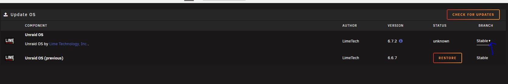

Cannot switch from Stable to Next 6.7.2 --> 6.8rc5
I cannot seem to switch to next version under http://tardis.localdomain/Tools/Update

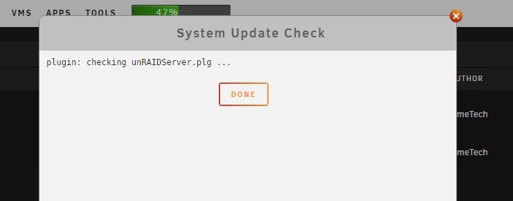

I click the pull menu and select next , and flicks back to Stable , I also clicked Check for updates and it only displays "plugin: checking unRAIDServer.plg ..." Done button.

Is the server's system clock reasonably accurately set? Your diagnostics might shed some light.
I checked that .. its on the ball ok !
I don't see anything wrong. You could upgrade manually. Get the zip file from https://s3.amazonaws.com/dnld.lime-technology.com/next/unRAIDServer-6.8.0-rc5-x86_64.zip and unzip it. You'll need to shut down your server can transfer the USB flash to a PC. I'd check the device for filesystem errors first (their presence could explain the failure to update via the GUI), then copy all the newly unzipped files that begin with "bz" into the root of your USB flash, replacing the existing files of the same name. Wait for it to finish, then eject the flash. Then use it to boot your server.
Apologies , my PFSense was the issues --> Went to SSL Man In the Middle Filtering HTTPS/SSL InterceptionEnable SSL filtering.turned that off

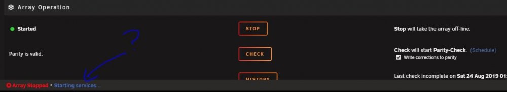

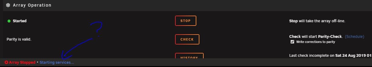

working now, I did notice the Array stopped * Starting Services  but down the bottom it was saying starting ..
That seems to be an issue that a number of people have reported. It might be an unwanted interaction with a plugin. I haven't seen it myself. There's a discussion about -rc5 here, if you want to follow it:
I started seeing that yesterday im not using PFSense but all Ubiquiti gear....a stop and start of the array cleared it up both times
A PFSense configuration issue was responsible for causing @Rhysee's problem with updating the OS. The Array Stopped * Starting services message is cosmetic but seems to be caused by a plugin incompatibility and is unrelated to PFSense.
