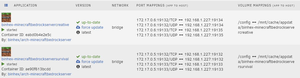

I'm trying to set up both a survival and creative server dockers.  I'm able to get into the Survival docker at port 19132 on Android and iOS.  My issue is that I can't get into the Creative docker at port 19134 on either Android or iOS.  Do see anything wrong with my port mappings?
