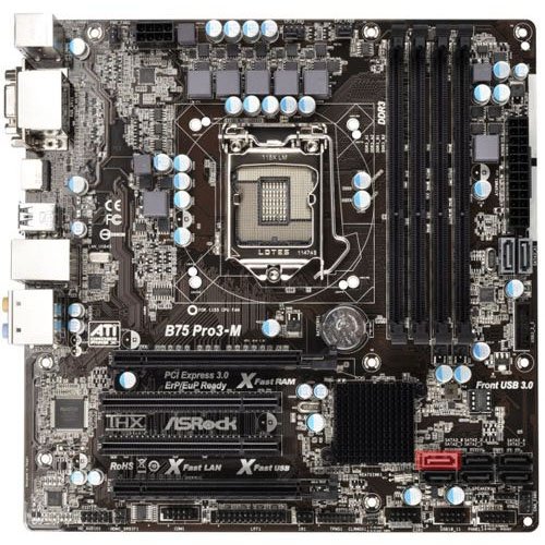

ASRock B75 pro3m with celeron g1610 @ 2.6ghz

EDIT: just realized that my current motherboard has 8 SATA ports on board (5 SATA 2.0 and 3 SATA 3.0) so maybe eliminating the 2ea Supermicro SATA cards is the answer because the 8 onboard sata ports should be plenty with the 10g drives. Now, I'm really confused!

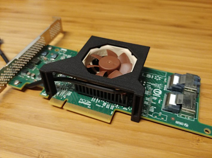

4GB are ok but i recommend a minimum of 8GB - and avoid the SUPERMICRO AOC-SAS2LP-MV8 - this controller is known to make problems.
Use a SLI 9207-8i or similar.

My current MB will support an i5 or i7 processor, so I could go that route with a bit more ram and be set for a while I would think.
I am using the same MB since 2013 - no problems with it.

Does the LSI SAS 9207-8i use the same breakout cables as the supermicro card?
Also, is is just a plug and play process to remove the supermicro, and install the LSI SAS 9207-8i? Does it matter which cable goes to which drive or will unraid sort that out on it's own?

The LSI has 2x Mini-SAS SFF-8087 connectors - i dont know the connectors of the supermicro, but google (or the manual) will tell you.
Usually you can just swap it - both controllers are HBAs.
unRAID identifies the HDDs over the serialnumber - so it doesnt matter where to connect.
I did my change few weeks ago - 2x Adaptec 1430SA against the 9207-8i - straight forward and pretty simpel.
Be aware: The LSI 9207-8i needs active cooling of 200lfm because its a Server-HBA.

Important: Connect the cache-SSD at the light gray SATA-III-port (Intel) on the mainboard - dont use the ASM1061 for the SSD - they are only connected over PCIe x1.

I have just purchased the LSI SAS 9207-8i and the Noctua NF-A4x10 FLX to cool it. Looks like the fan will just screw into the heatsink fins of the card, unless you use that fancy bracket that Zonediver posted a picture of but I can't find that for sale anywhere.
So, next week, I'll replace the AOC-SAS2LP-MV8 with the LSI SAS 9207-8i w/fan, and make sure everything still works.

You can change both drives - the SATA-Port doesn't matter - unraid indentifies the disks over the serialnumber.
And by the way: You have 16 SATA-ports:
6 on the Intel Chipset
2 on the ASM1061 and
2x4 on the LSI-controller.
