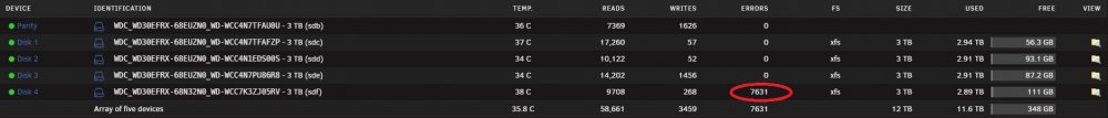

Image of disk errors after 0.1% of parity check 😨, been saying 4 errors last 24 hours.
Was hoping it may be a data cable if continuous error reads all of a sudden
I've stopped the Array until the new HDD arrives tomorrow.
