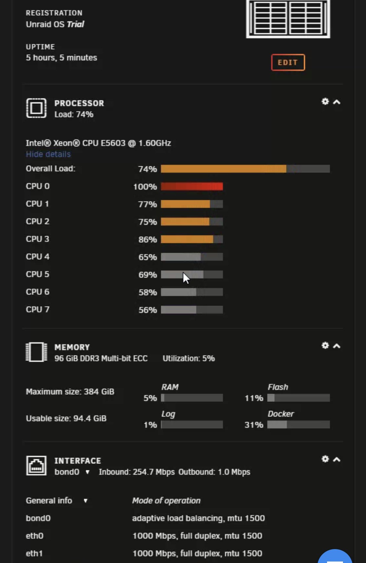

So I just threw together my old NAS and put unraid on it to try it out and see how I like it and I haven’t touched the 96GB of RAM, the drive speed and NIC speeds are all being limited by something and im pretty sure it’s my two old CPUs. They are E5603s and with sonarr, radarr, plex, sabnzbd, and a half dozen other dockers running it gets sluggish when I go to stream. What’s a cheap-ish upgrade for those two CPUs that will be plug and play with my LGA1366 chipsets?

A single Xeon E5603 has a passmark rating of ~2300 - two of them are slower then an old i3-4130 (passmark ~5300).
Single Thread Rating: 675 passmarks. This platform is outdated.
Not enough power for all the work.
For comparison: My "old" i7-3770 from the year 2012 has a Single Thread Rating of 2068 and an overall passmark of 10005.
I would at least recommend an i5-8400 or something similar - but you have to change MB and RAM too...

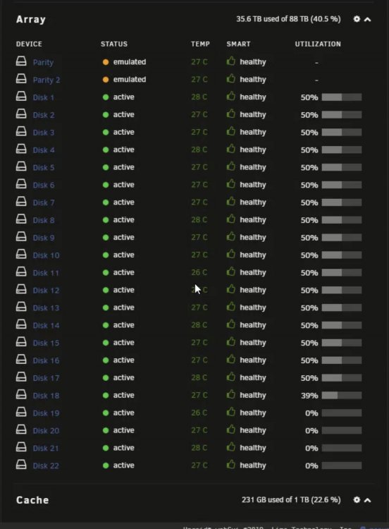

Nobody is going to point out that he's running two emulated parity drives?
That's got to slow you down a bit, I'd imagine, since writes are going to spin up and read the whole array.
Am I wrong?
Edited by SnickySnacks
Am I wrong?
Technically they are not emulated, they are being synced, but yes, performance will be very noticeably impacted, especially if still on v6.7.x, since all disks are being read do sync parity.

Yes the parity is still being built I know that will effect performance but I front loaded all the data onto the array prior to adding the parity disks to increase the speed which I could transfer onto the array. Before I added the two parity drives that are now building into the pool I was already having CPU in the red quite a bit just running the dockers and streaming simultaneously which is where I decided to investigate how crap these CPUs were. I found a website that shows all the LGA1366 socket CPUs and it looks like the two 5680s I found are the second best CPU (5690s being the best) that I can get. I am going to buy those two CPUs for 20 bucks each and see what the difference is. With the passmark score being 3x higher should I expect 3x more CPU performance or is it not linear?

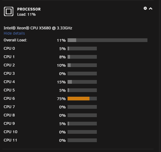

just to wrap the thread up I did the swap today after I got more thermal paste and its been amazing I am seeing amazing numbers compared to the old CPUs so thank you all
