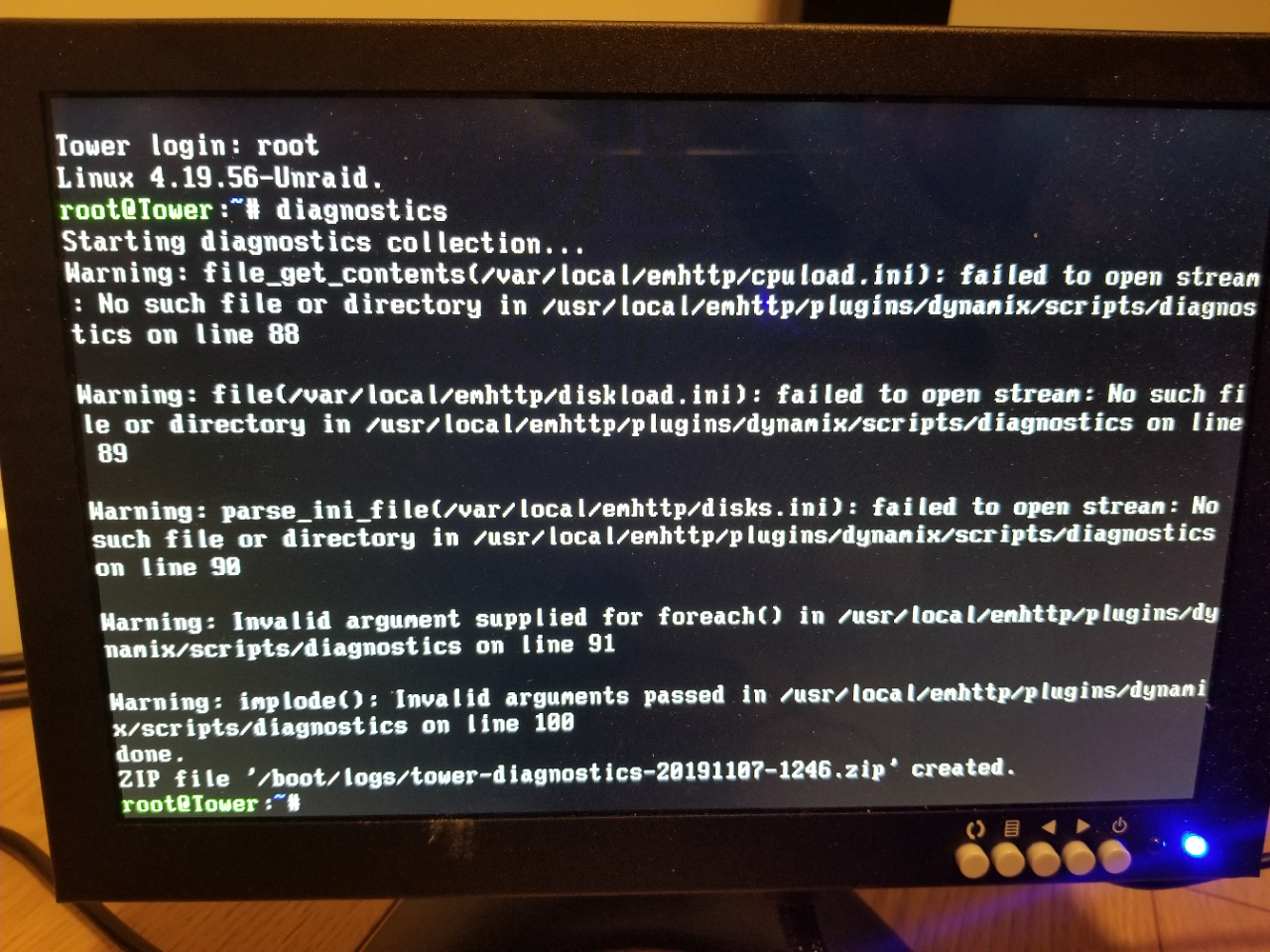

OK... so not a great result. Frank, I did as you mentioned above and I got the following screen.

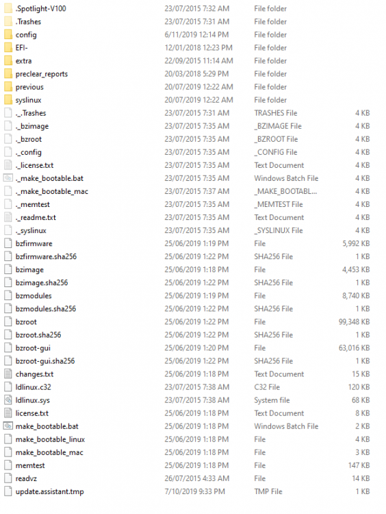

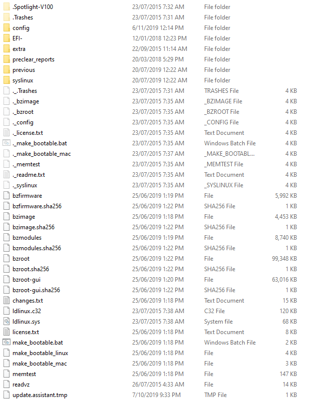

Also, NO log file was produced. I have included 2 pictures. 1 from the server after I typed Diagnostics, and the second is from the USB after I removed it to find the log file. Capture.thumb.PNG.da0c0fd055750dff6c354bb290e6327f.PNG
The first picture with the file listing of your flash Drive shows that you have some serious issues with it.  The files and directories that begin with a <dot> (.) should not be there.  (It appears from the dates involved that you attempted to update your Unraid version and it failed...) I would suggest that you pull it, make a copy of its contents, and run chkdsk on it.
The files beginning with a dot were placed there by a computer running macOS. They are harmless. The lack of a logs folder suggests the flash device is corrupt.

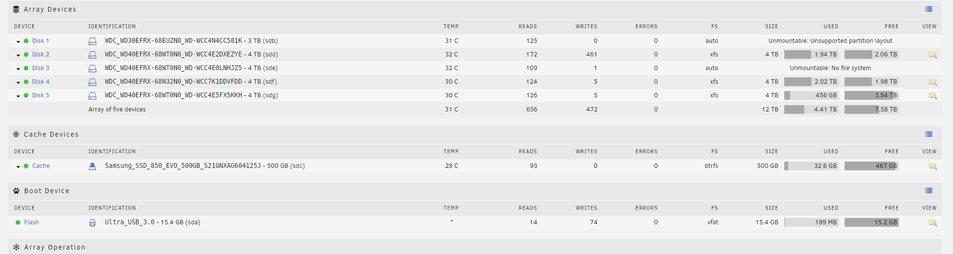

Capture.thumb.PNG.b733b18e647aa8b3488e8189875c2305.PNGOK... All good and I believe I know which is the parity drive.
But I'll include the picture here, just to confirm.
SDE is the PARITY drive correct?
Thanks,
Morten
Edited by mort78
Yes

At the moment of this screen shot, most likely. DO NOT RELY ON SD? DESIGNATIONS. They can and will change if you move things around.
The correct way to designate this is the drive with serial number ending in Z5 is probably your parity drive.
The drive ending in 1K, your 3TB drive, are you expecting that to have files on it? Currently it's not mounting, is it the "new" drive that you planned to add? If so, I wouldn't add it until you actually need the space. Extra drives that you aren't using are a liability, as all drives are used to emulate a missing drive. Even empty drives can torpedo a failed drive recovery.
