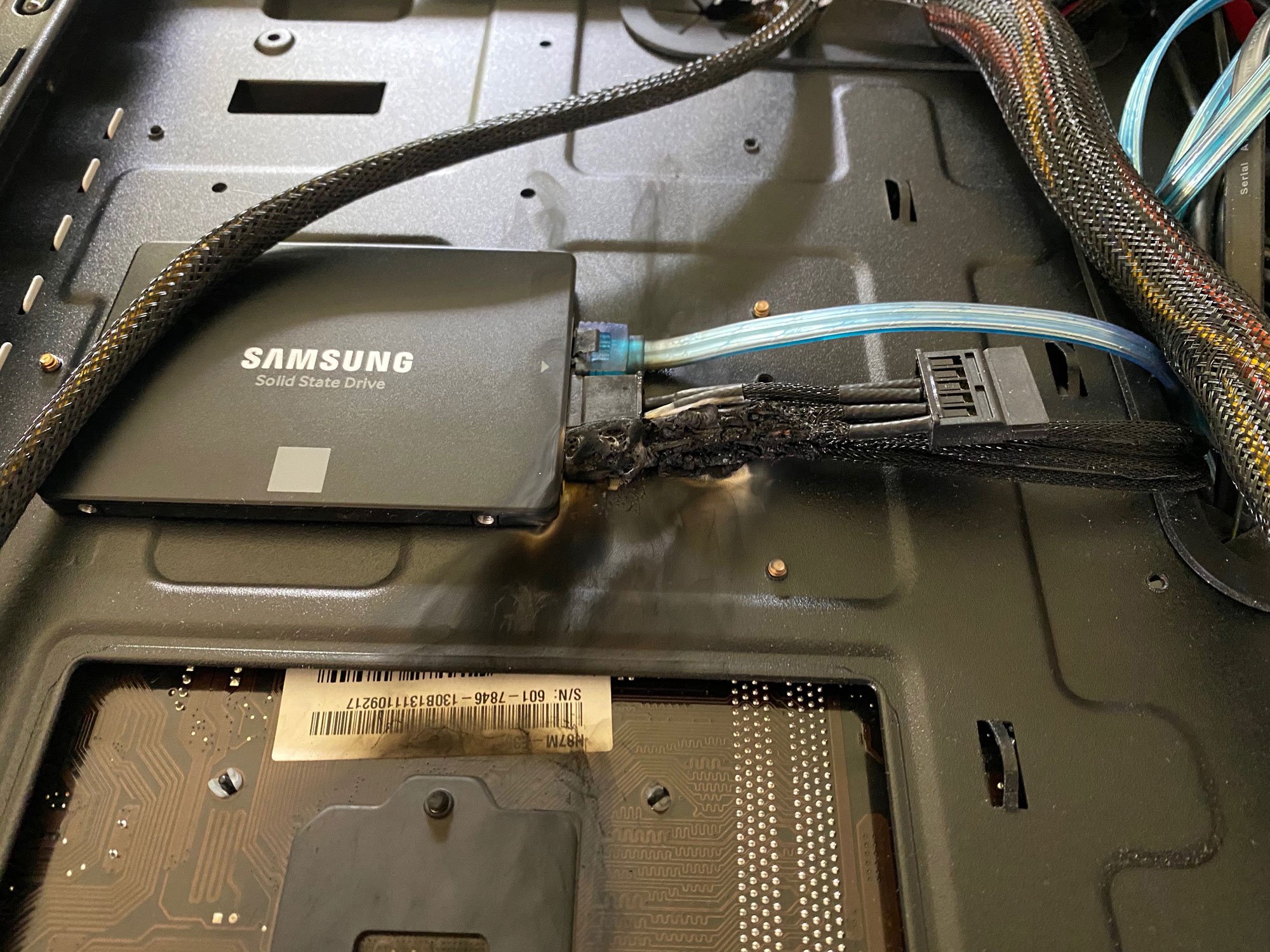

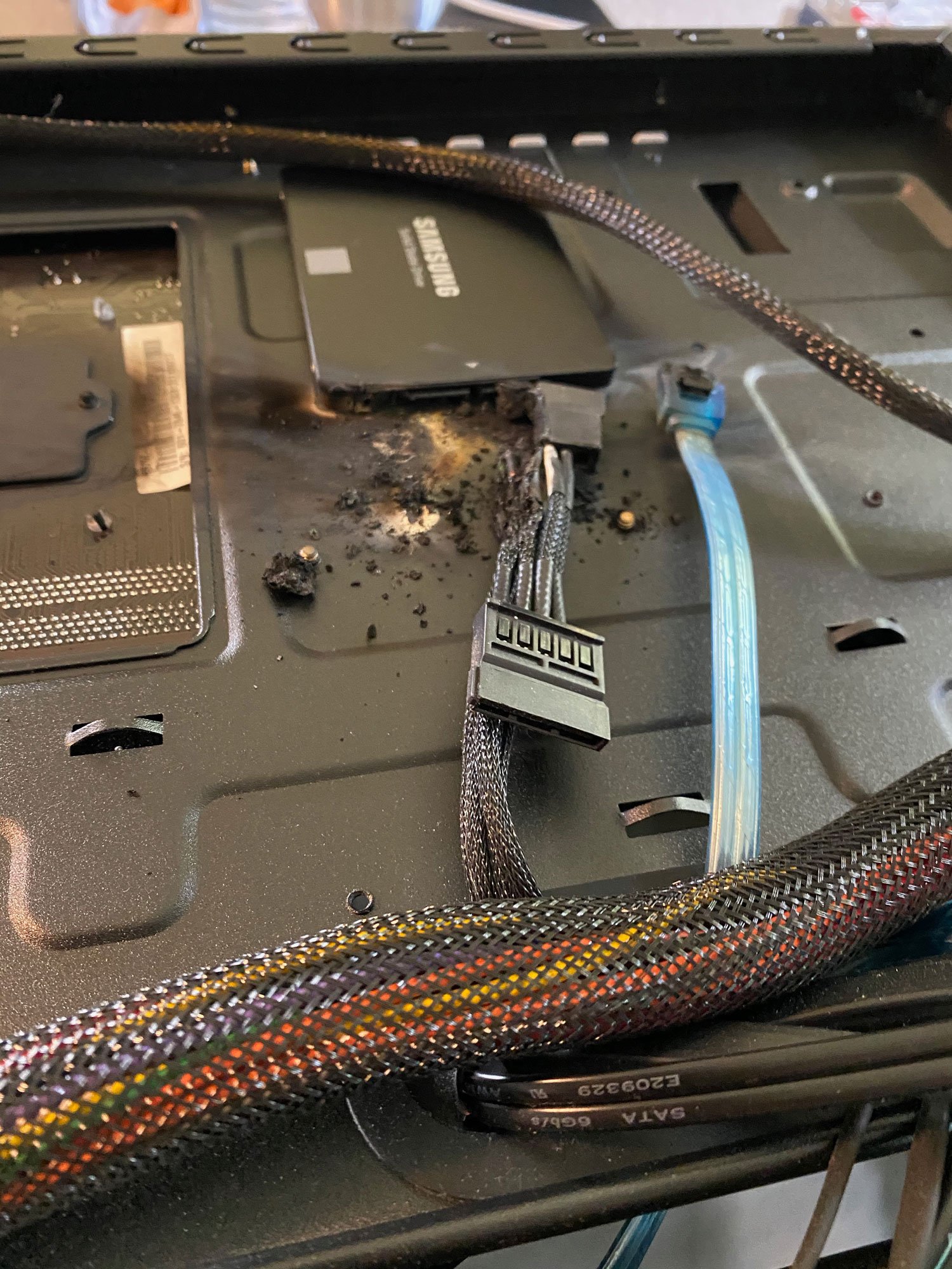

Well... It wasn't the power supply and wasn't necessarily the motherboard. Check the pics. The power connector to my cache drive MELTED. There are scorch marks on the bottom of the MB as well. My only hope now is that there was a recent backup of the app data directory and stored on the array. There should be. I can't remember how I have that configured.
What sucks here, I mean besides THIS, is that this was a very recently purchased and upgraded drive. Obviously toast now and the one thing I didn't order a replacement for. I hope like hell I can restore the data from a backup.
IMG_0022.thumb.jpg.040024e31a321604af5f3cb06f1dc8aa.jpgIMG_0021.thumb.jpg.79d584363c9d4d89a96830f19c2e4c4d.jpg
Could you take a picture of that area with the SSD removed? My suspicion is that the power supply connector came in contact with a raised portion of the motherboard mounting tray, and the reason it didn't immediately short out when the computer was assembled was that the raised area was painted or coated, and the normal vibration of running caused the coating to chafe off causing a direct short to ground by the 12V or 5V lead.
That would make sense. Maybe when I swapped out the drive a few months back I wasn't careful enough.
The power connecting point on the SSD is completely gone. I pulled everything I could salvage out of it and junked it. I don't much feel like taking the MB off so I can take the SSD off. That was always a PIA with this case. :)
