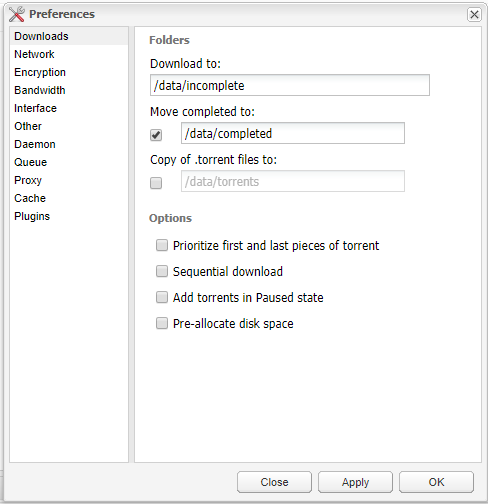

Deluge downloads are set to go to a DelugeData folder which I have specified as a sub folder of appdata.  It does not have to go there, I decided that organizationally, that's where I wanted it.  However this is only half of the equation.  This path will NEVER be used unless I tell the application to use it.
In the Deluge application Preferences/Downloads configuration, I have specified downloads in progress to go to /data/incomplete.  There is NO /data folder on my server, but in the mapping above, I told Deluge to see /data as the host path /mnt/cache/appdata/DelugeData.  Because of this, Deluge now know that downloads in progress should be stored in  /mnt/cache/appdata/DelugeData/incomplete.  When the download is complete it then gets moved to /mnt/cache/appdata/DelugeData/completed.
If I do not tell the application to use the volume mapping I set up in the docker container edit screen, it would just go to whatever it defaults to which, more than likely, is going to result in an application path that end ups inside of docker.img because that is where the actual application lives.  This is why your docker.img file is growing.  Your applications are storing data in docker.img instead of a designated file location on the server.

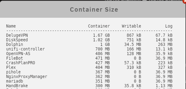

Click the Container Size button at the bottom of the Docker screen.  It shows you how much space is occupied inside docker.img by each docker container.
Look for containers that are unusually large.
Ok from that I think I found the issue.  The Container size of my Zoneminder is 9.06 GB.  I don't think it is growing anymore as it is routed to a unassigned device but there might be some stuff left over from awhile ago.  What is the best way to get rid of of this stuff without messing up the application settings.  It took me awhile to get everything dialed in and would hate to lose all my settings.

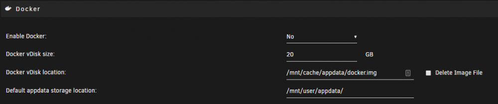

1.  Disable Docker
2. Delete docker.img and recreate it with a 20GB size
3. Enable Docker
4. Go to the Apps tab (Community Applications) and select Previous Apps from the menu in the upper left.
5. Your previously installed docker containers will appear there and you can reinstall them
Note: they will retain all the settings with which they were configured at the time you deleted docker.img
