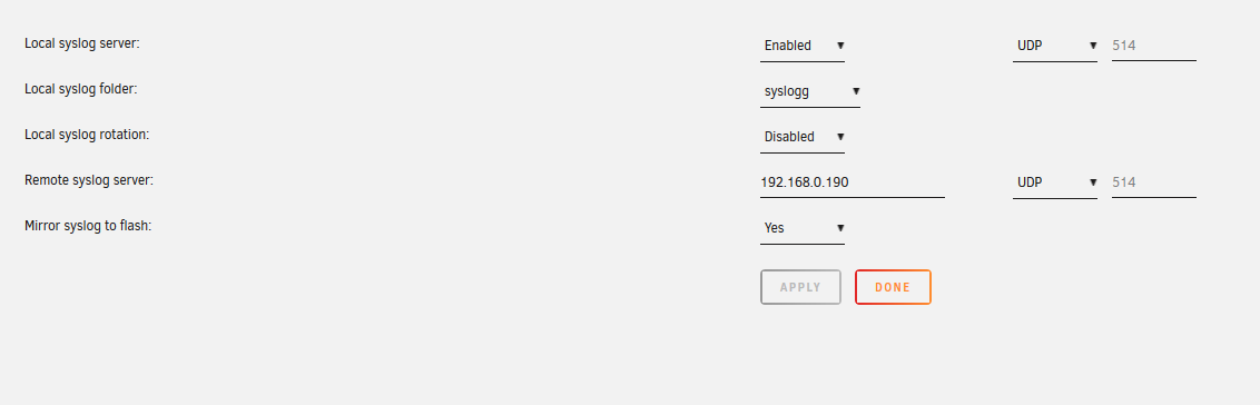

You want to go to Settings -> Syslog Server and set it up to store the syslog to a persistent location so you have a copy that survives a reboot (by default the syslog is only stored in RAM)
Alright. Make a share on another server monut it via SMB on the unraid that stop responding and put into syslogg server?
To keep it simple I would simply put on the Unraid server somewhere (the cache drive if you have one).   There is also the option to mirror it to the flash drive.
Alright! Easy. I do that! :)
Ehm, Ports? Just leave as default?
Edited by zodde
Leave the ports at default.   You only need to fill in the IP address of the Unraid server to make it log to itself.
Okey, lets se if this is correct and then i have to see tomorrow what happend in the syslogg. The server with issue have ip .190. Is this correct then?
Yes.  With those settings there are 2 copies of the syslog information - one on the syslogg share and another on the flash drive.
When you get to the bottom of your problem you will want to disable the option to mirror to the flash to minimise writes to the flash drive.
Thanks!
Yes, absolutly disable this later. Finger crossed its no major issue with hardware. I have spend some money on this one.
Seem that it works and logging now. Thanks again!

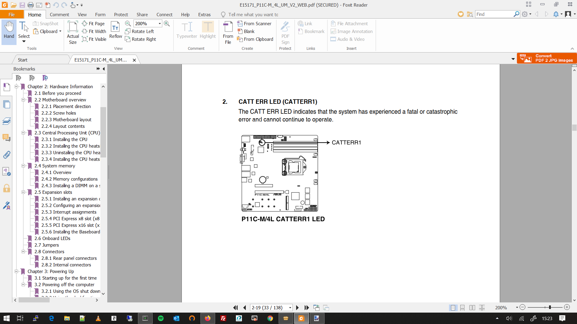

It happend again! And this time I saw a red led light inside so i looked in the manual. Here is a screen of what the led indicates. This is no good..
Edited by zodde
Sounds like hardware to me. If you have multiple RAM sticks I'd pull one at a time and see if the symptoms change.
