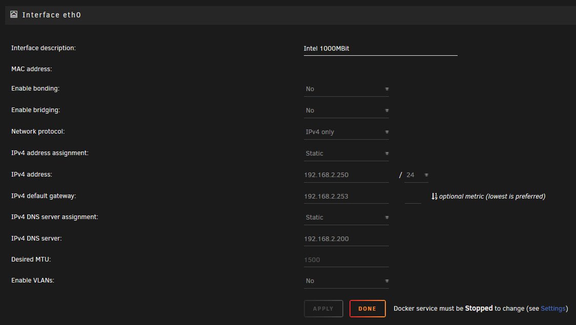

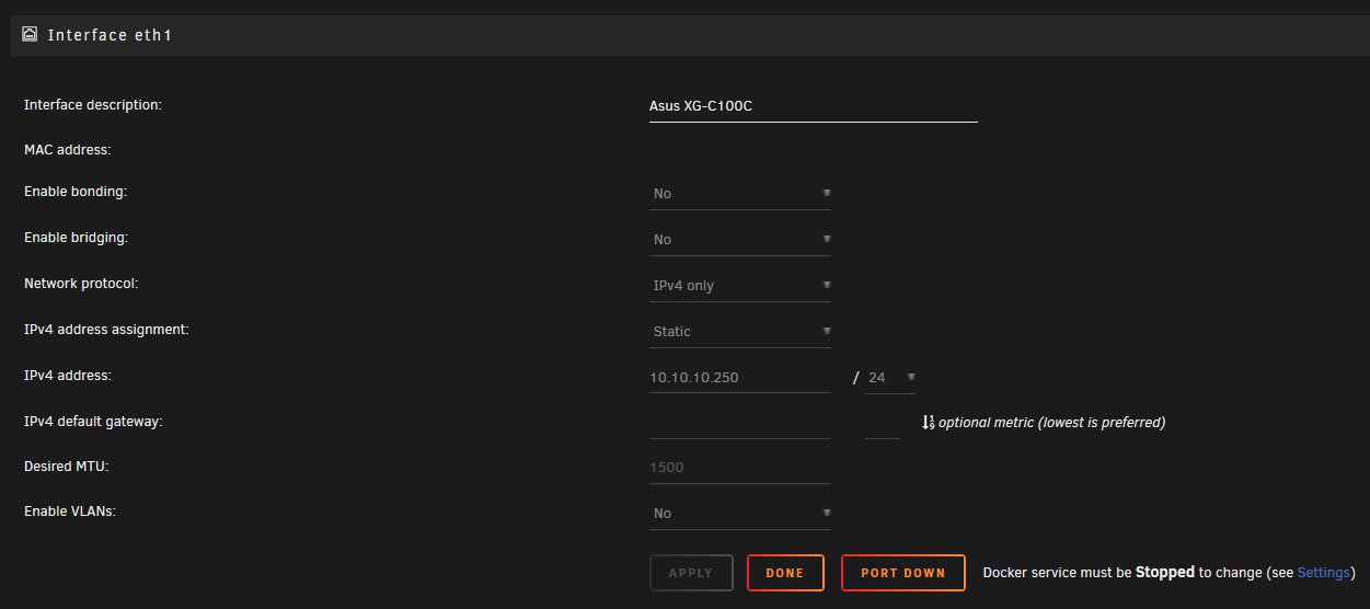

Thank you very much for responding.  The pic included shows my current set up and it works somewhat, but is throwing issues of connecting to update server and getting update info on plug-ins and etc.  I'm sure this whole network setup is not optimal.  Can you suggest the best setup for the two 10gb connections with computers directly and the 1Gb network connection with my network? This is a small network with about 10 computers.  Will never be a very large network.  I really appreciate your time and suggestions.

See the screenshots.
eth0 is the NIC which is connected to the switch (1GBit) with access to the internet (gateway and DNS is set).
eth1 is the connection between the server and the pc (10GBit - no internet access, no gateway and no DNS).
Both NICs have static IPs and eth1 has no DNS or gateway settings because its a peer-to-peer link between both computers.
Your setting is confusing... set "all" NICs on the server side to static and give them a proper IP.
Again: Every NIC needs his own seperated network - so you need 3 adresses in 3 different networks.
