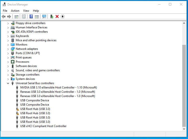

Thus, I decided to purchase the startech pexusb3s44v, I have set the slot to X4, and unraid does not seem to have an issue attaching usbs and appearing on the main tab. Therefore, I moved forward with isolating them from unraid, however there the issue occurs when I pass it through to a VM in Windows 10.
I am trying to have 2 of its controllers for one VM and the other for my second VM. If you could let me know if you have any ideas, as well as, if this is even possible with this card. I just purchased it and have 30 days to return it for a refund, if this card is not compatible.

Drivers installed automatically by windows upon initial boot-up. Have attempted uninstalling and re-installing with the same issue.
Thanks in advance for your help.

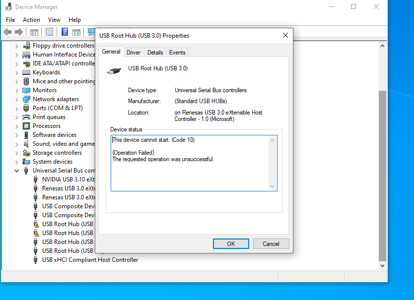

The problem that remains, pertained to Windows 10vm seems unable to start the device, i edited in an image in my original post.
I was wondering if you had any ideas as to why the windows 10 vm can recognize the controllers (renasus), but then this "root hub" that appears along with the renasus controller can't seem to start and prevents windows from seeing USBs devices that I plug in.
