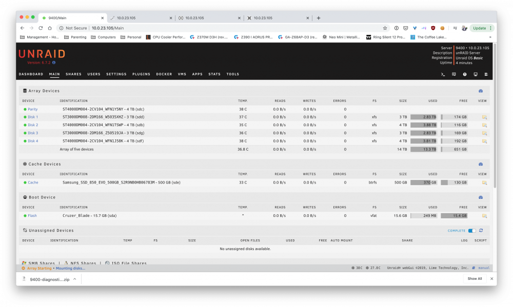

I get the message "Array is starting....mounting disks" status in the status bar, but none of the shares are accessible over SMB, and the VMs and dockers haven't started (their services are unavailable). Here's the screenshot

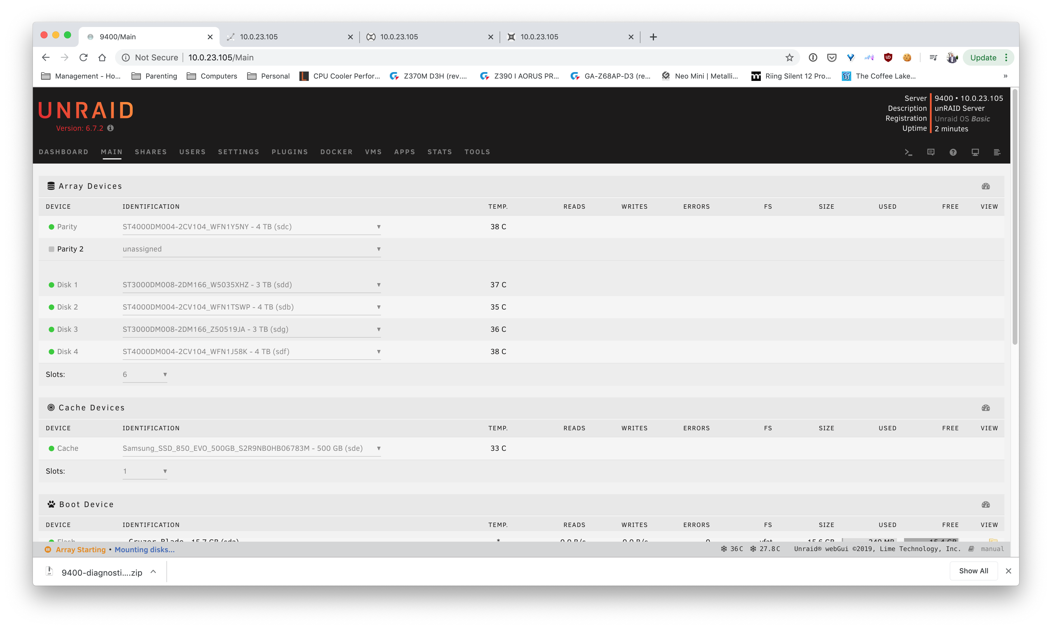

After changing tabs away from MAIN and back again
