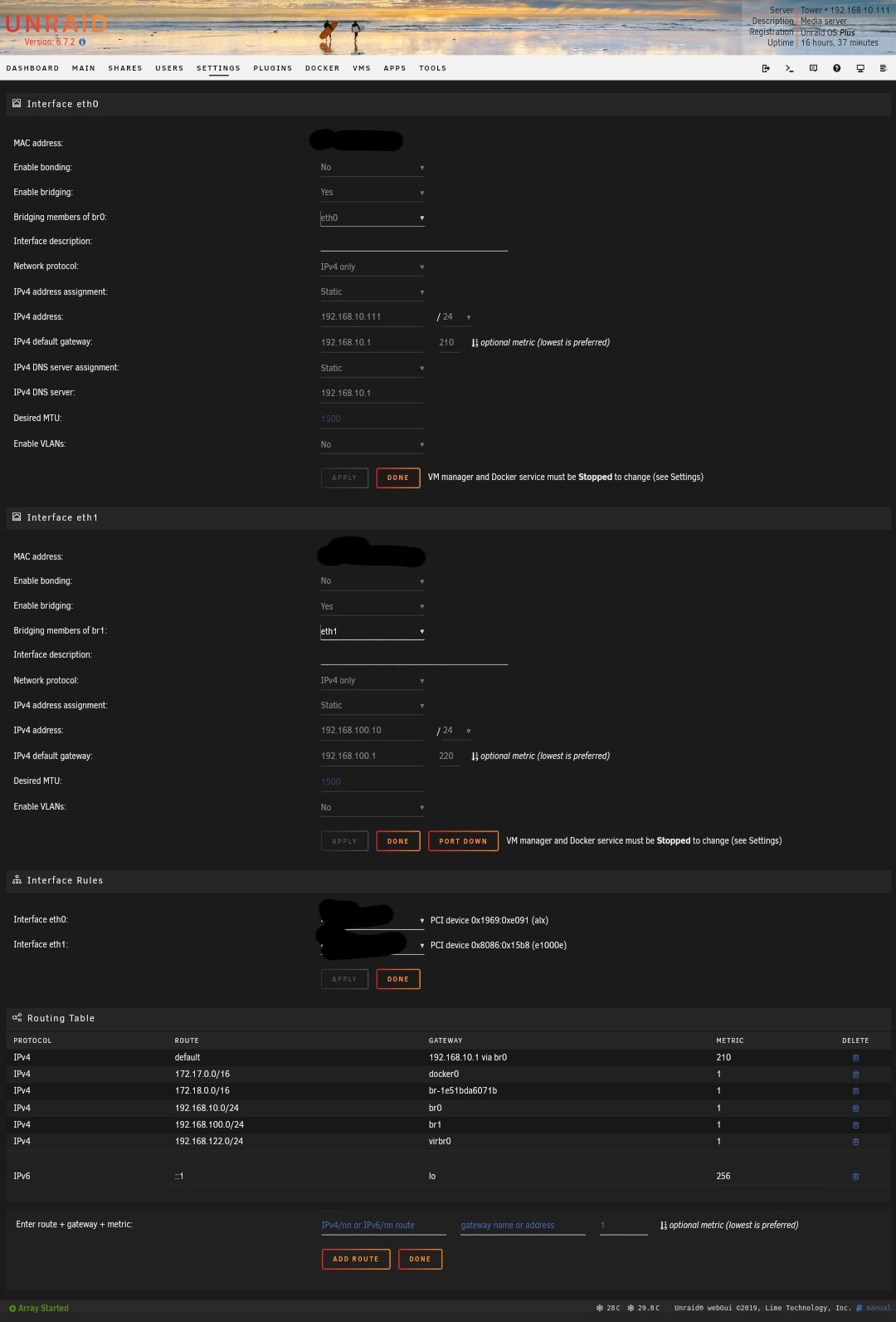

Is it possible to use 2 networks correctly with Unraid?
Have 2 network cards onboard with fixed IP addresses.
VMs and Docker containers are to run via  network br0 with port forwarding
Over the second network br1 other Docker containers are to run over pfsense (with Openvpn Tunnel)
Pfsense runs as a VM on the same Unraid server with its own passthrough network card.
Do not get it that both runs at the same time, either one or the other network is running.
All connections are connected to the same switch.

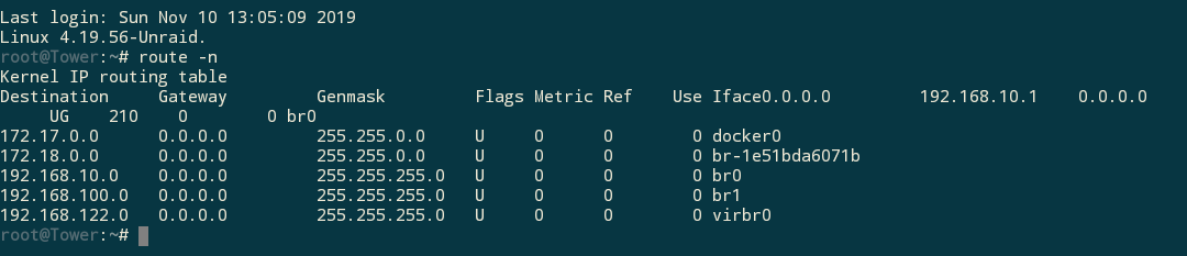

if the standard gateway br0 is set, the containers on br1 are no longer online.
 I've deleted the network config and everything newly set up, and a downgrade to 6.7.2
Do you have any idea how to solve the problem?
