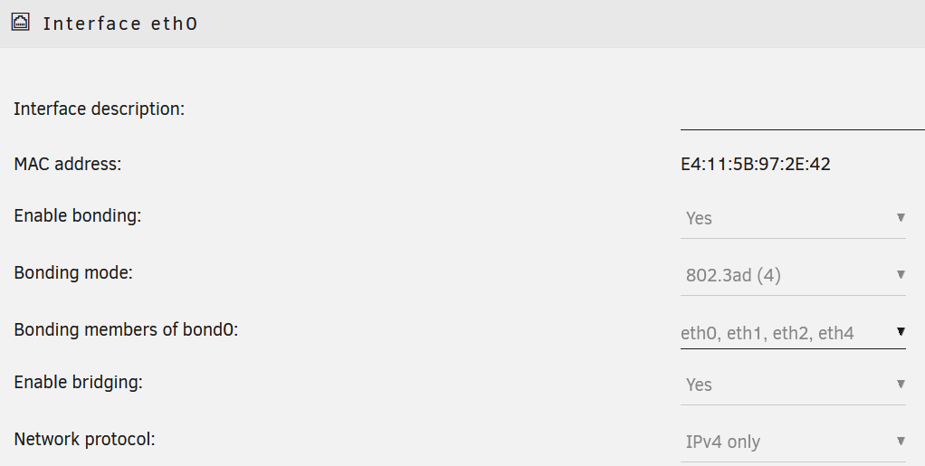

Ok finally got someone to help get me in.  I had to unplug all but one of the cards and move it from the port group on the switch to get in.  Below are my settings.
Your network settings show a bonded interface with 4 members and using LACP. This mode requires a switch which supports LACP too. Did you configure your switch properly (assuming it supports LACP)?
Yes it is a Cisco switch configured with a port channel.
