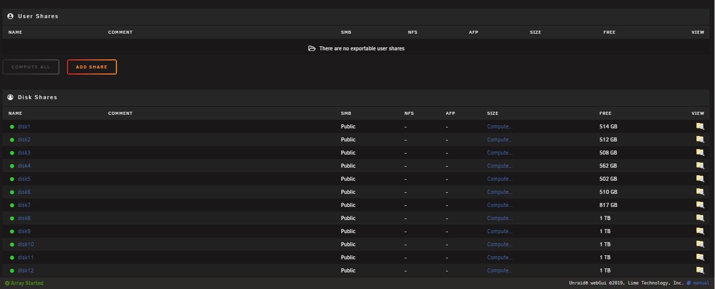

Hi all. Several days ago I had a power loss at my home which killed the power to the server(no BBU yet). Server came back up fine with no noticeable errors but I have no user shares and thus the docker and VM shares are missing so nothing starts up. I can still browse to \\tower and instead of all my shares I see a share for each disk. All the files are there and the random ones I opened are working.

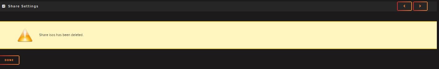

Did some searching on the Google and found some posts with the same symptoms.Following their recommendations, I logged into the terminal on the physical server and typed "mc" t get to a file browser and looked in the config folder for "shares.cfg" it is not there (I think this is the problem but have no idea why it is missing or how to replace it). Next I looked in the shares folder and all my user share .cfg files are there and I can open them in notepad ++. Everything seems fine in each of the files. Then I tried to create a share with the same name as one in the share folder. It gives an error that the share was deleted (picture attached). Next I deleted the share .cfg from the shares folder and tried to create it again with the same result. I completed those same steps in safe mode with the same results.

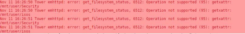

Another post said this was a bug and clean restart with parity check completed fixed the issue. after 16 hours the parity check completed with 0 errors and still no user shares. I attached the errors i see in the log for the shares that are supposed to be there(pic attached).
