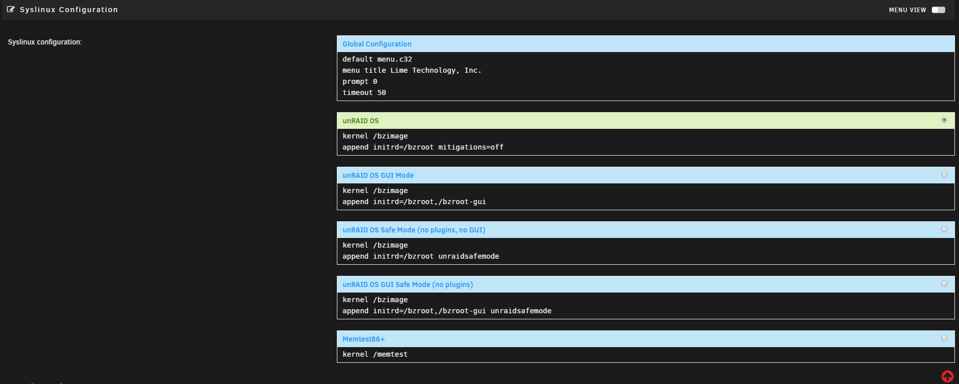

I went to that location and the Unraid os box is already checked. The box is booting to the flash but still defaults to the command line in the blue box. I did notice the text in the area under unraid os (above) is different from what I'm seeing:
kernel /bzimage
append initrd=/bzroot
Above has 'mitigations=off' after bzroot, if that means anything.

The mitigation=off is because I am running a plugin that turns off spectre/meltdown security mitigations for performance reasons.  It is not standard and means nothing in your case.
The unRAID OS option will boot the server to the command line; that's the default..  Being at the command line doesn't mean you can't access the GUI on your network.
If you have a monitor attached to the server and want to see the GUI on that monitor instead of booting to the command line, select the unRAID OS GUI Mode option.
Note this only affects what you see on the screen of any monitor attached directly to the server.  You can always access the GUI from any network connected device on your LAN and you can access the command line from the Terminal option in the GUI.
