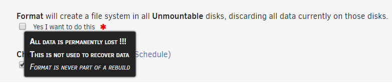

As of late I've been receiving errors on two (Disk 1 & 3) of the 4 hard drives. I've had to rebuild four times already. Disk1 is the only drive with data. I decided to remove the two drives in question and re-use disk2 as disk1. I did a new config preserving the cache. Powered down and removed disk1 & 3. Booted up checked the box stating the parity drive is good. Disk2 now being used as disk1 was then added to the array as disk1 which then needed to be formatted and rebuilt. I used the same passphase to unlock the drive. After 14 hours of rebuild all of my docker containers are gone and so is my data. I have one folder which I assume was moved from cache.

Format is never part of a rebuild, also if you removed disks from the array, parity wouldn't be valid anymore, even if those disks were empty.

I assumed it had to seeing that I was now in theory moving disk2 to disk1's slot.
Format deletes everything on the disk and updates parity accordingly.

Parity is not good if you have made any change to the disk assignments.
You did many wrong things:
-new config is not used to rebuild a disk
-format is never part of a rebuild
-removing disks from the array invalidates parity, even if the those disks don't have data.

I think that mistake is caused more by people not understanding the word "format", a word that everyone seems to think they understand, but really have no idea of what happens specifically. "Format" doesn't mean "get this disk ready to use (again)", whatever that might mean exactly.
Format means "write an empty filesystem to this disk". That is what it has always meant in every operating system you have ever used. Unraid treats that write operation just as it does any other, by updating parity. So after formatting a disk in the parity array, parity agrees the disk has an empty filesystem, and rebuilding a formatted disk from parity will result in an empty filesystem.
