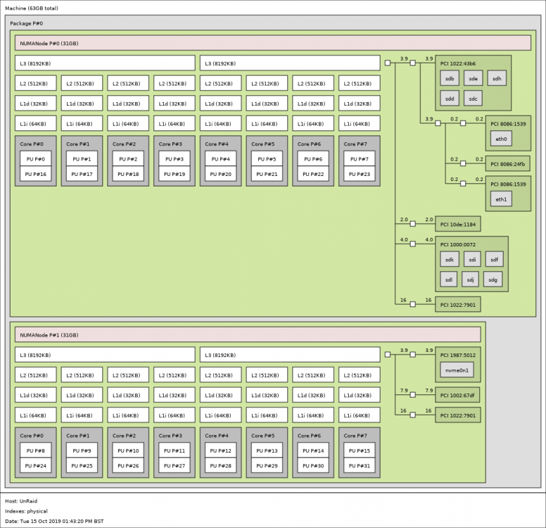

  • I've tried to get my head around Numas and tweaked assigned CPUs a bit, with no real affect.

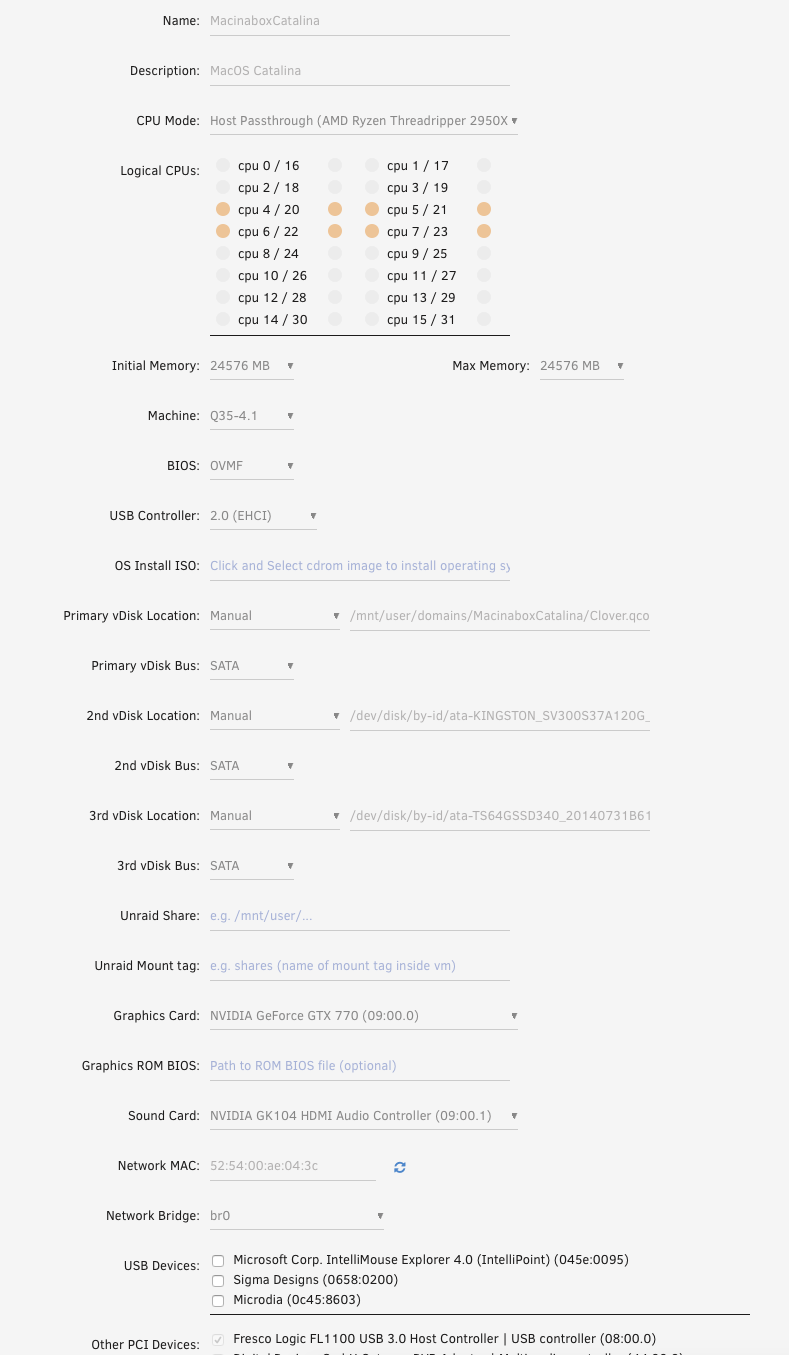

The VM Configuration is;
1818238145_Screenshot2019-11-17at16_59_34.thumb.png.6642594d9d956ec4ed4cce9bdeae282f.png
Which looks like this in XML;

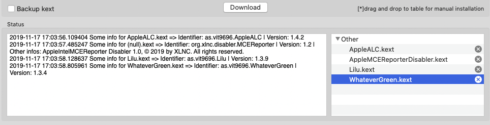

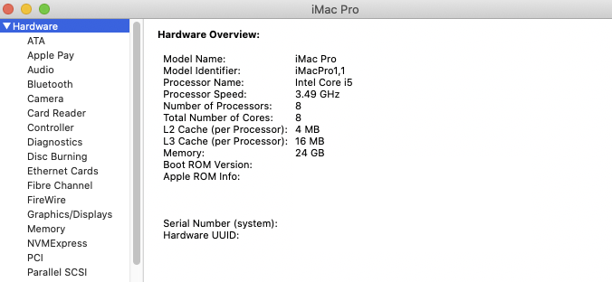

Setup in Clover as iMacPro1,1, with the following kext versions;
Here's some info from the running system;
Very frustrating to have such a dog slow experience. All help & insights appreciated.

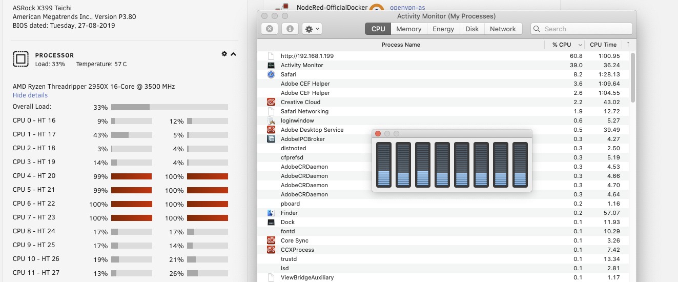

Hmm, so I ran this in unRaid command line;
watch -n 1 grep MHz /proc/cpuinfo
This doesn't look right for a 3.5GHz, does it? CPU under load (VM running benchmakrs on 8x coes);
Guess I need to track this issue down.

Good news, (for me).
I replaced my AIO cooler with an air cooler and unraid now reports idle temps at a positively icy 17 degrees. Booting my VM sees this rise to 18 degrees and cores are no longer throttling.
Geekbench results inside the vm have increased fourfold.
Either my AIO was faulty, or it had been incorrectly fitted. In any case, I now have my expected system perfromance.
Yay!

Good to hear.
Just out of curiosity, your Mac VM, was it just standard MacinaBox + pass through GPU?
19 hours ago, meep said:
I currently have an AIO water cooling solution on the CPU but I really don't trust it.
Please tell me it was an Enermax Liqtech 😂
I had nearly the same issues a year ago after using the 360 from Enermax for 2 months. Remember the first gen gunked up after a couple months? Basically there wasn't any waterflow anymore. One corner of the rad became extremly hot and the CPU under even extrem low loads throttled down to 500-600MHz all the time.
3 hours ago, testdasi said:
Good to hear.
Yes, though I did a lot of manual reconfiguration of the XML as I went along  as my first point of attack was the VM config.
I have other Mojave and Windows VMs, but I decided to focus attention on this one as it's the one the family use and there I was under most pressure to 'fix'
Yup.
 Though I believe it's the VII.
I purchased the CPU, Cooler and Motherboard 'slightly used' and all 3 were connected when i dropped them into my case. I should have checked, of course, but I saw them running before I bought and there were no obvious problems. The AIO might still be good, I just don't want to be pfaffing around with it, especially given the prevalence that the Gen1 had for failing.
There's a BeQuiet Dark rock Pro TR4 in there now and so far, so good. Hopefully the CPU itself did not get too stressed with all of this.
