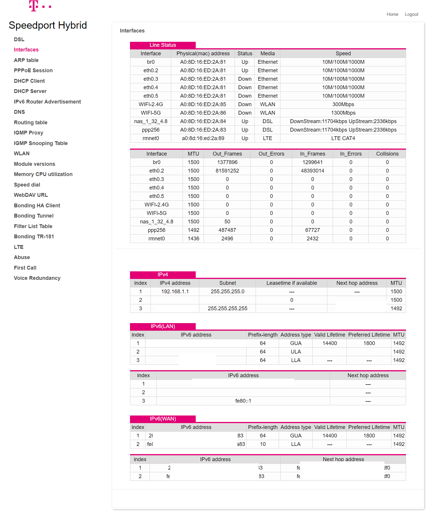

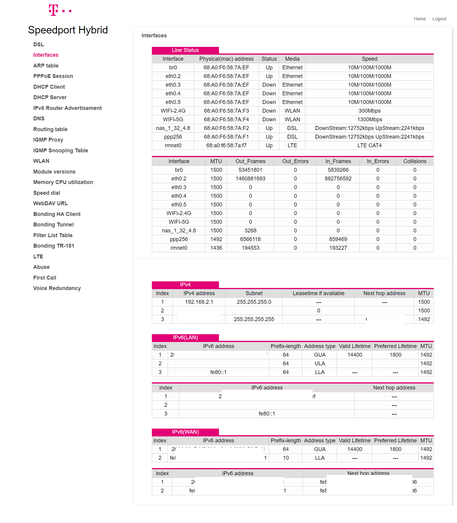

I found statistics for router 3 and 4.
For Router 2 i need to install a syslog server and let it run so this takes some time i guess.
Router 3 and 4 have crazy drops to the internet, but thats because its also bundling LTE. So thats normal. But i want to know why IN my LAN packets drops. Anyway could that have anything to do with it?! (i dont think)
