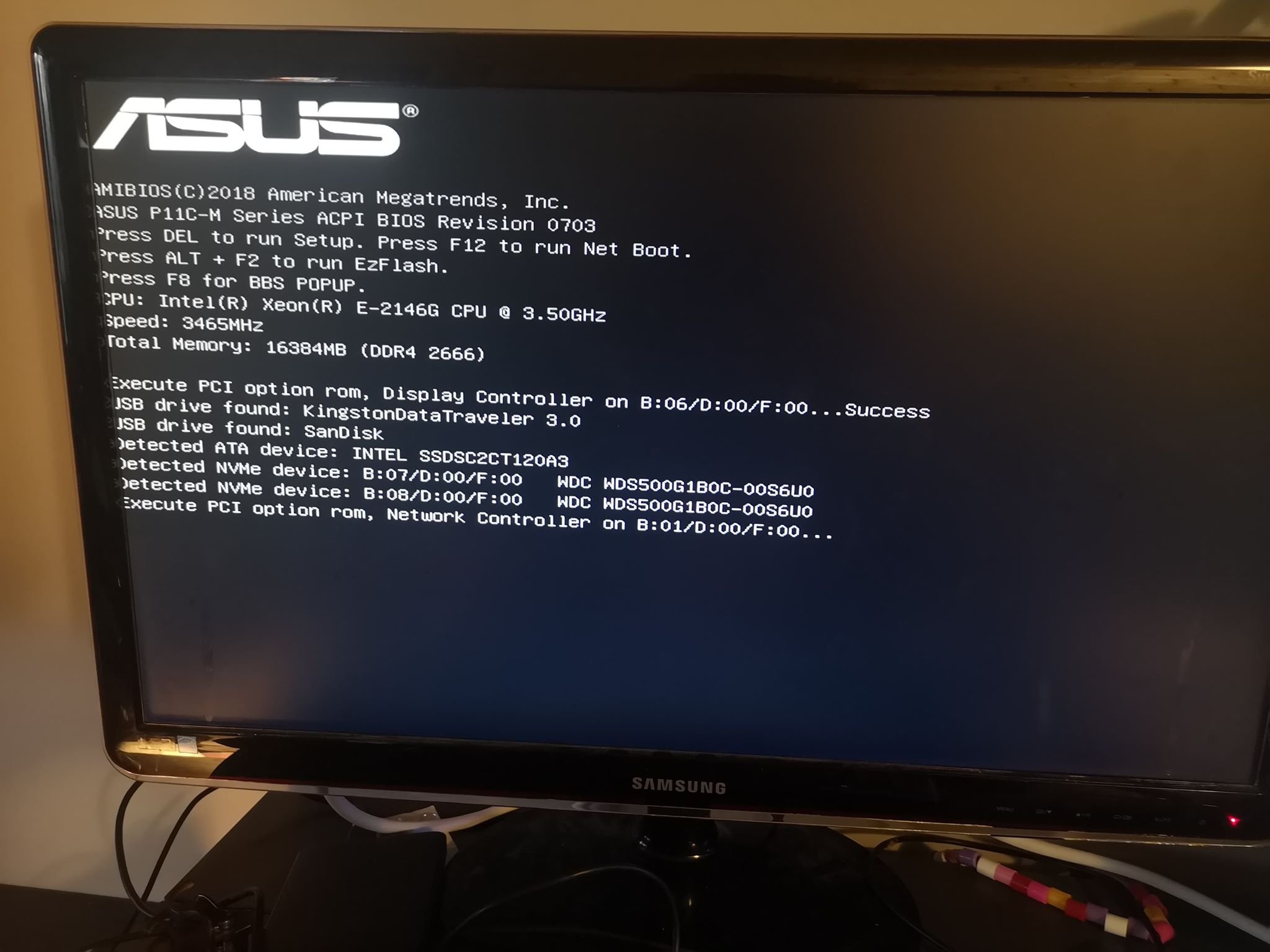

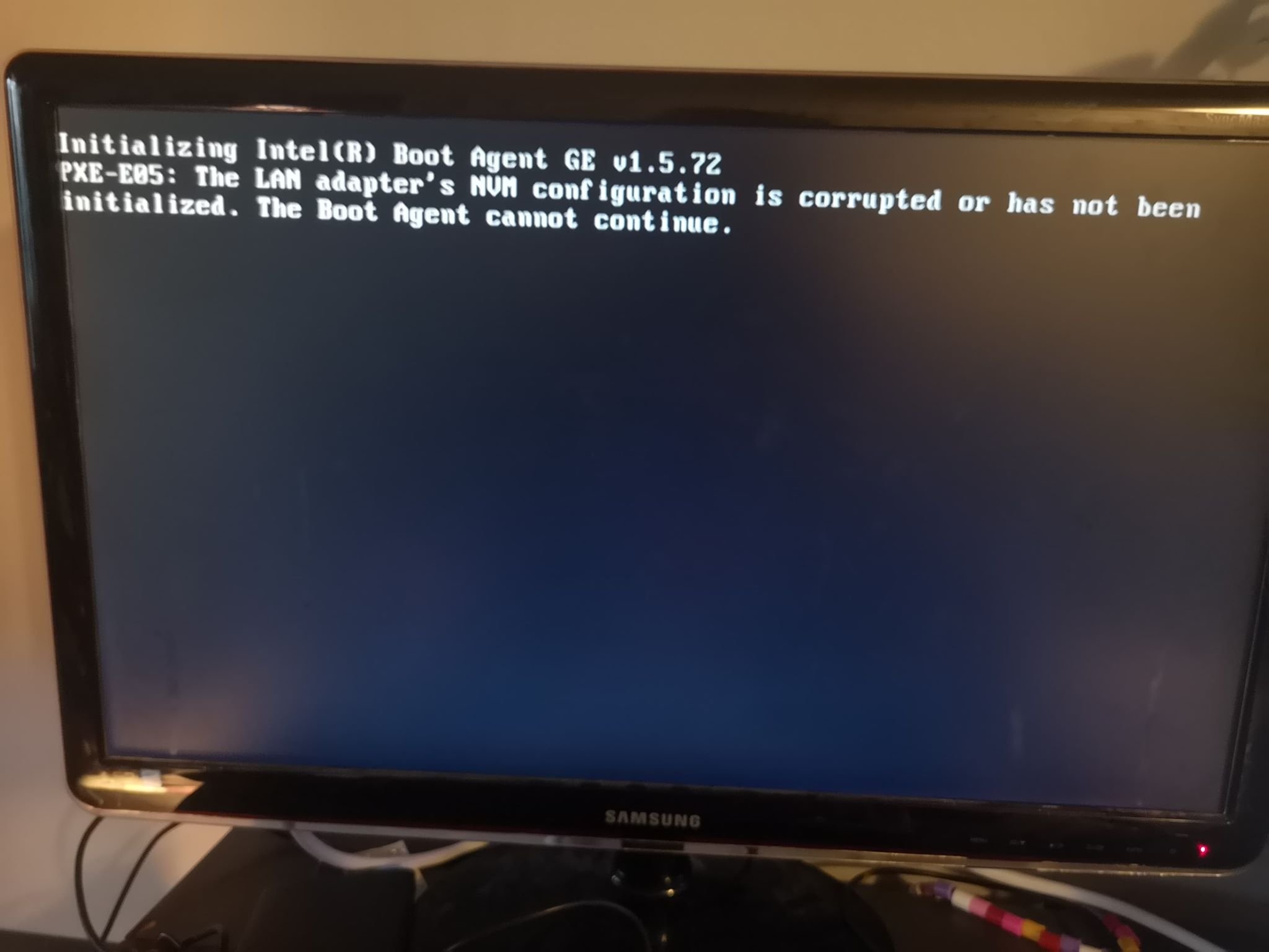

I having some issues in the boot with Intel Boot Agent that have been changed since i build the machine 2 weeks ago. Intel Boot Agent says PXE-05 NVM file is corrupted or have not been configuerd. What i remember this happend when i updated the BIOS and after that Unraid didnt give me an IP anymore, and since i had issues with UnRaid with stability i troubelshoot it and afteter many nights with that i decided to reinstall and start fresh, that didnt go well.
But Intel Boot Agent dont have ANYTHING with this to do right?
When i first build the machine in the boot, the CPU and memory etc showed up like it should, and after that there was a screen with text something like, Intel Boot Agent v1.5 etc etc and a / that spinned around and under that a quick text with Press CTRL + S to configure (It shown for like a sec) and then disaperd and then it booted up.
Is this just a coincidence that the Intel Boot Agent got corrupted and Unraid got more errors or does it have a connection with eachother? I have been in touch with ASUS Server support since it it a ASUS P11 server MB and they have said the MB is defective, but other OS works to get IP etc but not UnRaid.

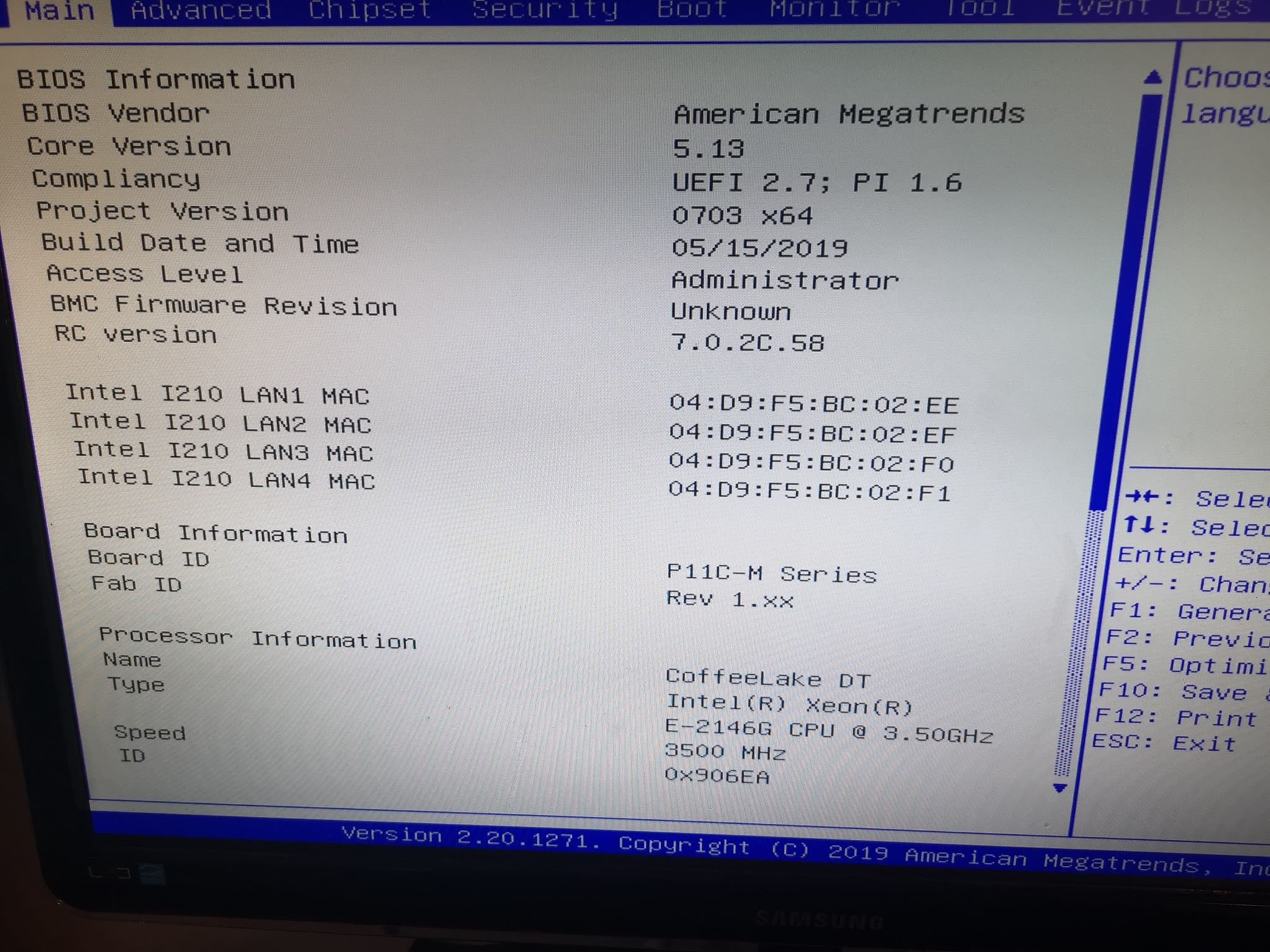

Post some pictures aswell so you can see what i get in the same time that i remember as unraid didnt get a ip anymore. I had many small problems and dont remember to 100 % what en when it all happend, what camed first and what camed second as problem. FreeNAS and Windows both works, not unraid. Re-created usb. changed usb port, set default settings in BIOS.
IT`S ALIVE!
I mixed with BIOS, plugged a cabel into all of the ports, recreated a usb, and started. It actully got an IP.
I have to be something with the new BIOS that was released yesterday, and after update, i didnt tryed UnRAID again, i started up FreeNAS cuz i was so tired of fighting with this. Today it all clear up! Iam a verry happy man once again.
