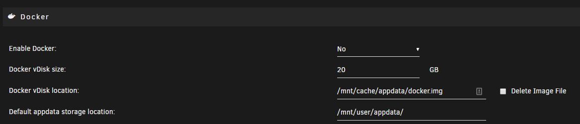

In the GUI go to Settings --> Docker and then disable Docker.  You can then delete and recreate the docker.img.
I have done what was suggested but still getting " Docker Service Failed to Start" . I have attached a new Log this should show from when I turned on my server to when I disabled docker service and deleted Image file.
I am still seeing the error message in my logs but I don't know what it means
Nov 20 07:18:38 Unraid kernel: BTRFS critical (device sdc1): corrupt node: root=7 block=787021824 slot=233, bad key order, current (18446744073709551606 128 28971700224) next (18446744073709551606 128 20387368960)
unraid-diagnostics-20191120-1419.zip
Cache filesystem is corrupt, backup any important data there and re-format, then recreate docker image.
