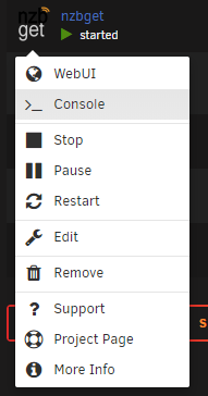

So im all set with unraid and it works great.
I just installed Nginx and I’m able to see the page etc. however I would like to test out react and especially Gatsby js.
I’m struggling to understand how I can do that without SSH. (as im not able to ssh into that docker container)
Can anyone explain it to me please?
