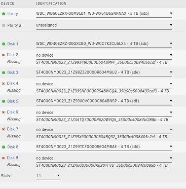

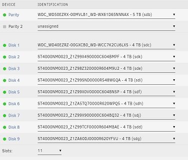

My new Unraid server never auto-starts - comes up 'Array stopped - stale configuration' each time.  After starting the array  manually, it runs perfectly.  So why doesn't the array doesn't auto-start ??
If I start the GUI while booting, 1-5 disks are missing ...
But all disks are found when the GUI is refreshed. Weird ...
syslog (diagnostics attached) shows all disks are commanded to spin-up and I hear them spooling in 4 groups.

The drives not ready in time have 'later' drive letters (sdh sdi sdj sdk). They're not on the end of the PSU cables.
