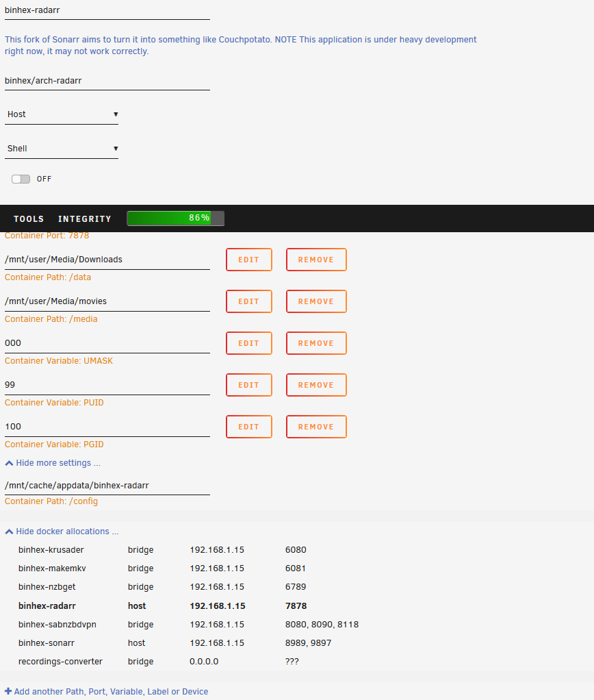

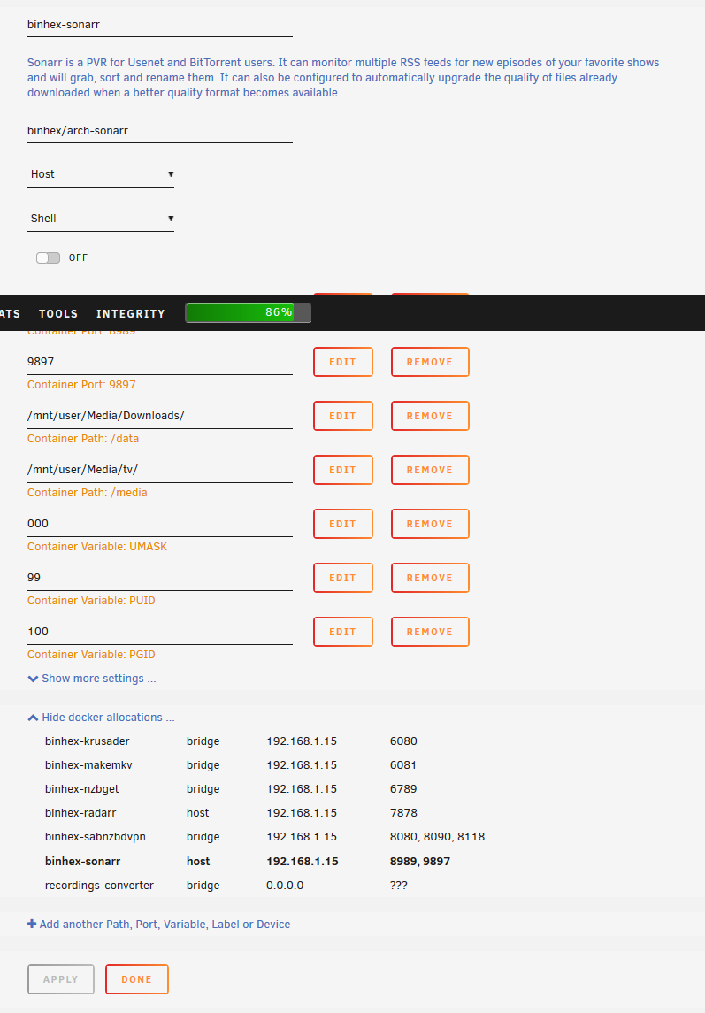

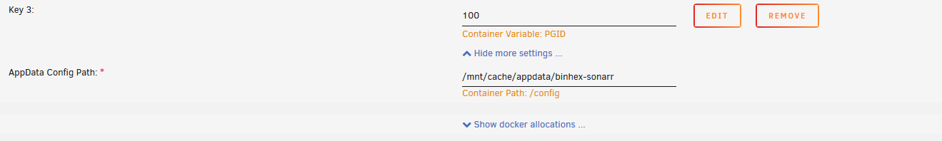

Can you click on show more settings for Sonarr
But, why are you running them both as network type Host.  They should be network type Bridge

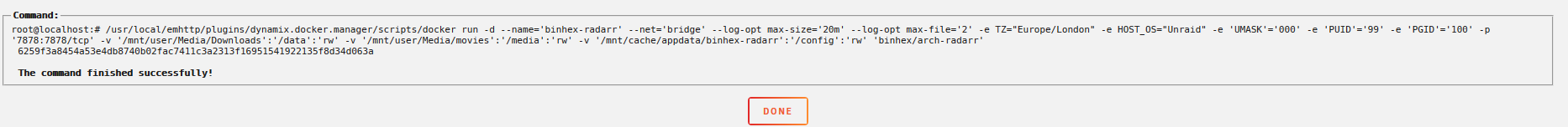

Extra sonaar
Wont run up as bridge for the same reason.

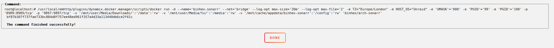

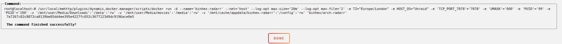

Switch it to bridge and the result is the same error message in the logs
2019-11-17 17:32:37,195 DEBG 'radarr' stdout output:
[Fatal] ConsoleApp: Address already in use. This can happen if another instance of Radarr is already running another application is using the same port (default: 7878) or the user has insufficient permissions
Attempts to connect
Firefox can’t establish a connection to the server at 192.168.1.15:7878
Edited by superloopy1

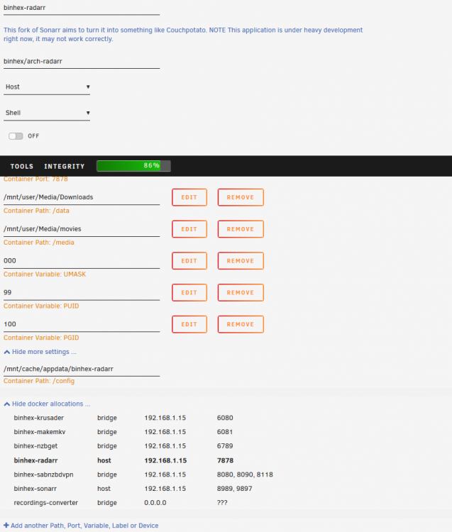

Switched back to host
Then over to bridge
With Radaar itself stopped and Sonaar switched to bridge the logs stil show the error message advising anothe instance running and unable to connect via webgui. Switch it back to host and all is available again
The template itself is messed up.  I would suggest making a note of your path mappings for each of them, then remove the apps.  Then from apps install them again (but NOT from previous apps) and add in the path mappings
