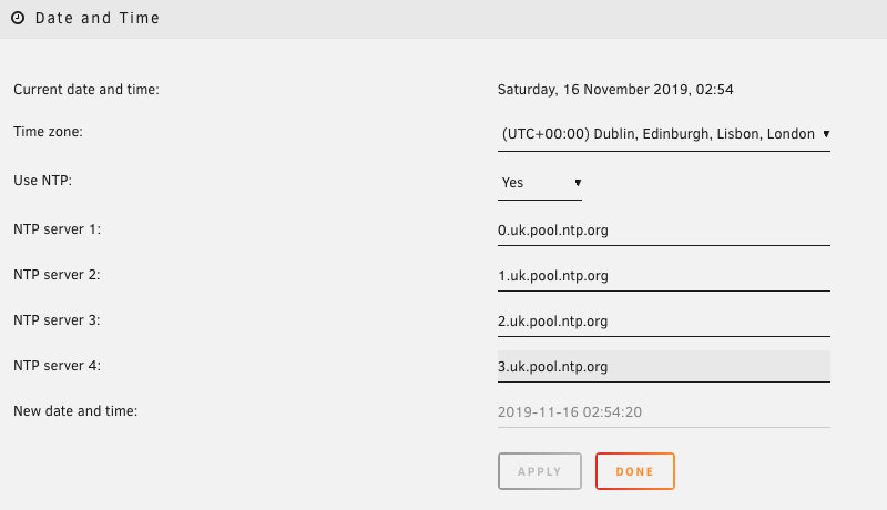

Your server should use ntp to synchronise to network time servers. Go to Settings -> Time and Date and check the settings there. You can turn on help for guidance but it should be fairly obvious what to set. Here's what mine looks like:
If the time hasn't synchronised after a few hours post your diagnostics.

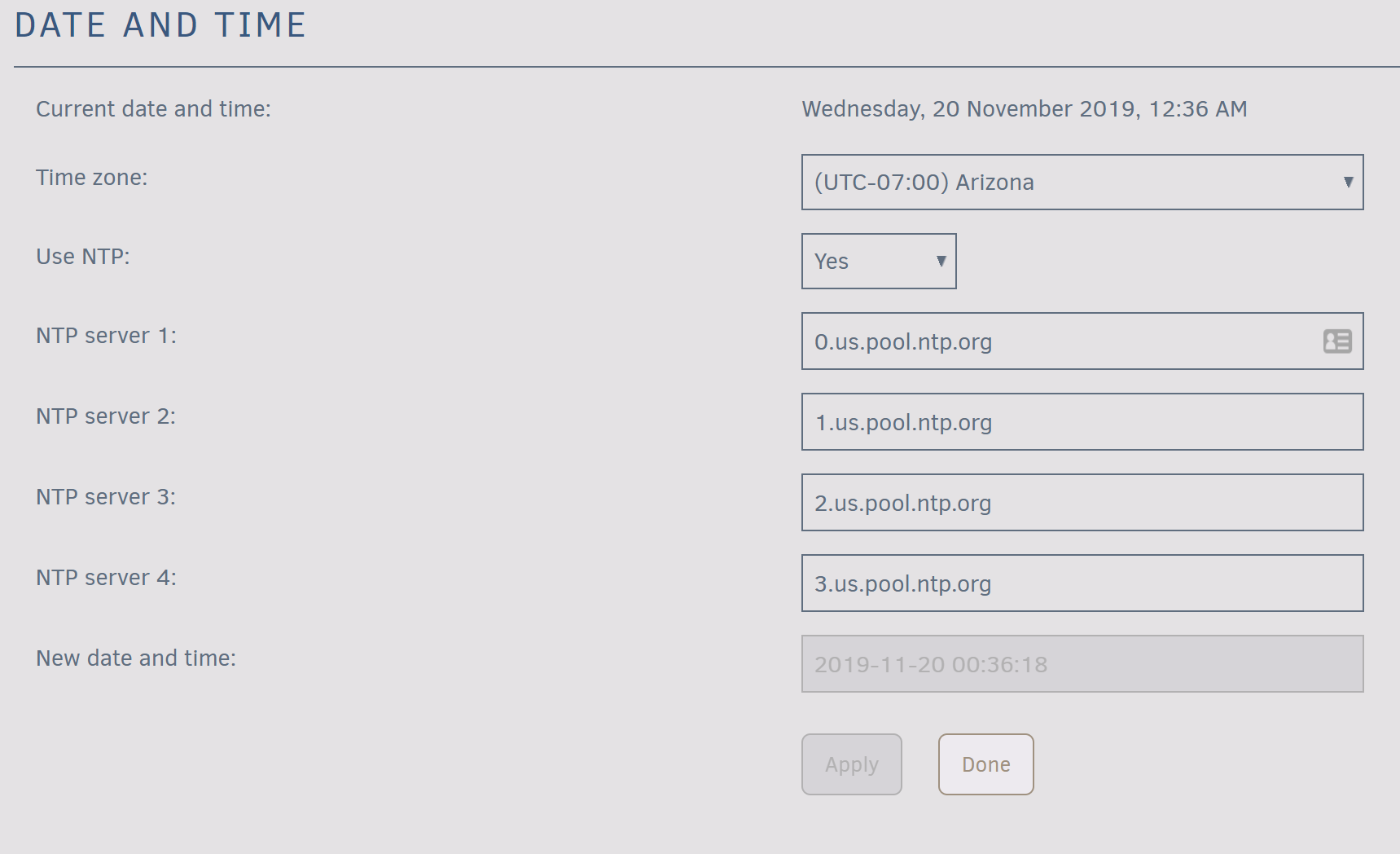

Thanks for the reply!!!  I appreciate your help.  I have also tried setting the NTP servers.  Here is what it looks like.  When I check it in a few hours, it will be WAY off again.  I have also attached the Diagnostics file you requested.  Thanks again for your help.

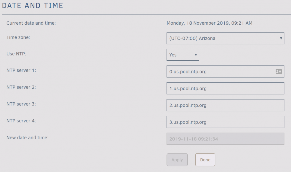

Thank you so much for your help.  To answer your question directly, I am not manually resetting the time via SSH.  I have reset it manually a bunch of times via settings in unraid because it was just wrong.  Actually I just logged in and my clock on my computer shows this...
Unraid shows this...
I had not touched it since I sent you the screen shot the other day.  I just reset the time in unraid.  When you switch "Use NTP: Yes" to "Use NTP: No," it does the manual reset you see in the logs.  After resetting the clock at about 6:52 AM and working on the system for a few minutes I noticed that it is already 5 minutes behind.  I am attaching another diag file too.
