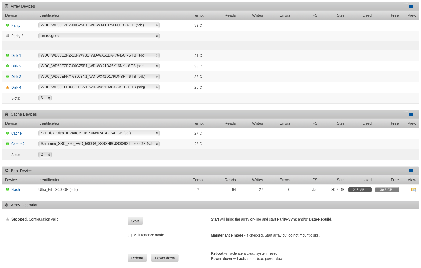

If you start the array I assume it will begin rebuilding disk4 again. Post a screenshot of Main - Array Operations.
Here's the whole page ..
Thanks!

13 hours ago, Baph0metal said:
replace Disk 2 that the SMART checks deem as faulty?
I didn't even check disk2 SMART since disk1 is also failing, so you have two failing disks and one invalid disk, I would try using ddrescue on disks 1 and 2 and copying everything you can from disk4.
