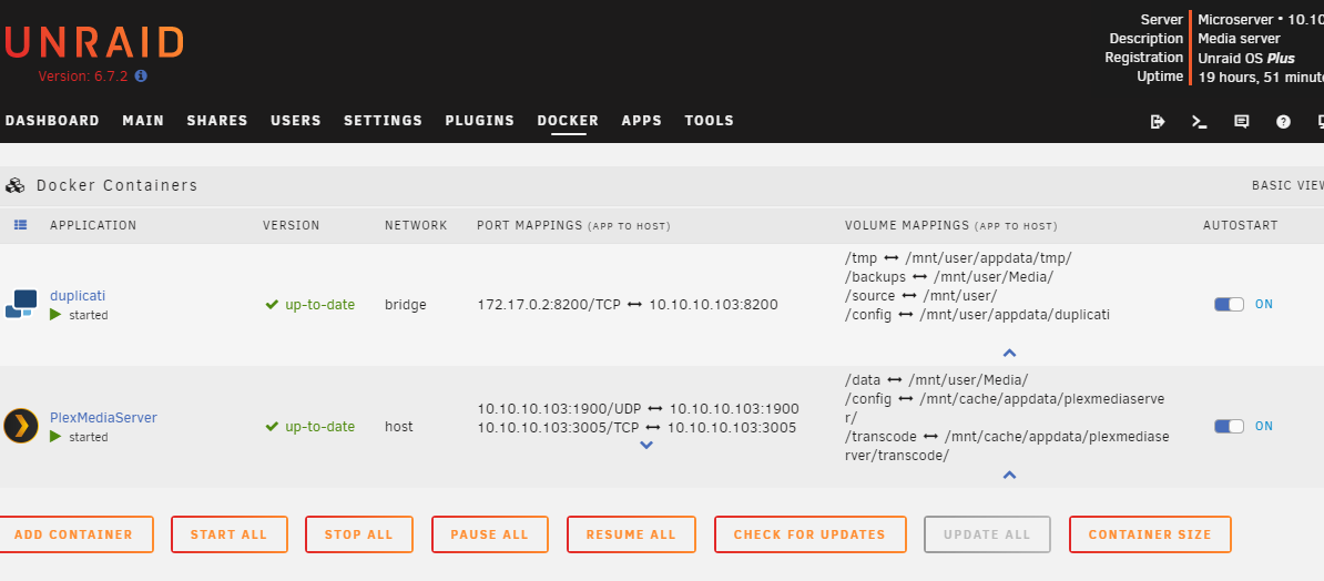

Something is filling rootfs, probably the cause of your upgrade problem also. What dockers do you have?
I have duplicati and PlexMediaSever and mapped to user and cache drives (see screenshot attached).

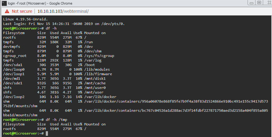

I also did "df -h" and currently have 275M free on rootfs (screesshot 2)
Yes, that df is what I was looking at in diagnostics, but I see I was fooled by the fact that it was 67% used because you have so little RAM.
Can you add more memory? I don't recommend trying to run dockers without at least 4G, and more is better.
Your little RAM is the reason you had to upgrade manually, and is possibly the reason your email is failing. You could try disabling the docker service, reboot, then see if the email will work.

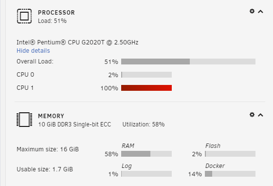

Yeah I actually have 10gig of RAM but only showing 1.7 usable? (see screenshot).  Maybe my RAM went bad? I tried disabling docker and still cannot send any email out.
EDIT:
Added Output of "dmidecode -t 17" I have 2 GIG and and 8 GIG RAM.
It looks like Unraid is only using the 2 GIG RAM. When I get home I will try to swap out the RAM into different slots and see.
