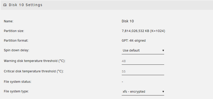

It happened again, and this time i had logging on. It happens whenever i try to format a new drive in RC5, i never had issues formating new drives in the stable version so i guess this may have gone missed in the RC?
Here's the logs from when unraid sends the preclear finished message:

Nov 18 07:19:12 NAS emhttpd: req (17): startState=STARTED&file=&cmdFormat=Format&unmountable_mask=6144&confirmFormat=OFF&optionCorrect=correct&csrf_token=****************
Nov 18 07:19:14 NAS kernel: mdcmd (152): nocheck pause
Nov 18 07:19:15 NAS emhttpd: writing GPT on disk (sdf), with partition 1 byte offset 32K, erased: 0

Nov 18 07:19:17 NAS emhttpd: shcmd (2432): /usr/sbin/cryptsetup luksFormat /dev/md11 --key-file=-
Nov 18 07:19:17 NAS kernel: BUG: kernel NULL pointer dereference, address: 0000000000000000

Disk 10 is already xfs encrypted
Disk 11 and 12 are still "auto" because they were never formated, i have not yet mounted the array since the last hard reset.
